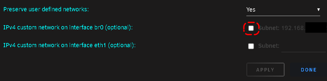

  1. Apparently, it was an issue with a Docker setting. The "IPv4 custom network on interface br0 (optional):" option was checked by default when the Unraid upgrade was installed. Unchecking this allowed the docker containers to work as expected.
