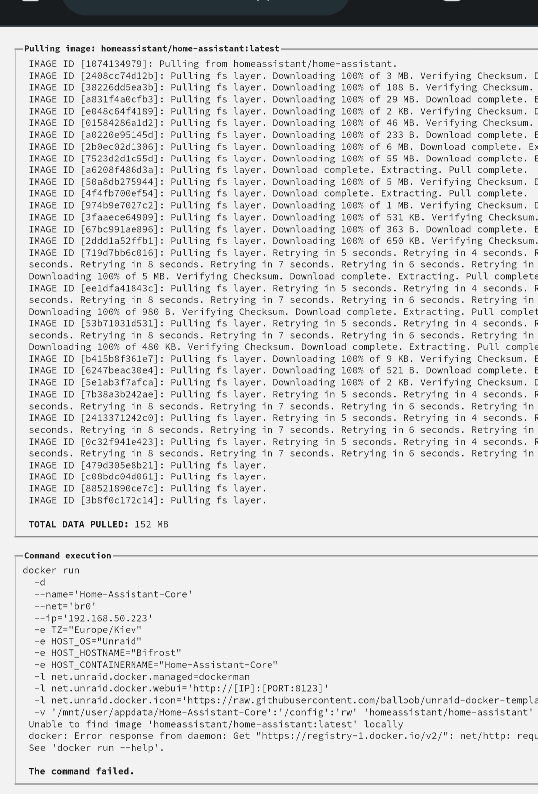

  7. Tried this but did not solve the issue. I figured it might be some weird connectivity problem caused by PiHole. Stopped the PiHole container and tried to install HA again, but no luck. I tried few other times and actually managed it to start the download (see screenshot), but the process still fails at the end. Ones I even got the container visible in docker management but trying to start it caused an error. Overall the whole process seems weirdly slow.
