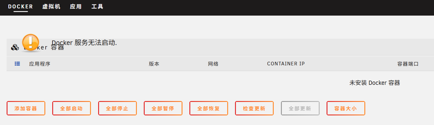

  2. 错误如图,docker的所有应用都在运行,但是docker管理界面无法显示,估计是docker服务连接不上,我不知道如何解决。求救

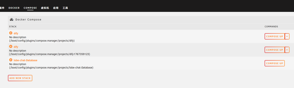

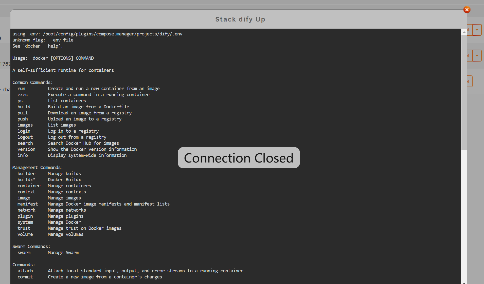

  3. 各位大佬:请教docker compose的使用。 我第一次使用docker compose 插件安装,我将docker-compose.yml文件内容插入保存后,控制台出现奇怪的报错,一个是 unknown shorthand flag: 'f' in -f See 'docker --help'. 我看了代码也没有-f参数啊?试了其他compose 的安装也都是这个错误,到目前docker compose插件也没用成功过。 只能到论坛求助,求各位大佬指点迷津

  7. thanks Aug 26 03:08:30 zbunraid root: ttyd -R -o -i '/var/tmp/compose_manager_action.sock' '/usr/local/emhttp/plugins/compose.manager/scripts/compose.sh' '-cup' '-plobe_chat_database' '-f/boot/config/plugins/compose.manager/projects/lobe-chat-Database/docker-compose.yml' '-f/boot/config/plugins/compose.manager/projects/lobe-chat-Database/docker-compose.override.yml' '-e/mnt/user/appdata/lobe-chat-database/lobe-chat.env' '--debug' > /dev/null & Aug 26 03:08:30 zbunraid root: '/usr/local/emhttp/plugins/compose.manager/scripts/compose.sh' '-cup' '-plobe_chat_database' '-f/boot/config/plugins/compose.manager/projects/lobe-chat-Database/docker-compose.yml' '-f/boot/config/plugins/compose.manager/projects/lobe-chat-Database/docker-compose.override.yml' '-e/mnt/user/appdata/lobe-chat-database/lobe-chat.env' '--debug' Aug 26 03:08:30 zbunraid root: /plugins/compose.manager/php/show_ttyd.php Aug 26 03:08:32 zbunraid root: docker compose --env-file /mnt/user/appdata/lobe-chat-database/lobe-chat.env -f '/boot/config/plugins/compose.manager/projects/lobe-chat-Database/docker-compose.yml' -f '/boot/config/plugins/compose.manager/projects/lobe-chat-Database/docker-compose.override.yml' -p lobe_chat_database up -d
  8. I just used the docker-compose-manager plugin and I tried to build one, but it reported an error. unknown shorthand flag: 'f' in -f See 'docker --help'. Usage: docker [OPTIONS] COMMAND I don't know what's wrong with it. Can any of you help me out? 新建 BMP 图像.bmp

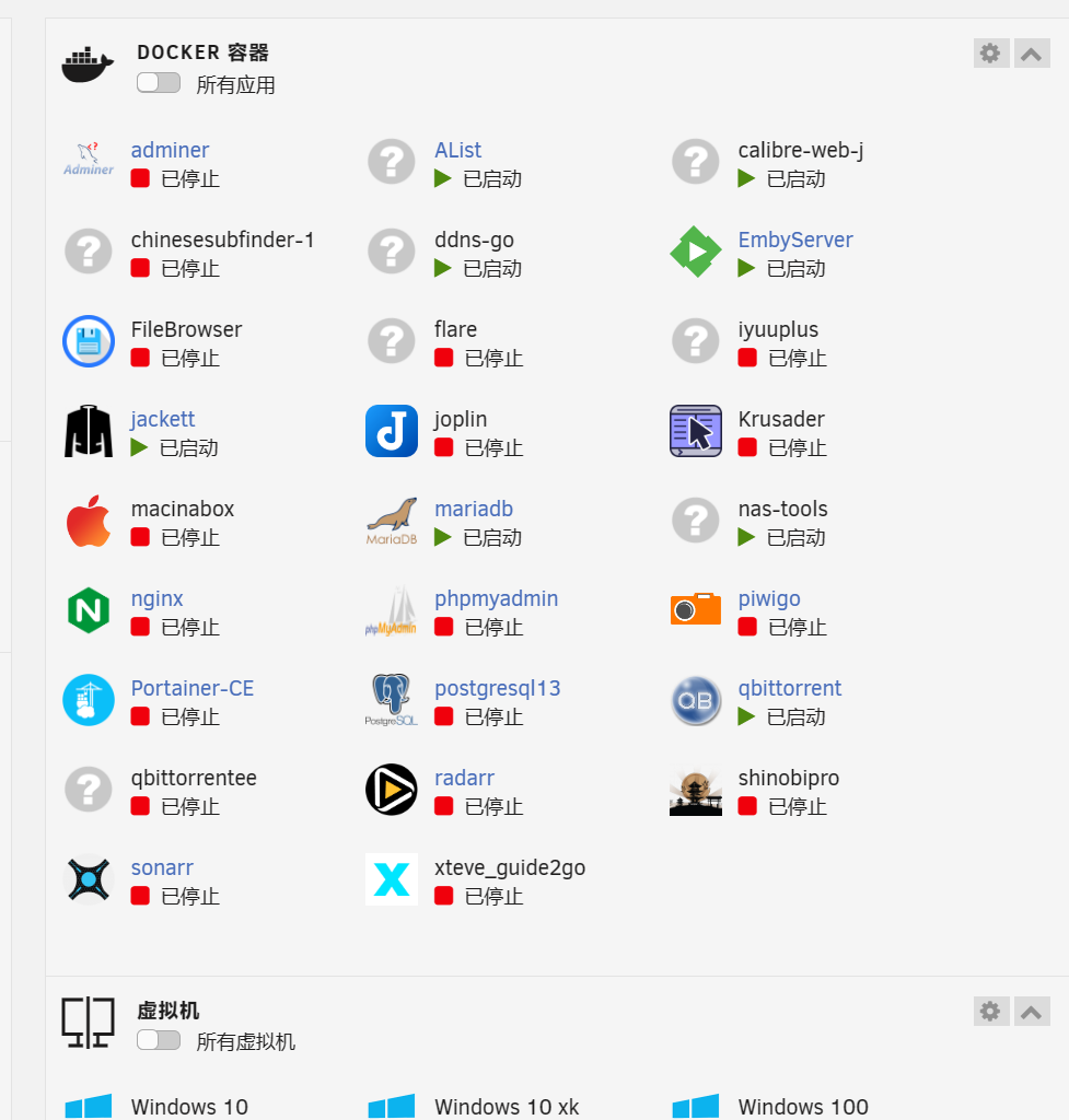

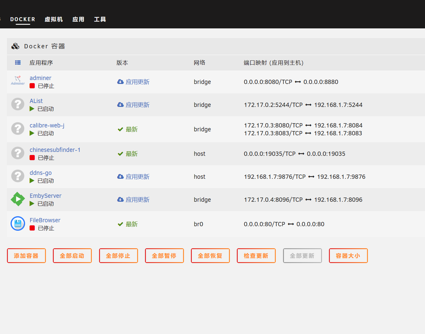

  9. 求教:docker容器 管理页突然只显示A-F开始的docker了,而仪表盘上的显示是完整的。如何解决?
