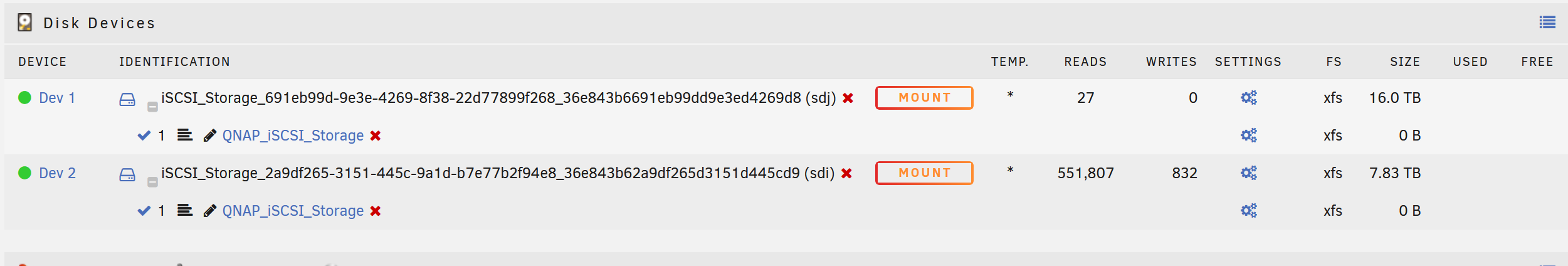

  2. Ugh i'm an idiot... thanks I didn't notice this before bc you couldn't click it when it was marked "REBOOT" and when mounted it linked to the file manager.

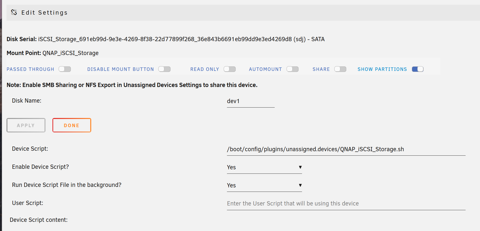

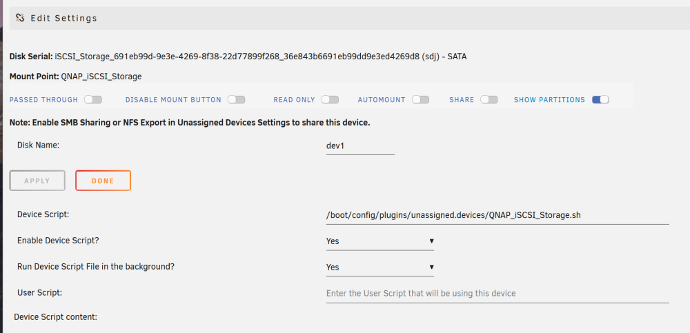

  3. I never specified a mount point for either - I never saw the option. When I look at the details for the two targets I see a mount point specified but there's no option to change it: I feel like I missed a step somewhere. The iSCSI Initator plugin doesn't have any options aside from connection info for the target.

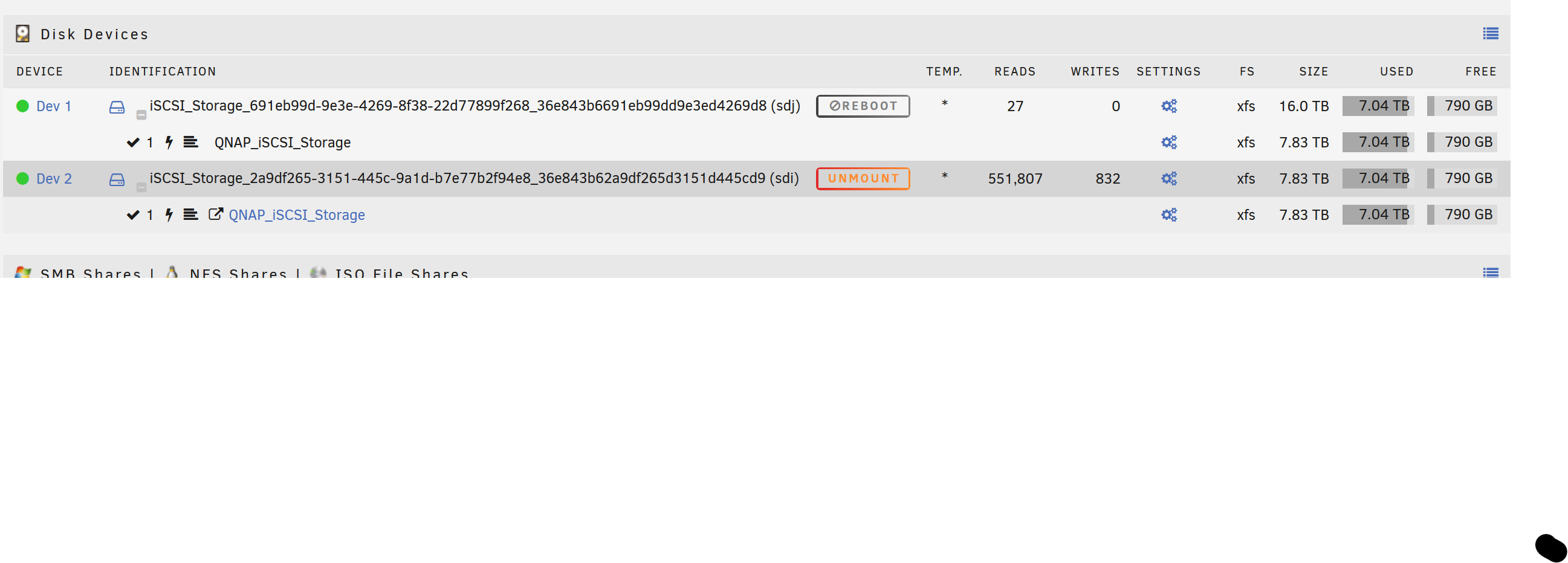

  4. Attached - if more is needed I can enable debug logging and reboot to get a clean slate. I am not sure why the wrong information is shown in the screenshot below: tower-diagnostics-20231210-0016.zip
  5. I have two iscsi targets on a remote machine. I can mount one of them but the other has always had the REBOOT button where MOUNT should be. How do I fix this?
