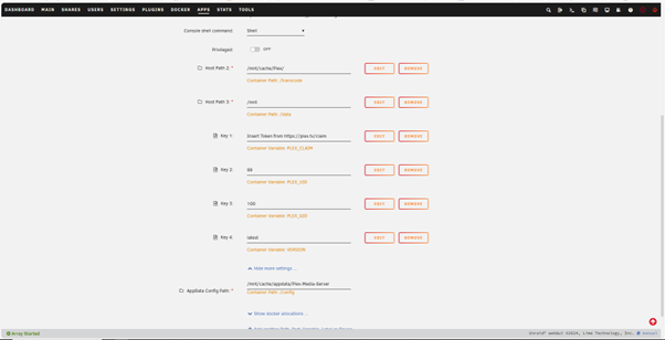

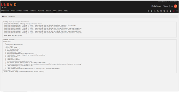

  6. Folks, need help.... At the beginning of last week (w/c Mon 10 Nov) i noticed Plex had hung. I dont recall the circumstances i'm afraid. But i came to the conclusion it was knackered. By Thurs 13 Nov, i had decided to un-install the app, and re-install. I did that, and after installing, i had to point Plex at my media libraries. Plex spent several days scanning vast music & video libraries. It finally came to a halt, but the GUI showed many categories, on the left side. I had x6 'Film' categories. So i tried to delete some of them. I must have ended up in another mess, and decided to uninstall & re-install another time. Now.....i've got a real problem. I cant get Plex to install at all. Please see screenshots attached. I download the official Plex app, setup my config (/config, /transcode and /data). Once i kick that off, Plex tries downloading some files. The last one RARELY downloads fully. But sometimes it does download fully. I did some forum research. Someone mentioned deleting docker image. So i deleted docker.img. I left Plex for x18 hrs doing this install. But i find it hung, again. Another observation, when Plex is downloading the files, the GUI hangs solid. So when i reckon its hung, i have to re-boot UnRaid, to get a working GUI. I'm in a real mess here. Can someone help ?? Happy to publish whatever files you need. Richard
