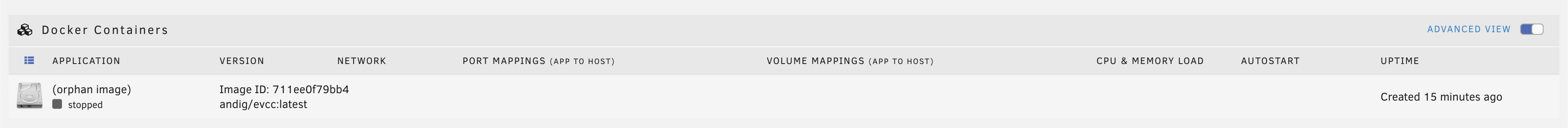

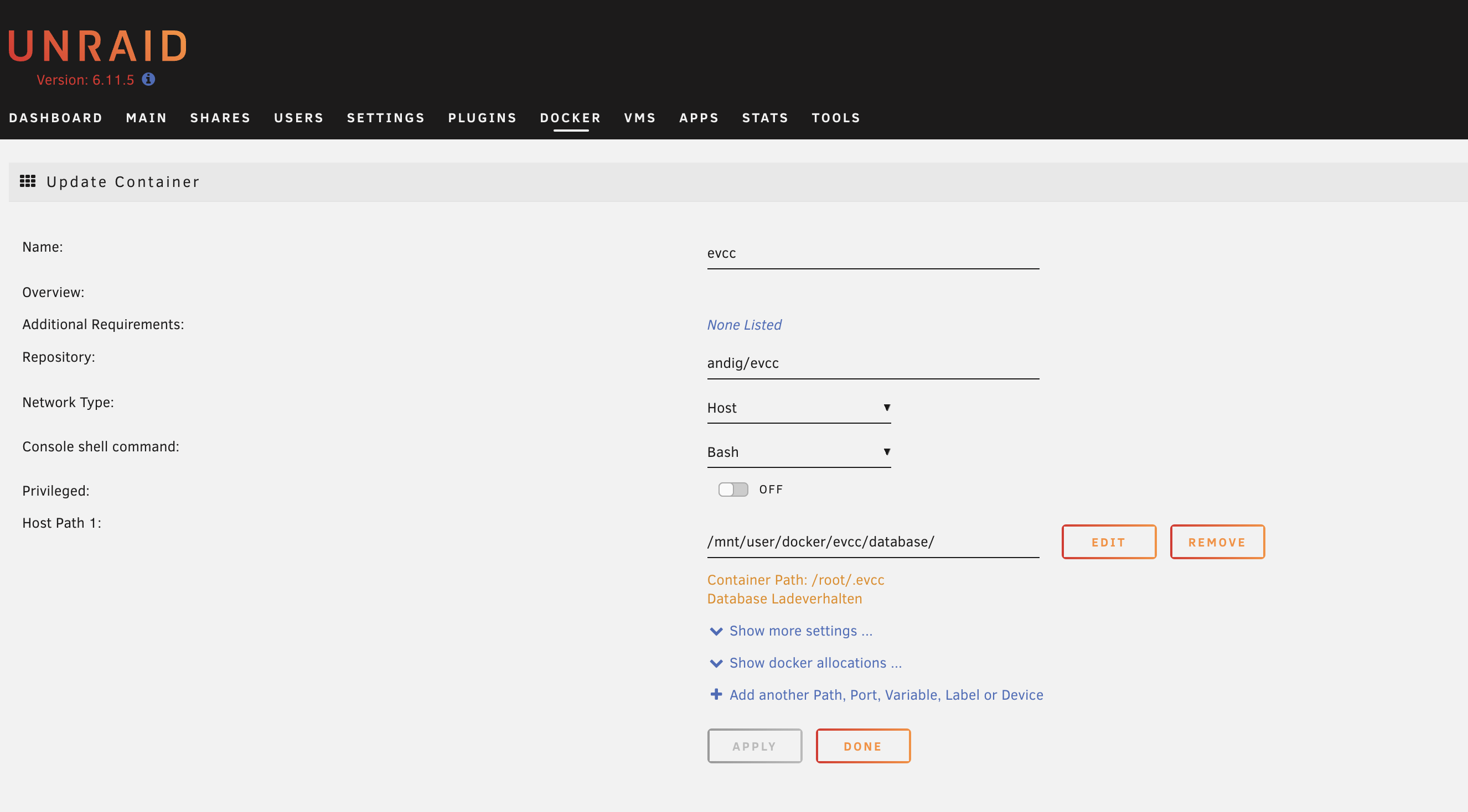

  13. okay with this tipp i found the fail i create a new Docker with costum settings and it work. Thanks
