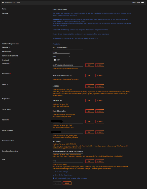

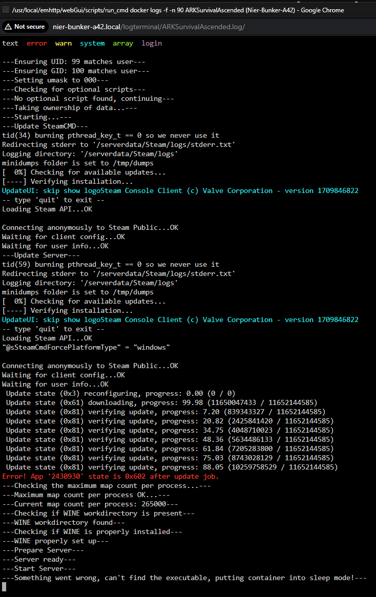

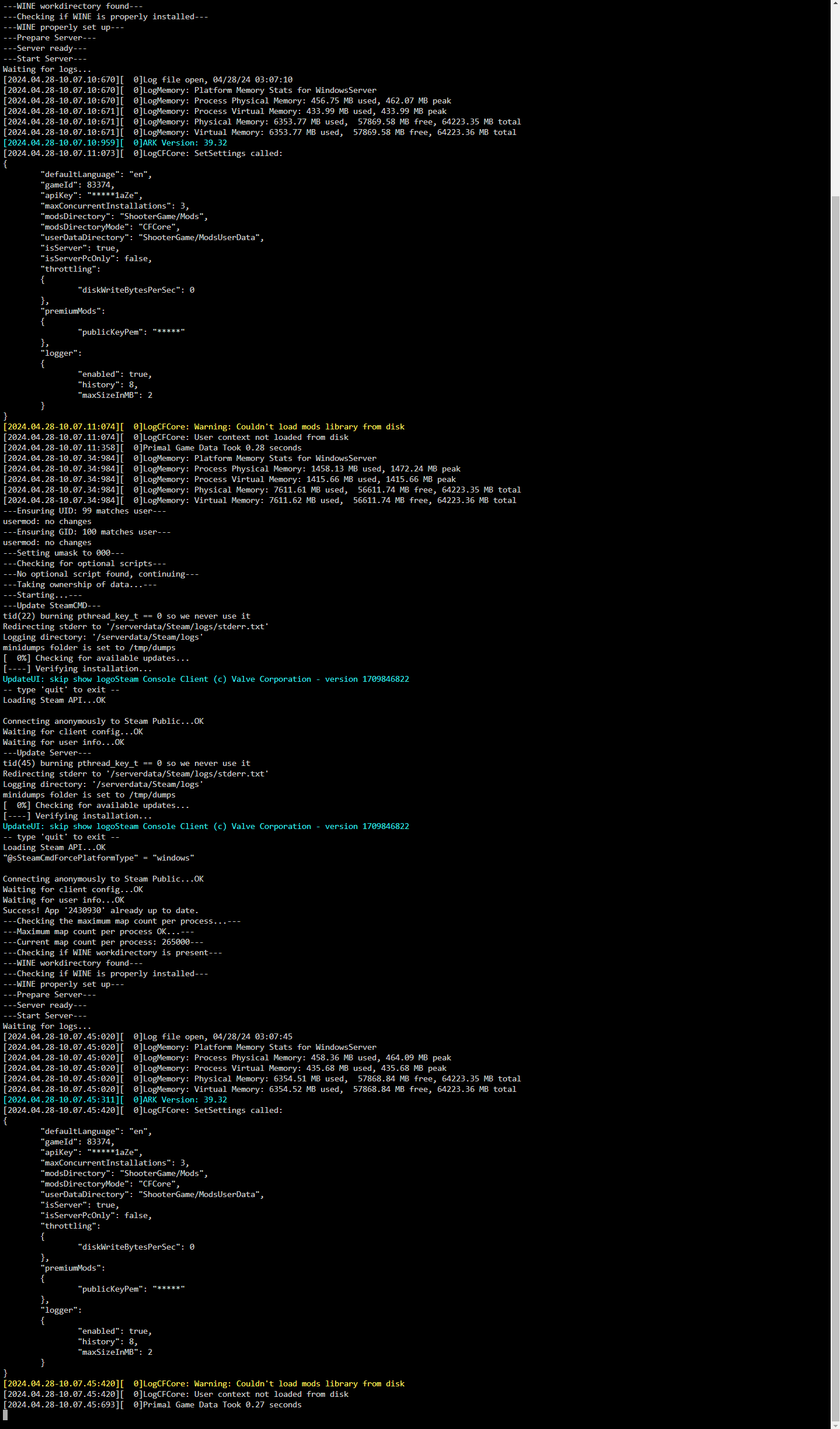

  6. Having issues with Ark Survival Ascended keeps restarting. Below is the last I see in the logs before it crashes and restarts. I have done a couple uninstalls and reinstalls and it now comes up with a dreaded 0x602 error (also below). Has anyone found out the problem and possible fixes?
