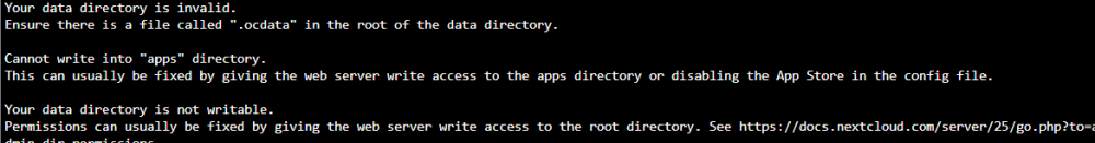

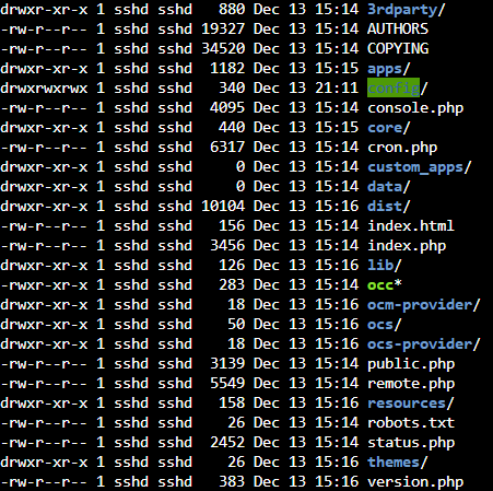

  1. uhm wait. I tried it like tat and looks like it's working docker exec -u root nextcloud chown -R 33:33 * But I can't access the website
  2. hmmm well: Di I have to edit my data dir too ?
  3. right now it is nobody users Should I: chown -R user:33 ?
  4. I'm having a permission problem. In the logs of nextcloud-cronjob I get this feedback Cannot write into "config" directory! This can usually be fixed by giving the web server write access to the config directory. But, if you prefer to keep config.php file read only, set the option "config_is_read_only" to true in it. See https://docs.nextcloud.com/server/25/go.php?to=admin-config Can someone guide me here ?
