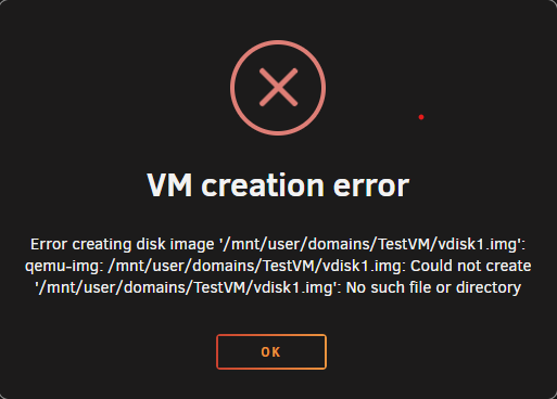

  2. Hi team! Hoping you can assist. Since updating to 6.12.10 (I also took the step to 6.12.9 briefly) my system appears to have issues creating new files / folders, identified when I went to create a new VM today. I assumed it was a permission issue and tried running the safe new perms function, but this did not resolve it. I also tried creating a folder in multiple shares via the Krusader docker, which also did not work. Any ideas? I'm no expert, so appreciate any thoughts / suggestions! Diagnostics & syslog files attached! tower-diagnostics-20240415-1123.zip tower-syslog-20240415-0203.zip

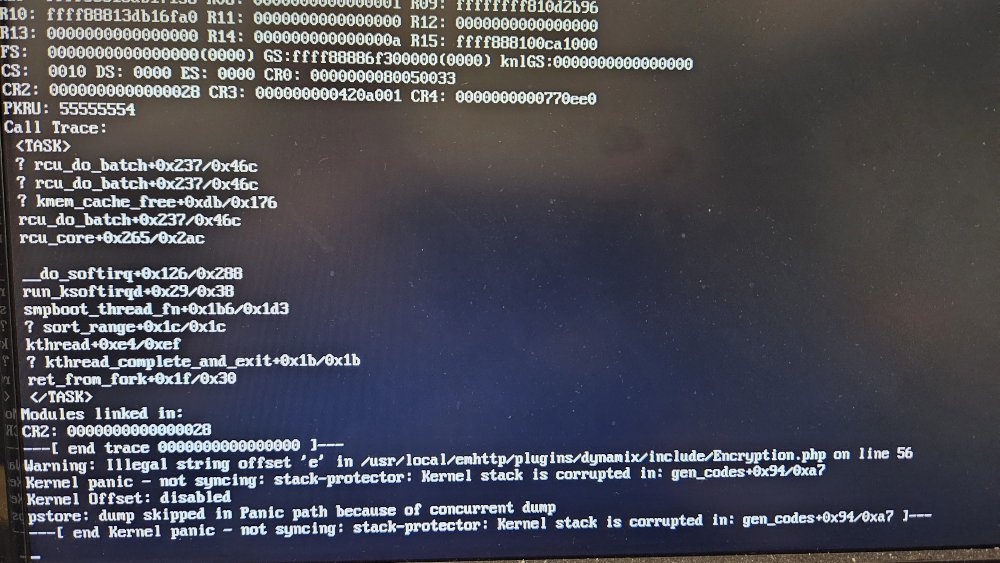

  3. In terms of closing out this support thread, I can now update with resolution. Again, thank you all for the assistance with troubleshooting. I ended up going through a motherboard RMA, with it being replaced like for like despite no fault with the board being found. However this did not resolve the issue. I then went through a CPU RMA on the i7-13700k, with it being found faulty. Once replaced, everything was back up and running fine! Very glad to have my Unraid machine back...as it took close to 6 months to resolve! CPU was the culprit...no idea how it became faulty after 6 months of solid operation...But fingers crossed I don't experience something like that again! 😀

  5. Hmmmm.... Considering I tried booting it with simply the motherboard, RAM & CPU installed I guess that points at motherboard or CPU, considering the memory test results. I'll have to look into how to best troubleshoot from here! Unfortunately I don't have another CPU that's compatible that I could swap in.
  6. Thanks for the suggestion. I have just finished running memtest86 with no errors. Any suggestions on what I should test next?

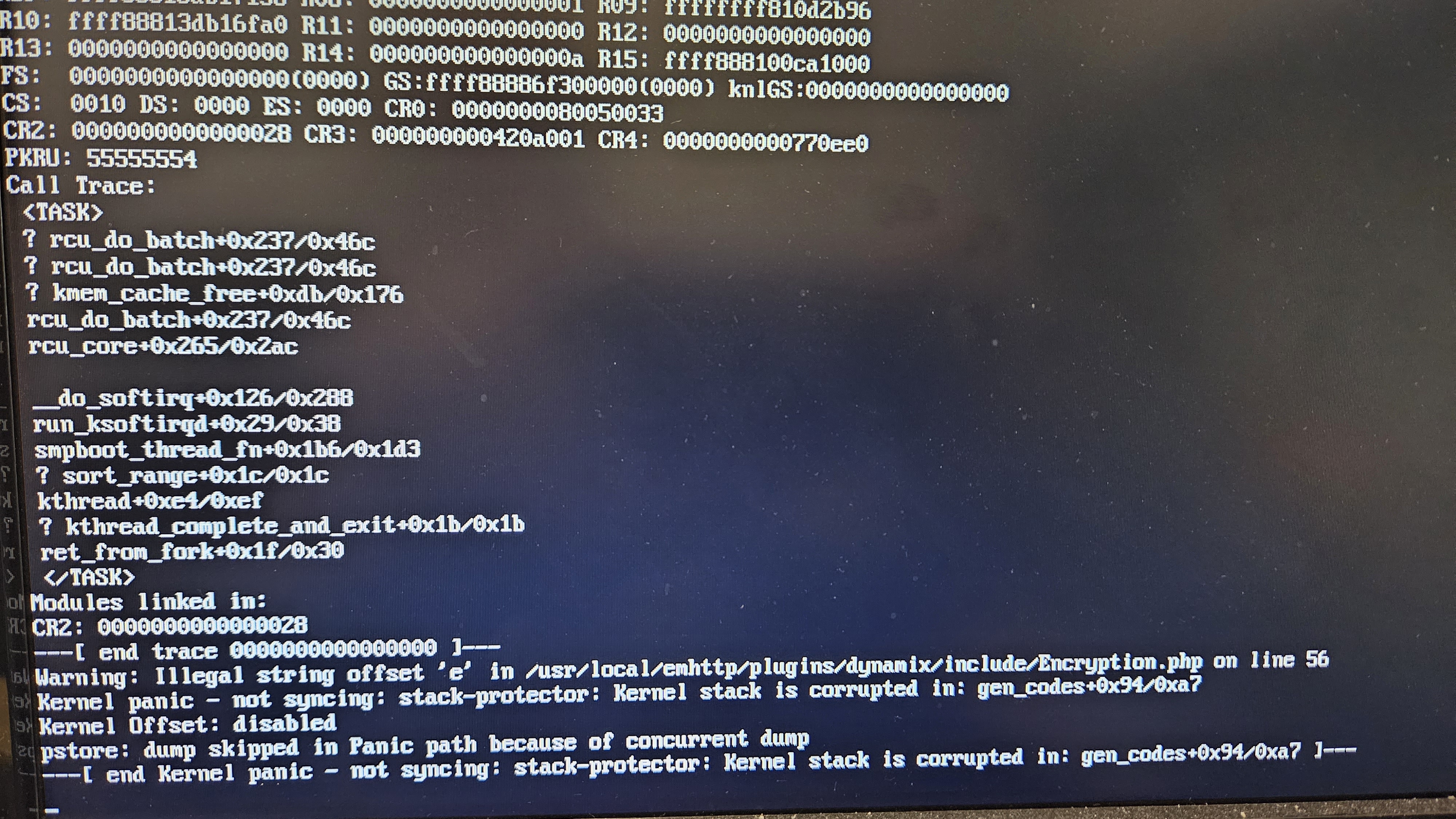

  7. Further troubleshooting based on researching the error messages, all with the same result: Tried another new USB flash disk with a fresh install of Unraid (no config at all from existing system). Tried removing 1 stick of memory. Tried removing GPU. Tried removing HBA card. Tried removing all SATA drives. Image of the error I'm getting is attached.
