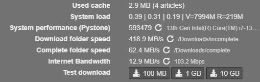

Since recreating the dockers using the previous templates and starting them up, I've noticed that SABNZBD is not achieving even half the speed it was previously.  I have a 1000mbps connection which SABNZBD would normally saturate (100 MB/s) and as I type this it is hovering around 13 MB/s.
I need some help trying to diagnose the speed issue as I am not sure how to proceed.  I was suspecting it was not writing to the cache drive, but that doesn't appear to be the case and I am not sure how to best further diagnose. What else can I check or look into?

Below is a screenshot of the SABNZBD speed test results. For some reason it lists the internet bandwidth as 12.9MB/S, which reflects the speeds I'm currently getting.

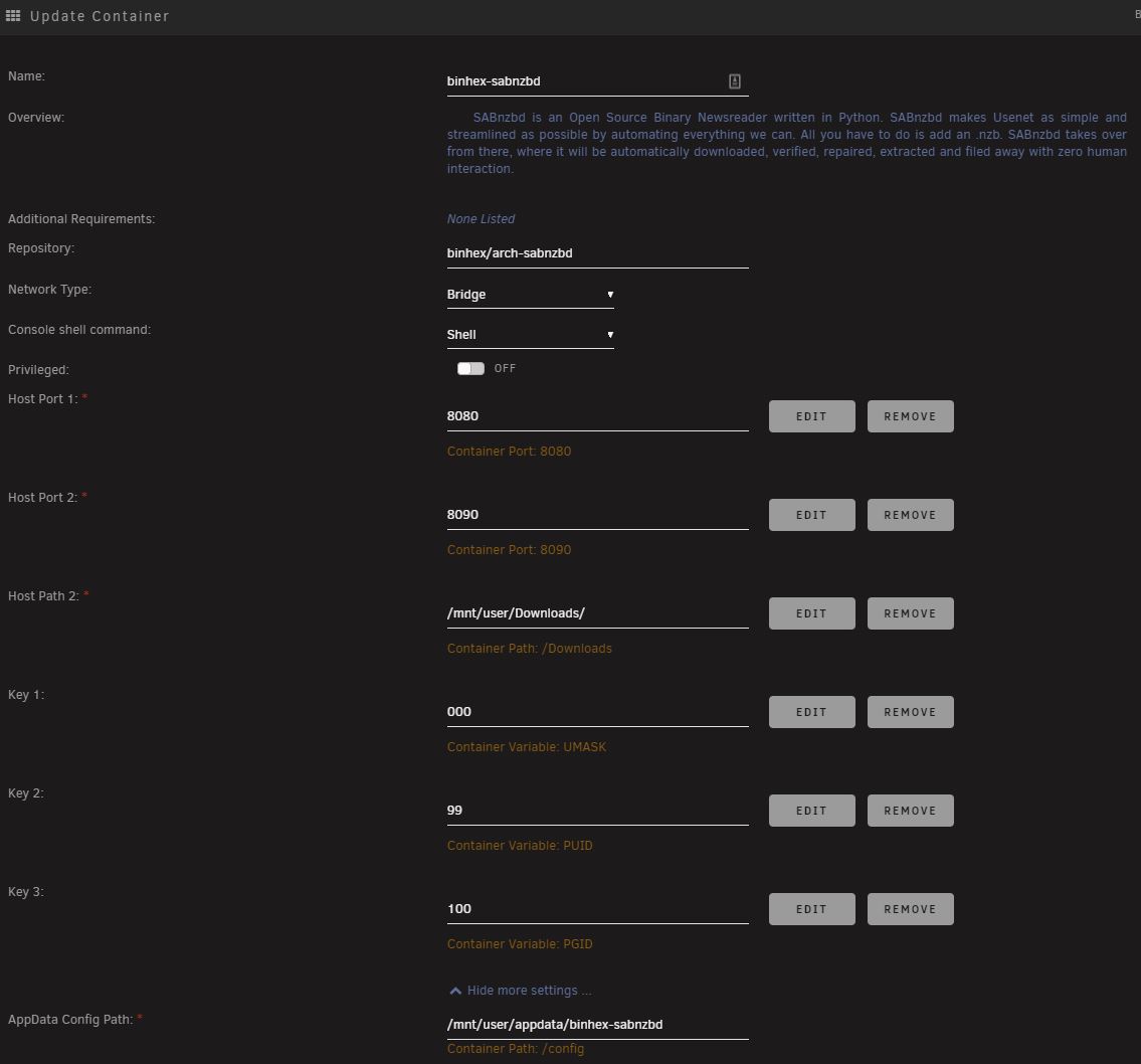

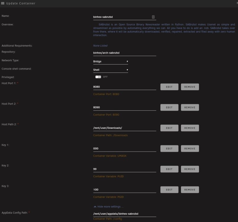

Below is the config of the docker container.

I can only think that there is something wrong in my configuration resulting in the docker using the array for downloads and not the NVMe disk.
Try mapping to /mnt/cache/downloads, fuse will always have some extra overhead.

Ok, thanks for both the suggestions.
The downloads are all going to the share Downloads.  As you pointed out Squid, I had some data on disk 7.  So I moved all of it onto the cache and restarted SABNZBD.  Unfortunately no speed improvement.
I also remapped from /mnt/user/Downloads to /mnt/cache/Downloads.  Also unfortunately with no significant improvement in speed.
I'm really scratching my head as this should ensure it is going straight to the new NVMe cache.  Is it possible that Unraid isn't able to properly utilise the read-write speed of the new drive? Something hardware based / driver based?
