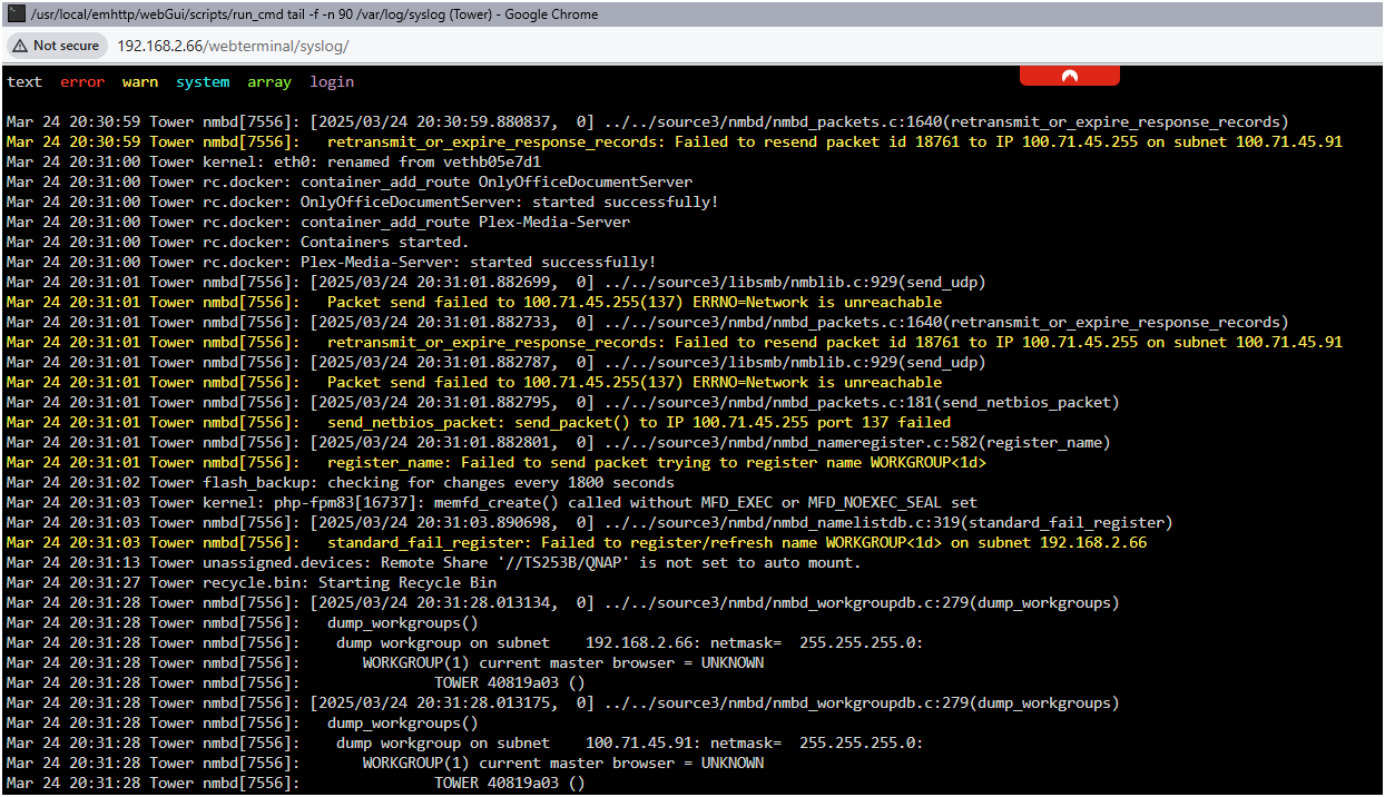

  2. Hi, I am running into a weird issue. Basically, out of nowhere my Unraid seems to be completely inaccessible from anything that is not Windows. I used to be able to connect to my shares via android apps like Cx File Explorer but now it does not work whatsoever. I also used to have my Unraid shares mapped to my QNAP Nas via HybridMount app which basically enables mapping network shares on the QNAP and now I cannot access my Unraid at all. I am for sure I have my credentials right. Also, if I choose "anonymous" for my credentials on android or QNAP I can see my shares but of course I don’t' have proper permission/access. I have Enable NetBIOS set to Yes and I have Enable WSD set to Yes. My diagnostics area attached as well as shot of my sys log when my Unraid server boots up - I am seeing some issues here but not sure how to address/correct. tower-diagnostics-20250325-1014.zip

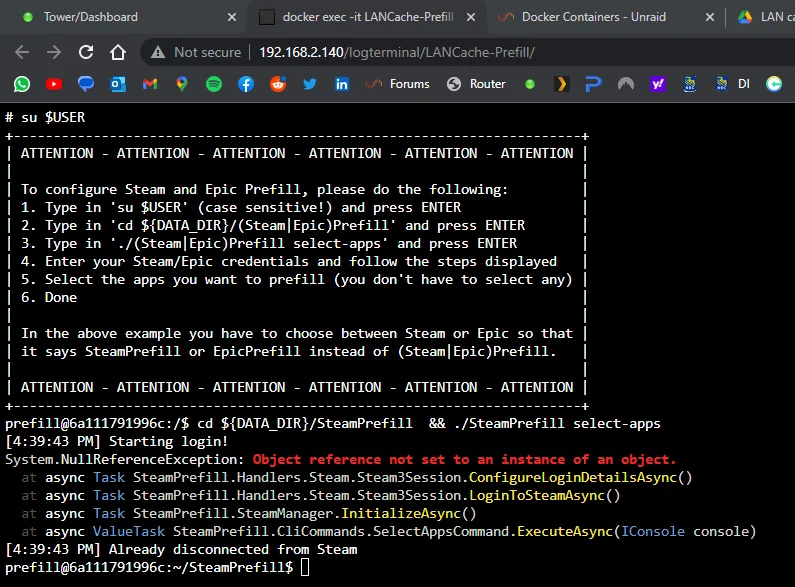

  11. I was able to setup lancache and lancache prefill. I logged into my steam account on the lancache prefill docker and I was able to successfully test downloading a game on the prefill. I want to log into the prefill again and select additional games but I can't access it anymore. Does anyone know why? I get an error of System.NullReferenceException: Object reference not set to an instance of an object. I was able to login before but for some reason I can't login anymore to select more apps/game to download. I tried to restart the my server, lancache, lancache dns and the prefiill containers and that didn't help. Any input appriciated. I log into console on the prefill docker and then i get an error.

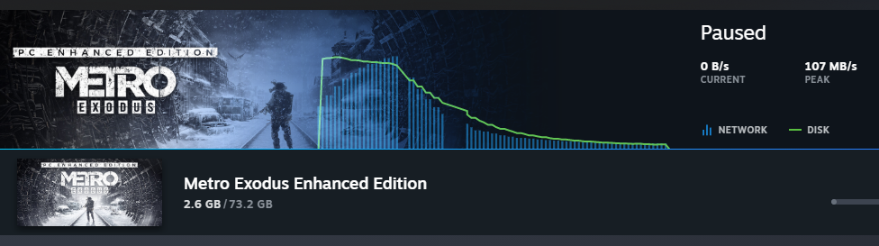

  12. I followed this tutorial for installing the lancache, dns and pre-fill containers and was able to install successfully but the speeds on steam drop off a cliff after about 10-20 seconds of downloading. I have multiples IPs set on the container and my windows PCs are able to ping the lancache container correctly. When I am downloading a game from the server, it gets full gigabit speeds for about 10-20 seconds and then drops to 50Mbits. I was able to setup the pre-fill container correctly too. I am certain I have installed the docker apps right and followed Spaceinvader One's directions verbatim. Does anyone have a solution for this?
