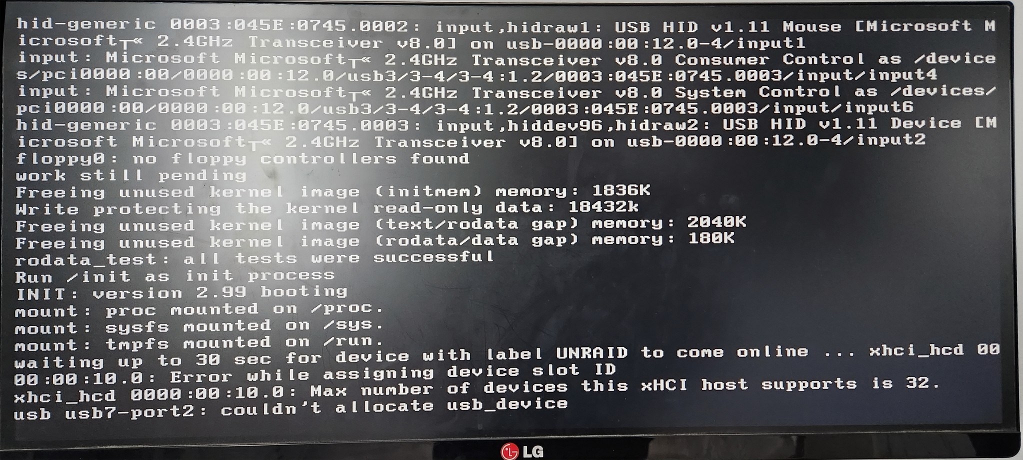

  6. Diagnostic zip one-diagnostics-20230118-2219.zip
  7. I did restored the boot flash drive, by copying all files to my pcs. then copying the contents of the 'previous' folder back to the root of the flash drive. I am back on version 6.9.2, and would like to update to version 6.11.0. I used the gui to update to 6.11.0, update successful, then reboot. But when I reboot, i'm stuck on mount: tmpfs mounted on /run. waiting up to 30 sec for device with label UNRAID to come online ... xhci_hcd 0000:00 :10. 0: Error while assigning device slot ID xhci_hcd 0000:00:10.0: Max number of devices this xHCI host supports is 32. usb usb7-port2: couldn't allocate usb_device not found - press ENTER key to reboot . . . - - - What can should I do to update to 6.11.10?
  8. no backup of flash. I saw this from another post, how do i get to this part? 'If you updated using the GUI you can revert to the previous release by copying the bz* file from the /previous folder in the flash drive overwriting the new ones.'
