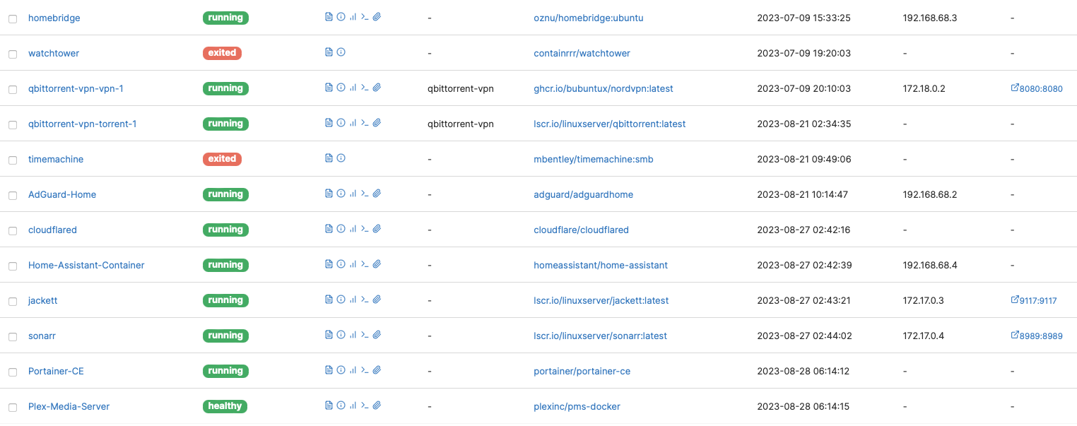

  1. I am monitoring my Unraid server WebGUI with Uptime Kuma. Every minute, Uptime Kuma sends a HTTP request to the URL over the Cloudflare Tunnel. So it's browser independent!
  2. I use cloudflare-tunnel in Docker, to access the GUI when I am not at home. Cloudflare Tunnel seems to keep connections alive every minute and that's why there where so many log entries. But nevertheless, Cloudflare Tunnel has a valid usecase - so how should I implement CF Tunnel in a correct way that such entries don't occur anymore?
