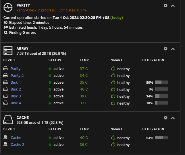

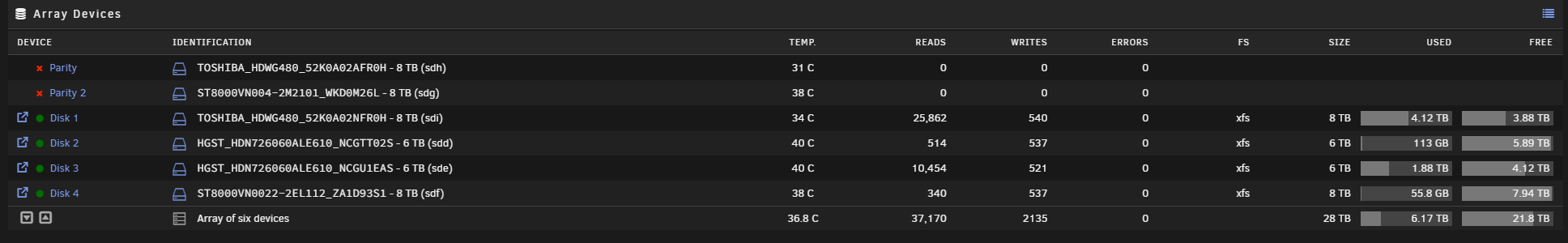

Just finished flashing, into the hands of fate with a reboot! Update: There are no problems so far! It previously couldn't get past 0.1% without throwing thousands of UDMA CRC Check errors! Thank you for everything so far @Faceman I will be updating the top of this post for people to refer to in the future.

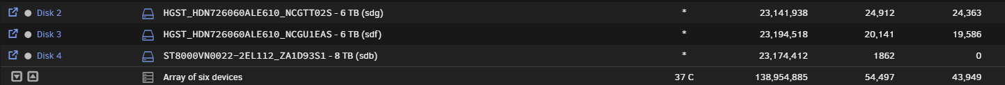

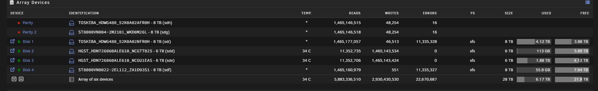

Problem solved! Problem has been solved by @Faceman. Thank you so much. You can scroll down further to see my original post. I'm going to put these in Italic so you know that this is the latest update about what happened if you want a TL:DR. My friend and I bought this LSI 9207-8i HBA card (Based on the SAS 2308 chip) from a reputable source so we were convinced it's not a fake LSI card. I also had a spare set of SAS->SATA connectors on standby and after swapping those, the UDMA CRC Errors still persisted. Therefore, my post below was where I was. To start with, my card were bought as follows: Adapter: LSI 9207-8i (SAS 2308) Firmware: 20.00.00.00-IT BIOS: 7.39.00.00 Chip Revision: (0x05) I eliminated the following: Heat Issue: I had a Arctic P12 Max blowing at both cards at 50% speed and both cards are cool to touch. Cable Issue: I had a spare set from another online provider and they still gave the same problems. Badly Seated Ports: I always did a light tension test and ensured that all the ports were secure. Card: I bought it from a place where most folks bought theirs from as well so while plausible, is more improbable than the above. Faceman made an educated guess that the issue was the firmware (and after doing some research, it seems this was a common culprit) so if this is the firmware your card came in, this is the problem causing those errors to pop out. Scroll down and you'll see that i find out that I found a post on reddit that shows someone who copied two files from two downloads into their Unraid USB Stick and executed the commands. See the solution for Faceman's very detailed instructions on how to do this within Unraid. !!!! ENSURE YOUR ARRAY HAS BEEN STOPPED BEFORE DOING SO !!!! After doing the flash and a reboot later, mpt2sas_cm0: LSISAS2308: FWVersion(20.00.07.00), ChipRevision(0x05), BiosVersion(07.39.00.00) And as you will see in the last post, i started a parity check with no more UDMA CRC Check Errors. Thank you so much once again @Faceman for the help!!! I have learnt a lot and I hope this post will help others who encounter this problem! ________________________________________________________ ORIGINAL POST _________________________________________________________ So I moved my system from an AMD 3950X to a Threadripper 2990WX with 128GB of RAM and shifted from using SATA ports to a LSI card. Booted up Unraid and made sure the drives were in the correct order and was amazed at how easy it was to migrate to another system. I went on with my way and my guys just finshed a Satisfactory game session (hosted on the same server) when I saw my browser window flashing orange at the side, I was being thrown a lot of Notifications from the Dashboard about my drives having SMART problems and upon investigation, my drives were throwing out CRC errors because it was doing a parity check (It's 1 October where I Live now and its set to do once every month on the 1st) I immediately stopped the parity check because it was going into the thousands. I have attached the diagnostics file. From what I see, most people say that it might just go up a few times then stop but mine just keeps going up. I looked into the SMART Error logs and this was what it said (The latest error): Error 2754 occurred at disk power-on lifetime: 47506 hours (1979 days + 10 hours) When the command that caused the error occurred, the device was active or idle. After command completion occurred, registers were: ER ST SC SN CL CH DH -- -- -- -- -- -- -- 84 41 e0 00 00 00 00 Error: ICRC, ABRT at LBA = 0x00000000 = 0 Commands leading to the command that caused the error were: CR FR SC SN CL CH DH DC Powered_Up_Time Command/Feature_Name -- -- -- -- -- -- -- -- ---------------- -------------------- 60 00 30 a8 6f 08 40 00 09:24:39.031 READ FPDMA QUEUED 60 00 38 a8 73 08 40 00 09:24:39.022 READ FPDMA QUEUED 60 00 28 a8 6b 08 40 00 09:24:39.020 READ FPDMA QUEUED 60 00 20 a8 67 08 40 00 09:24:39.020 READ FPDMA QUEUED 60 00 18 a8 63 08 40 00 09:24:39.020 READ FPDMA QUEUED Then I went to the Main page and to my horror, I saw errors on Disk 2 and 3: I am at wit's end on what to do. Please do provide some guidance on how I can help to resolve this! Thanks for taking time off to read this! Edit: I plugged everything out and plugged all the cables back in again. Still the same problem. diagnostics.zip

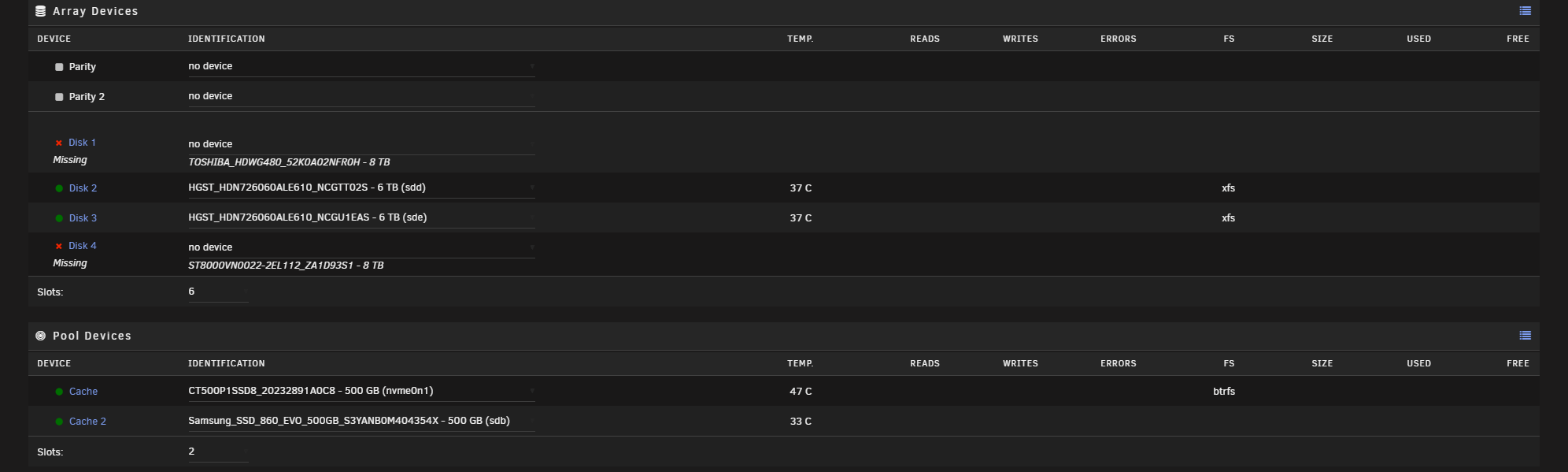

Server was running fine when suddenly two disks disabled.

Ok, I restarted the system (and remove the two new sticks of RAM I installed since they're the only thing that changed, all these started happening AFTER I installed the sticks) and the 4 disks are back but the two Parity drives are still disabled. Shall I rebuild on top again? I did SMART Short tests to check if they were ok and both were completed without errors. wdnas-diagnostics-20240216-2215.zip

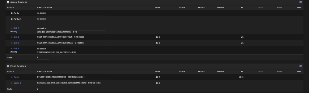

Sorry for necroing this. Now another two disks has failed. I have successfully rebuilt on top once from the previous time, but now both Parity disks have failed. I ran a read check for a abit and its turning up lots of errors. Out of fear i stopped the scan and array and ended up with this I have no idea what is going on. Attached is the diagnostics before i powered down the system as I'm going to check the cables and power. I dont know what to do next for now. Please help wdnas-diagnostics-20240216-2159.zip
