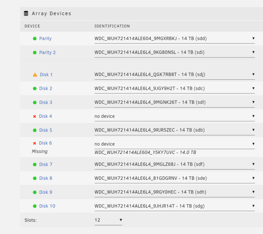

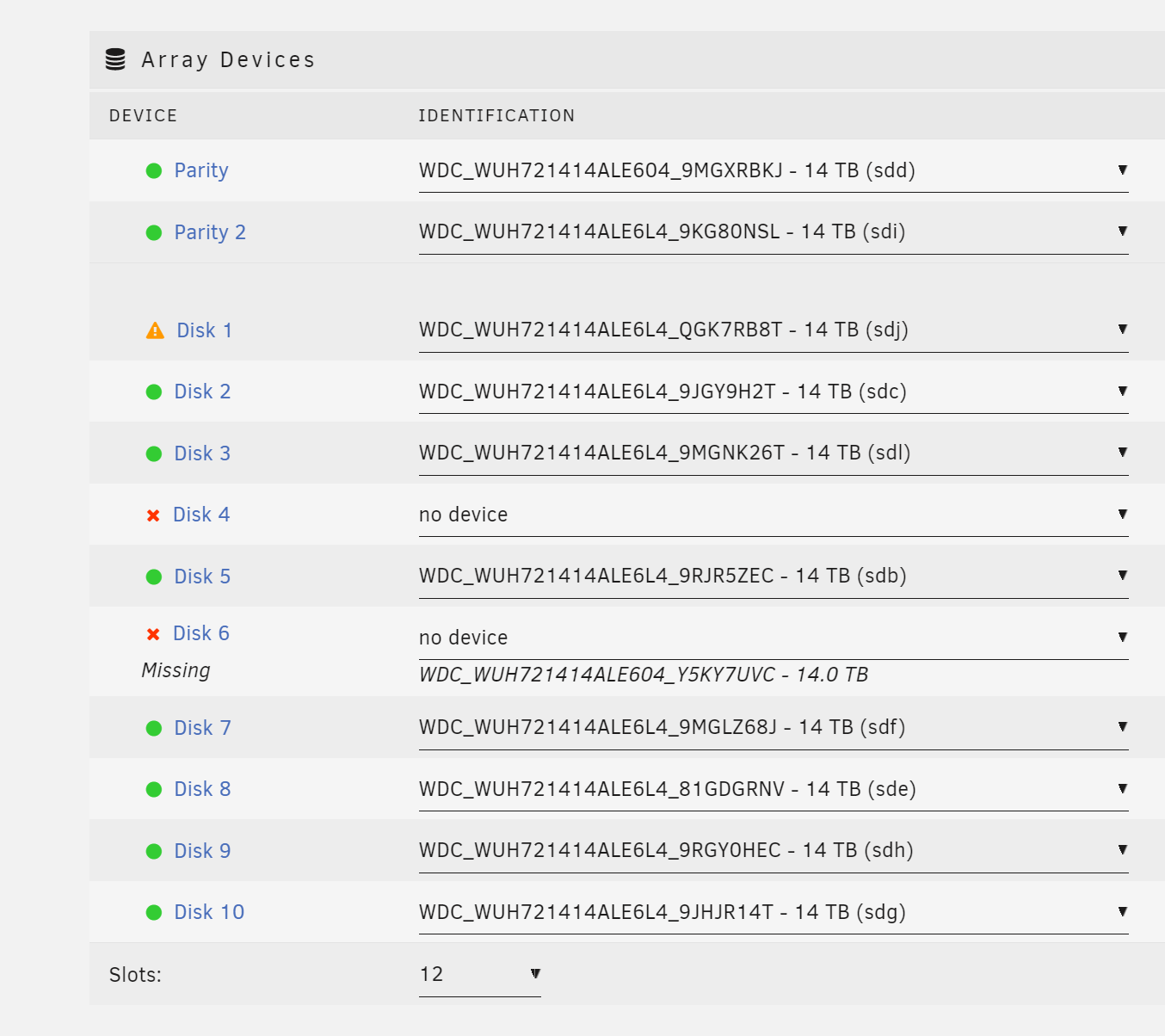

  10. I was recently doing a parity check, and my drives were reading at a crazy slow drive, (1-10 MBps) I tried stopping all dockers, figured stopping the activity would fix that. Then restart the parity check, then my Parity 1 and Disk 8 "Device is Disable contents emulated" I was going to restart my machine, see if that helps (was going to put it into maintenance mode,) but then my power supply kicks the bucket. I replace the power supply, double check my cables and turn it on Now Disk 6 is "missing". I turn off machine, swap sata cables with disk 3, verify power cable is plugged in. Still Disk 6 is missing with known working cable. What is the best path moving forward to fix this. tower-diagnostics-20240204-1520.zip

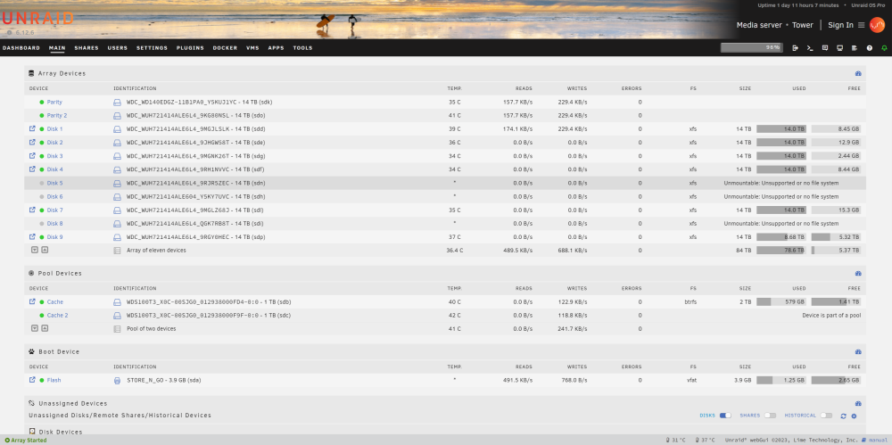

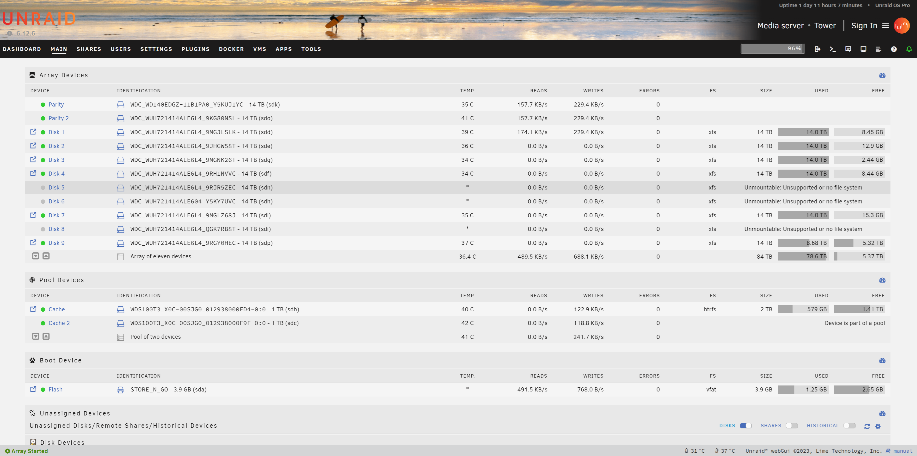

  12. I recently had Disk5 HDD Failed and Disk6 "Unmountable: Unsupported or no file system". I had some issues, unclean shutdown (Likely unrelated) I swapped both drives and rebuilt the array. Now Disk5, Disk6, Disk8 are "Unmountable: Unsupported or no file system" I feel certain the data on Disk8 is still physically there, and I believe Disk5 and Disk6 are as well after the rebuild The drives in the rebuild were reading/writing at full speed for the rebuild. Thoughts, if I had data lost, it wouldn't be a big deal, as its mostly downloaded movies/tv shows for the plex server, but it would be nice to not have to redownload 42TB of movies/TV shows. Attached are Diagnostics and Screenshot. tower-diagnostics-20240113-1014.zip
