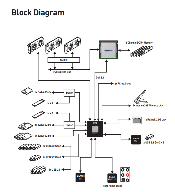

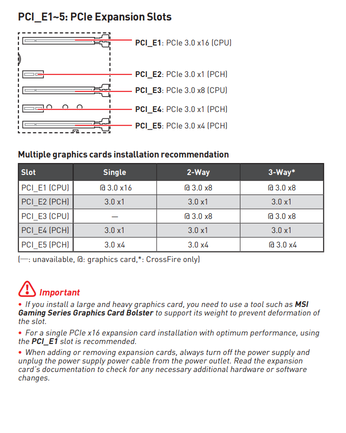

  20. This is the cable I am using: Amazon cable: Internal Mini SAS to SATA Cable, SFF-8087 Host to 4X SATA Target Cable Compatible with Raid Controller Hard Drive - 3.3 Feet / 1m https://www.amazon.ca/dp/B0BCN48K2H?psc=1&ref=ppx_yo2ov_dt_b_product_details The fact PCI says the card is "EMPTY", and not "Unknown" makes me think I am not at the driver stage yet.
  21. Being my server has water cooled gpu and cpu with rigid pex tubing, not feasible. So I took my current PC, removed the GPU, and put the card in it. It does not have a board explorer in BIOS, and the BIOS isnt helpful. I loaded windows 11 and opened device manager, under IDE ATA/ATAPI Controller, its lists: Standard SATA AHCI Controller, PCI Bus 0 (Which is the first slot I put the LSI in) "This device is working properly" Standard SATA AHCI Controller, PCI Bus 5 (I presume is the on board Sata controller) "This device is working properly" I have 1 hard drive plugged into the LSI, no hard drives show up. Suggestions? LSI firmware need to be flashed?

  23. Hoopster: Thats essentially what I read, that the PCI x8 gen 2 will work in my PCI x4 gen 3 slot, with the note of lack of performance for SSD and I am running HDDs. I also have limitations of 1 Gbit Network the bigger bottleneck in my system, and I use it as a Plex Server mostly. However I am still trying to get my card to work. I wonder if its a bad card, or a setting on my bios, but I can not find anything regarding it
