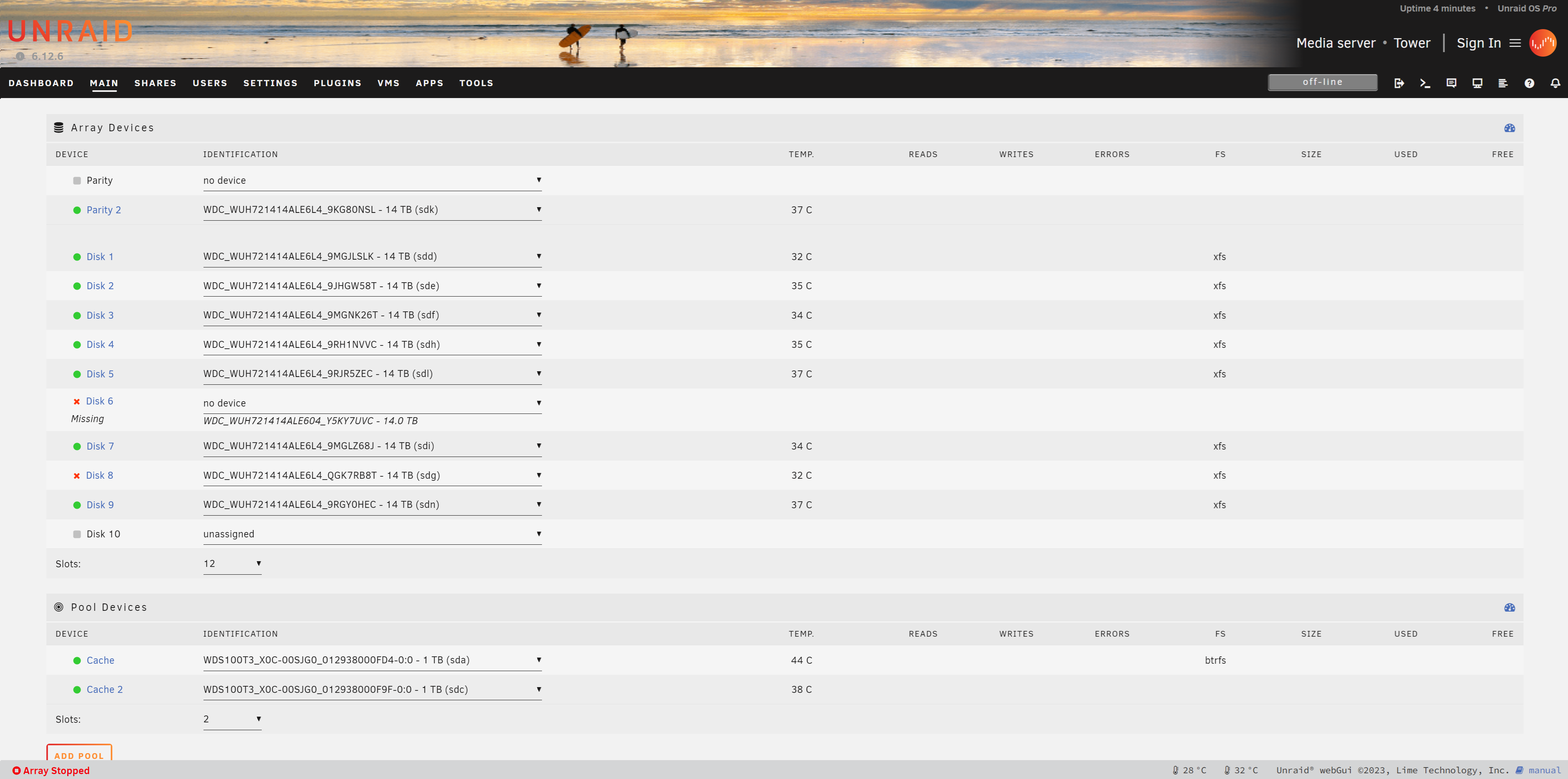

missing drives?
I was recently doing a parity check, and my drives were reading at a crazy slow drive, (1-10 MBps)
I tried stopping all dockers, figured stopping the activity would fix that. Then restart the parity check, then my Parity 1 and Disk 8 "Device is Disable contents emulated"
I was going to restart my machine, see if that helps (was going to put it into maintenance mode,) but then my power supply kicks the bucket.
I replace the power supply, double check my cables and turn it on
Now Disk 6 is "missing".
I turn off machine, swap sata cables with disk 3, verify power cable is plugged in. Still Disk 6 is missing with known working cable.
What is the best path moving forward to fix this.

It was a bad power cable on the missing device
I just replaced both drives and rebuilt the array. (Parity 1 and Disk 8)
