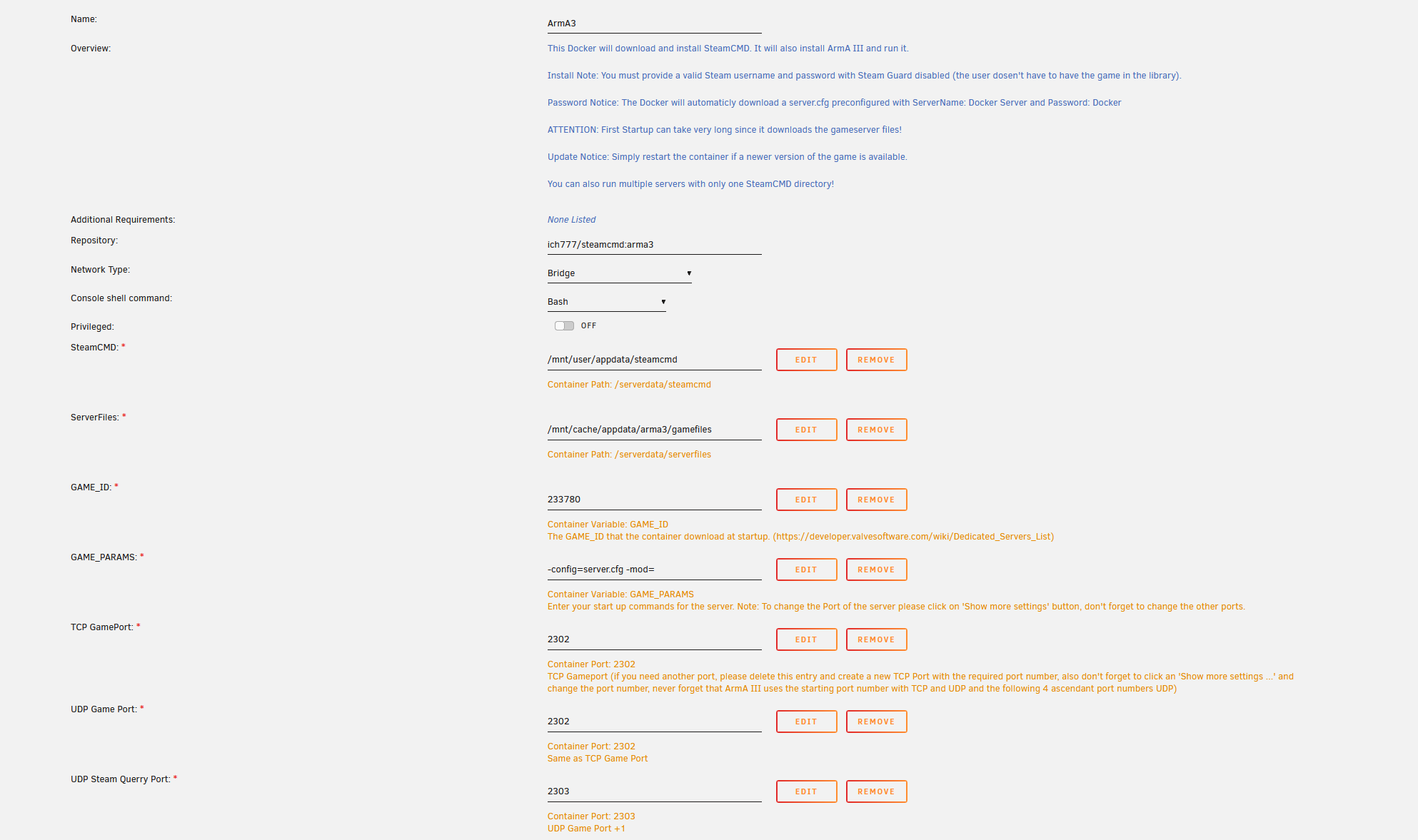

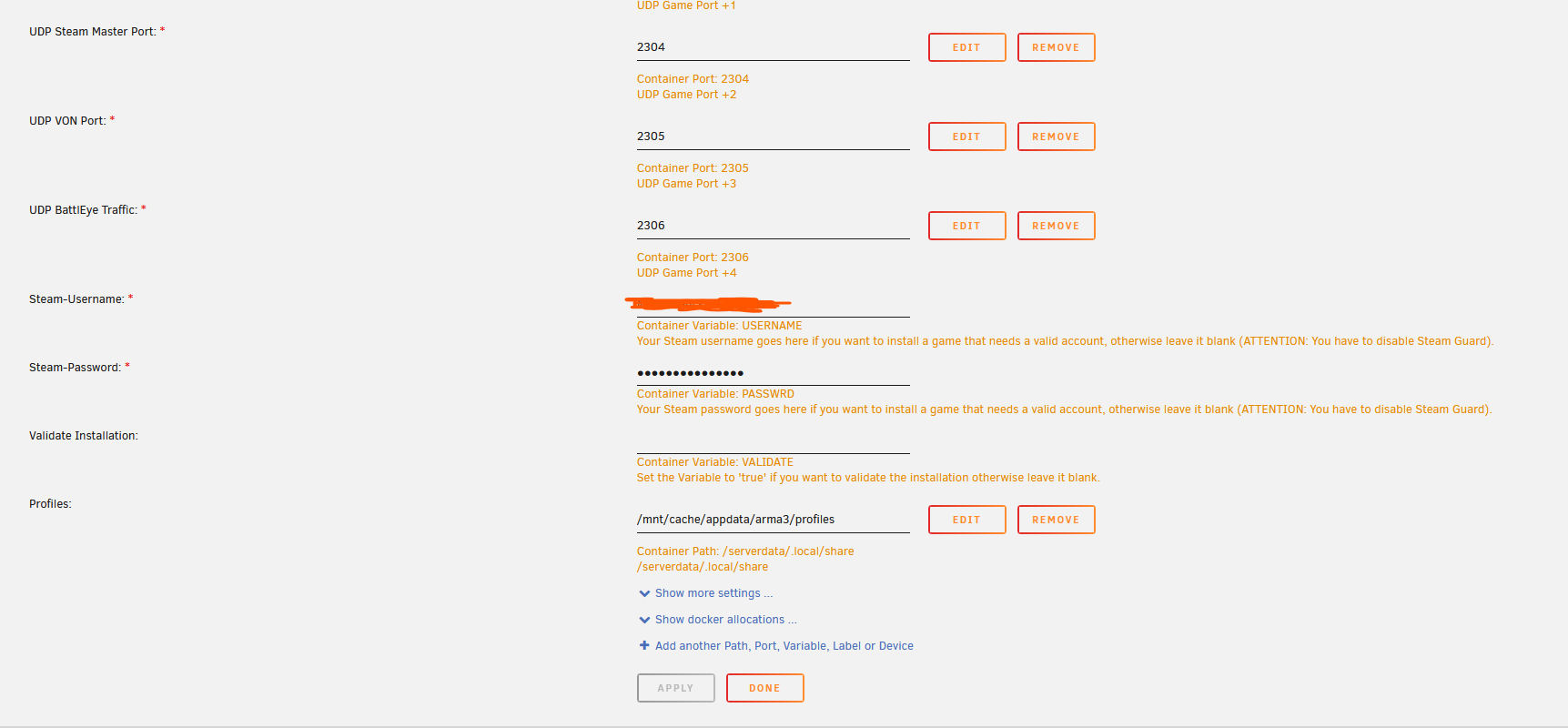

  4. Thanks for the quick response. All the settings are default except for login information. As a side note I have yet to port-forward anything yet I just wanted to test it first. MOBO: ASRock B450 Pro4 CPU: AMD Ryzen 5 2600X Six-Core @ 3600 MHz RAM: 48gb DDR4 Storage: 12tb HDD, 1TB SSD (cache) edit: I did catch one error before the log closes out on me, 15:49:56 Could not enable linux core dumps. Error 1 - ����6 15:49:56 SteamAPI initialization failed. Steam features won't be accessible! 15:49:56 Initializing stats manager. sh: 1: /sbin/ifconfig: not found
  5. Hey just wondering if I access the server from the logs or terminal? I am trying to run the Arma 3 docker and when I access the logs it will run through its course but then suddenly close out and restart sometime after "SteamAPI...OK" . I am not sure why, but my second question is if these logs are saved anywhere I can check...?
