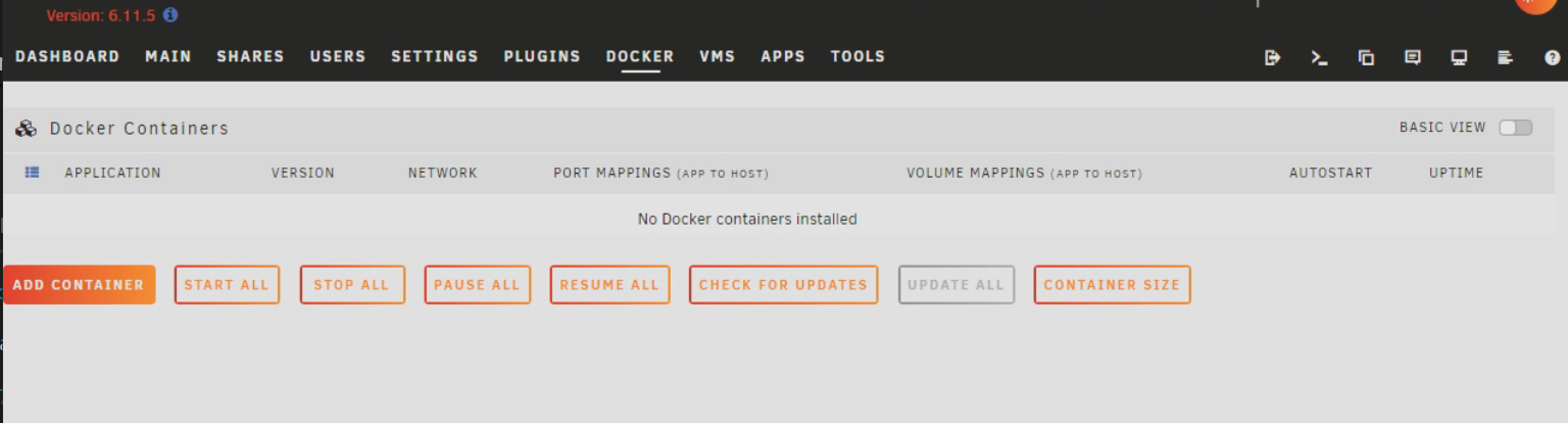

  1. I have manage to solve the issue, the issue was that the original docker folder was corrupted, so i did a new one and the docker is not running.

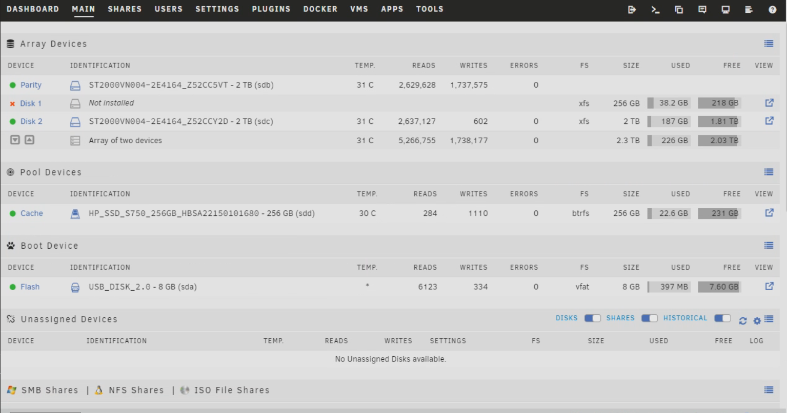

  2. Ok so i replaced the ssd that was bad and the system took 2 hours to finish the data check. Everything was ok and check the docker and was empty. I try what you send me and the docker did not want to start. OKK then i restart the server and found now that the server has stopped the array and the cache disk is missing now. What in the world is happening? Sending the last log of this hpserver-diagnostics-20230916-1703.zip

  4. Well no, is not ok this is the docket when duplicacy should be
  5. Here it another diag, please let me know hpserver-diagnostics-20230913-0734.zip

  7. Here it is hpserver-diagnostics-20230912-2126.zip

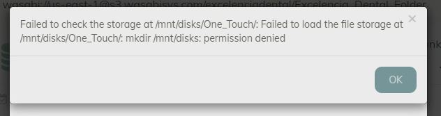

  8. Greetings I have this server running unraid and the server encounters a disk error. The duplicity docker disappears and cannot install new ones, a document folder that is shared is empty and that is shared is empty, and many other issue. Can someone help me since this is a server for a dentist and the window server is running in this unraid. I am not to expert in unraid and dont know how i can fix this.
  9. I have try everything and this keeps going. Where do i go to change permission so it can backup to the external drive?
  10. Greeting Sorry for the delay, then how i can write in this this for the backup?
  11. The how will be the best way to make this backup write in the USB external drive?
  12. Hi, What I want to do is to Duplicacy store backup data in that storage. I place does line there, yet have issue with permission.
  13. Greeting Everyone I am using Duplicacy for backup. Because the client has some issues with the internet, it is difficult to upload a backups, so I want to make a backup using a USB 4TB OneTouch drive. The issue I am having is that apparently, Duplicacy requires permission to write on it. Can someone direct me to the write direction where to allow this permission? Thank You
