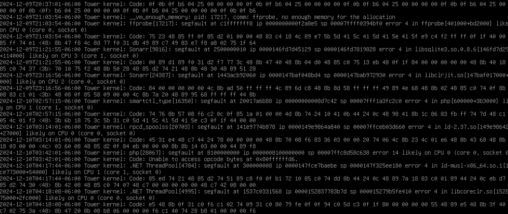

  7. Update: I ended up doing another MEMTEST and it failed so the RAM must have gone bad from the first test, should have checked that first. Replaced the two sticks, they passed MEMTEST (so did the first set...) and its ran a couple days now and some parity checks without crashing. Let's hope that's all there is to it, thanks to everyone for helping me fumble through this. Time will tell if it was just RAM or RAM + something else like the PSU but right now were stable.

  10. First parity check went fine, the second one overnight caused a crash. So... power supply it looks like. Would a 700w be good to go, or should I go to 800 or more?

  13. I have had trouble with my server staying stable; it randomly hard crashes and I set up a syslog server to try and capture the reason as diagnostics can't be taken until after a hard reboot; they are full of segfault 'likely on CPU'. Upon researching the segfault error others have reported it is their CPU. Memory tests have passed before, but I will launch another one. Not going to provide the other logs as their last entries was last night, but the kernel.log has entries from today and its all segfaults. I can provide any other logs if wanted; I just don't want to replace a CPU for no reason. I presume CPU would be replaced first before mobo or at least I hope so. As for the other weirdness ive had a lot of problems with Docker image becoming constantly corrupt/failing to stop when told to, or the *arr databases corrupting as well. Anything else I should do to troubleshoot? tower-diagnostics-20241210-1031.zip
