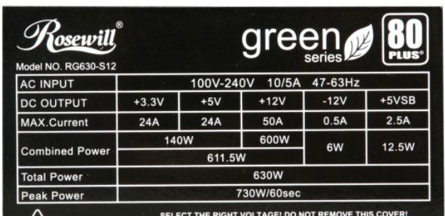

A 500W PSU should be plenty for 6 HDDs... A bigger PSU isn't necessary better for more HDDs if your PSU doesn't have enough 12v rails to handle them.
You need to look at the +12V rail on the current PSU sticker to see how many Amps are on it.
This example PSU has 600W on the 12V Rail and is rated for 600W. That's up to 60 10W HDDs as long as you don't exceed the Amps. (Look at drive start up amps)

PSU says 35 amps on the 12v rail... maddeningly I cant find startup amperage on the drives, but the spec sheet says 11.3 watts for read/write and dividing that by the voltage gives me about 1amp per drive reading/writing.  That could be wildly off vs startup, but I cant find anything about amperage let alone startup amps.
Presuming read/write is max-ish usage were looking at 5 out of 35 amps running the drives.

When looking at PSU current ratings for each voltage buss, you have to look beyond the first one you that you find!  For example, @MowMdown posted up this one:
Now look as you go down the rating chart.  If you pull 600W (50A), you can only draw 11.5W from both the +3.3V and 5V buss combined-- virtually no power for the MB.  Rosewill is not the only manufacturer to do this type of specmanship.  Every PSU I have ever looked at does it.  By the way, all PSU's have overcurrent shutdown circuitry designed in.  Exceed that setpoint current for a few milliseconds that the PSU will normally completely kill that buss' output!

What pulls from the 12v?  Is just the mobo pulling from 3.3v and 5v rails?  I am trying to figure out how big of a PSU to get or maybe just hitting the easy button and getting a 850 though the math I am working (which may be wrong) my drives should never be pulling 35amps/420 watts with just a CPU and five drives.
I don't understand power supplies well, if it isnt obvious.  Just get the 850 and call it a day?  750?  Is it not possible for the CPU to be at fault here?
The example was a single rail supply.  (Most PS today are single rail.  A few years ago, dual-rail  +12V busses were common.)  What pulls from it?  Generally the HD's and the GPU.   (The Motherboard may use a bit of +12V current.)  With hard drives, there is an issue with inrush current when the drives spin up.  With Unraid this can be a problem since all of the HD's will be spun-up whenever any parity type operation starts.  The peak inrush current is about 2-3 amperes per drive depending on a lot of factors.  (Finding the inrush current from the manufacturer's spec sheet is a hit-and-miss situation.)  If this current exceeds the max current rating for even a few milliseconds, the PS will probably go brokers!  Remember that your MB's  CPU, RAM and ancillary chips all require power as do the case fans.   You can get a feel of the baseline load on your PS by looking at the power draw on the UPs settings.  (One of my systems is idling at about 61W right now.)
You have 5 HD's on your system right now so the +12V current requirement is 15A max (75W  180W)!   Your CPU is rated at about 60W.  That 450W should be enough unless you have a powerful GPU card.  However, that is not to say that the PS might not have issues.   Modern PS are not just a transformer, rectifier, smoothing capacitors and a couple of voltage regulators any more.  They interact with the MB in many ways.  Crashes, random shutdown and random reboots have been caused by 'bad' PS.  They are one of the easier components to replace.  (RAM is always the first choice here.)
