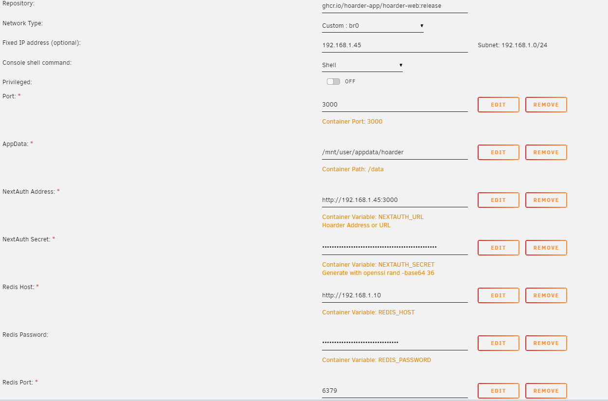

  2. Thanks for the help. I switched Redis to bridge mode, and removed the 'http://', but I'm still getting the ehostunreach error. One other thing I just thought of, I am running AdGuard as a DNS server on my network, would that have an effect on it? Other than that, I'm not sure.
  3. I am trying to get Hoarder installed on Unraid, but I keep running into issues. I have Hoarder, Hoarder-workers, Redis, and Browserless installed. I figured I can add the search feature after I get it working. When I try to add a bookmark, it seems like nothing happens. If I refresh the page the bookmark shows up, but no description or image, and no tags. I have tried with Ollama and OpenAI, neither seem to work. I am getting an error in the logs, that looks like it is unable to connect to Redis: Error: connect EHOSTUNREACH 192.168.1.10:6379 at TCPConnectWrap.afterConnect [as oncomplete] (node:net:1605:16) at TCPConnectWrap.callbackTrampoline (node:internal/async_hooks:130:17) { errno: -113, code: 'EHOSTUNREACH', syscall: 'connect', address: '192.168.1.10', port: 6379 } I am running the Redis docker also on unraid. It is running in Host mode, 192.168.1.10 is the IP of my Unraid box, and it is running on the default port 6379. In Hoarder, I have tried the hostname redis, http://192.168.1.10 and 192.168.1.10. The only thing that changes is when I use "redis" as the hostname I get a different error: Error: getaddrinfo ENOTFOUND redis at GetAddrInfoReqWrap.onlookup [as oncomplete] (node:dns:107:26) at GetAddrInfoReqWrap.callbackTrampoline (node:internal/async_hooks:130:17) { errno: -3008, code: 'ENOTFOUND', syscall: 'getaddrinfo', hostname: 'redis' } I know Redis is working, because I am running Paperless-ngx which uses Redis, and it works just fine. Anyone have any ideas what my problem could be?
