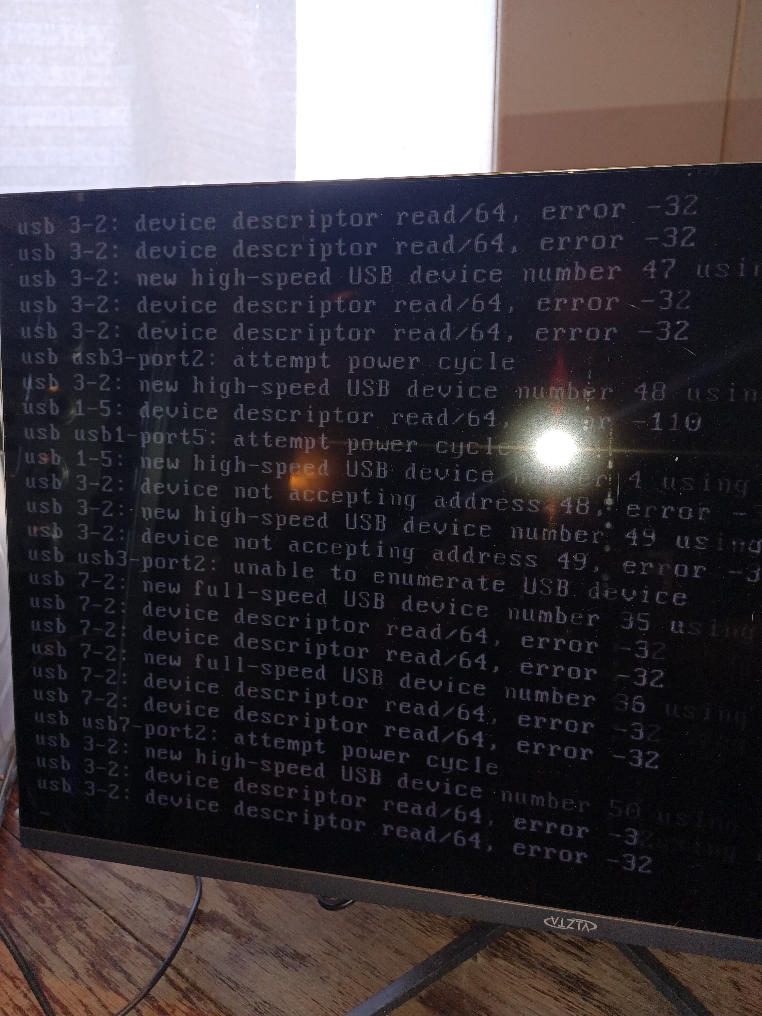

  1. I got the usb 3.0 card installed. This appears to be a working answer. While not happy that my new server has a limited set of usb ports at least they're 3.0 and this PC will be used as my backup server so most I/O will be done via the network. Good enough... Thanks again
  2. Todays results All 3 boot usbs were created using the unraid tool. The only items plugged in were the usb stick, the mouse and keyboard. After trying all the ports I learned that when booting to Win10, all of my usb ports work. I created another boot usb as Expressomatic suggested, using Zoran. When booting with either Unraid or Zoran I was successful in getting both of them to boot but only on my 2 usb 3.0 ports. However as soon as either of them started to load ALL of my usb 2 ports died. This leaves me without enough ports for the boot stick, mouse and keyboard. I ordered a usb 3.0 card which will hopefully allow me to get by with this less than ideal situation until a better solution is found or I get a different motherboard. Some searching did show that this m/b did suffer from problems concerning it's usb ports so JorgeB may be correct. My m/b doesn't appear to have a secure boot mode and my results were the same in UEFI or Legacy. Thank you both for your input.
  3. I created a new flash drive and get the same result. I've also tried using the usb stick from my other Unraid server. In all three cases when the machine starts I get the boot menu as to which Unraid I want to boot to (I.e.. w/gui, w/o gui, safe mode. etc.) Regardless of which choice I make you see the scrolling command lines of unraid trying to boot but after a few seconds most of the scrolling lines are referring to usb errors as in my photo. This scrolling continues without end until I force a shutdown. As I previously said, booting with a Win 10 install flash drive works normally so I don't think it's a problem with the actual flash drives. I checked on updating my BIOS but there isn't an update available. My BIOS is currently set to support both UEFI and Legacy. I forgot to mention I'm using Unraid 6.12.13
  4. I I recently tore down my working Unraid Plex server due to motherboard problems. I transferred my drives to a new PC built from new old stock components. However when I try to boot from my existing unraid usb stick it goes into a unending loop of usb errors. I did try booting it to a windows install usb and that appears to work normally and wants to install windows but I prefer Unraid. My screen scrolls by too quickly to make much sense of the errors but attached is a photo of part of the looping screen. I'm currently using a Gigabyte 970A-DS3P motherboard with a AMD FX-6300 and 32 MB of Ram
