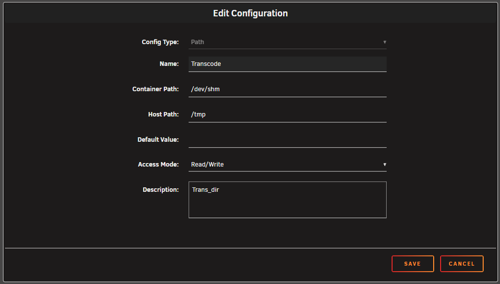

  1. Hi all. Recently my server has developed a problem where it will completely freeze when watching something via plex. All dockers and webui become unresponsive and the only way to "fix" it is to hard reset. I have attached my diagnostic file however it doesn't contain the errors at the time of the crash, I had to mirror my syslogs to the USB to get the errors below. Nov 14 22:54:50 Anfield kernel: i915 0000:00:02.0: [drm] Resetting rcs0 for preemption time out I initially replaced my RAM but the issue persists. I was writing transcode to appdata cache originally but as was suggested elsewhere I wrote to RAM via "/dev/shm" and the issue occurred again. On a side not I've attached the config change I made in binhex-plexpass to transcode to RAM if anyone can confirm this is the correct way to do it. Any help would be greatly appreciated. Thanks. anfield-diagnostics-20251115-1929.zip
