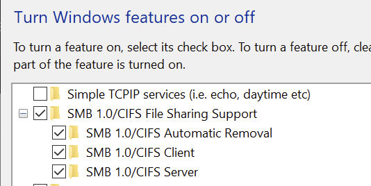

  17. Update: These were user shares, initially visible on Windows PCs. Looks like windows update turned off some features supporting SMB shares: In the below example, SMB 1.0/CIFS Client was not checked, only visible when the group is expanded. Maddening, as I turned these all on when I set up the shares. Once I turned them back on and rebooted, bingo the UNRAID server and it's (mapped) shares are visible once again. Thank you to those that replied!

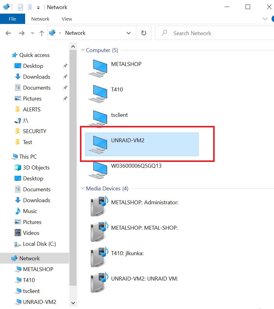

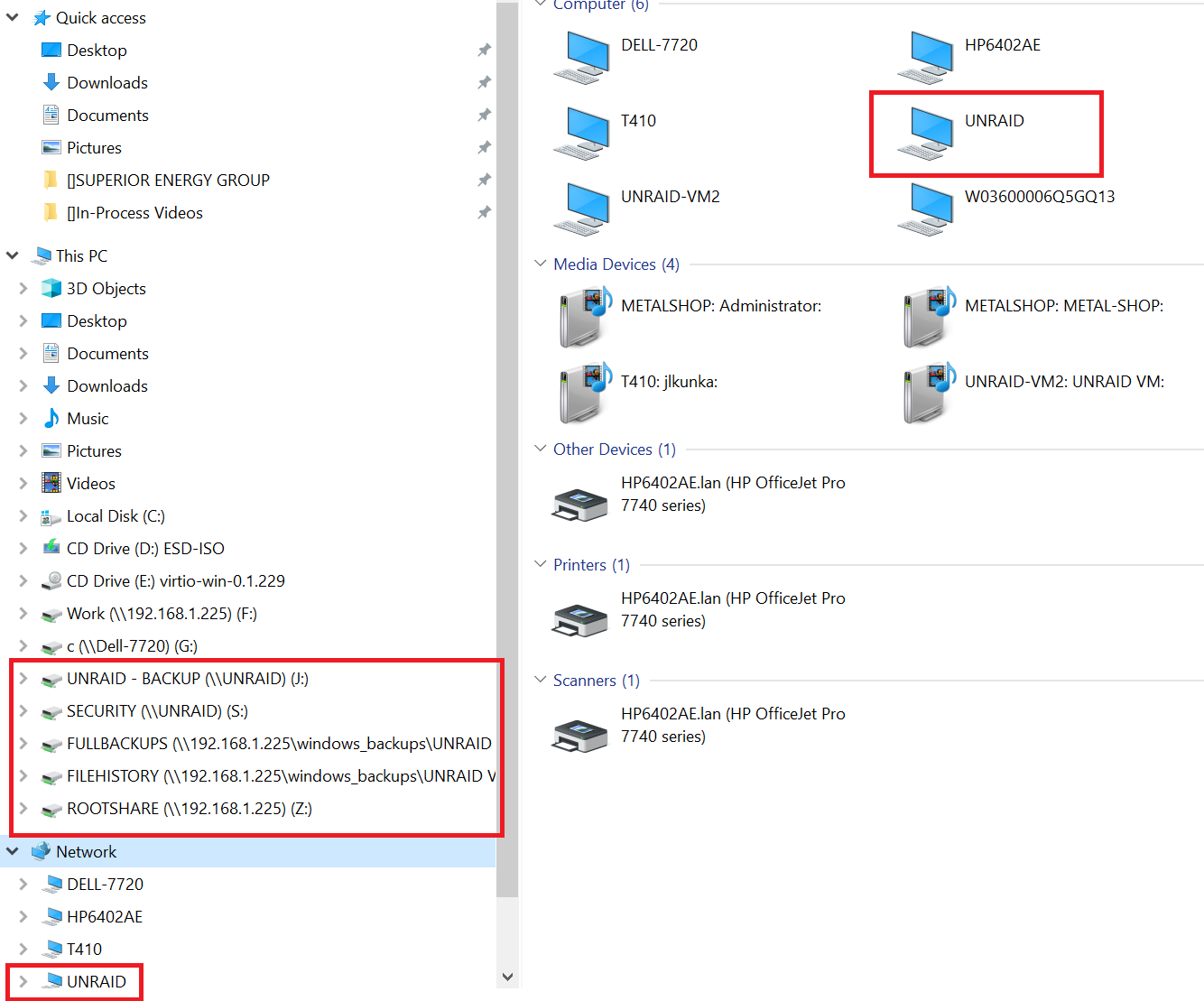

  18. I set up my UNRAID server (Version: 6.12.0-rc6) and SMB shares following SpaceInvader's excellent instructions. All was well for a few weeks. Lately I cannot see the server or it's shares from other Windows machines. There is a Win10 VM running on the server that IS visible to other computers. This VM can see the UNRAID server and the Shares. I am also running a Zerotier network, which was working fine. Same issue, can't see the UNRAID server or it's shares. The admin console for Zerotier shows the UNRAID server is online. Here's some screenshots from Windows Explorer, top shows the VM (visible) but no server. Bottom is explorer view from VM showing the server and mapped shares. I'm at a loss for what changed. Network is private, computer visibility "on", etc. What am I missing?
