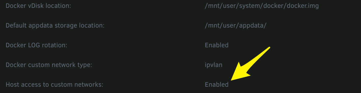

  5. Popping back in to at least divulge what my hang up on this was. NPM official wants to install on br0 network so it can use port 80/443 (I guess). My issue was because NPM could not communicate with any other docker on bridge, host, or a custom docker network I created. I could not figure out how to get the communication to work until I stumbled on the option: Settings -> Docker -> Host Access to custom Networks: Enabled Now NPM can communicate with each of the other containers and I'm able to setup local DNS names for each app I want as well as give them a wildcard cert via Let's Encrypt In my research I only saw references that "if it can't talk to the other containers, it won't work" in the NPM Official thread. But now how to go about fixing it. The above setting works.
  6. Figured it out. NPM couldn't talk to the other containers. Settings -> Docker -> Host Access to custom Networks: Enabled This is probably not the recommended method to do this, but it was the only way I could find to get NPM on the br0 network to see Nextcloud on the bridge/nextcloud-aio network EDIT: Should mention I went back to NPM since I couldn't wrap my head around Caddy. But the above setting still needed to change in order for it to communicate with the other containers.
