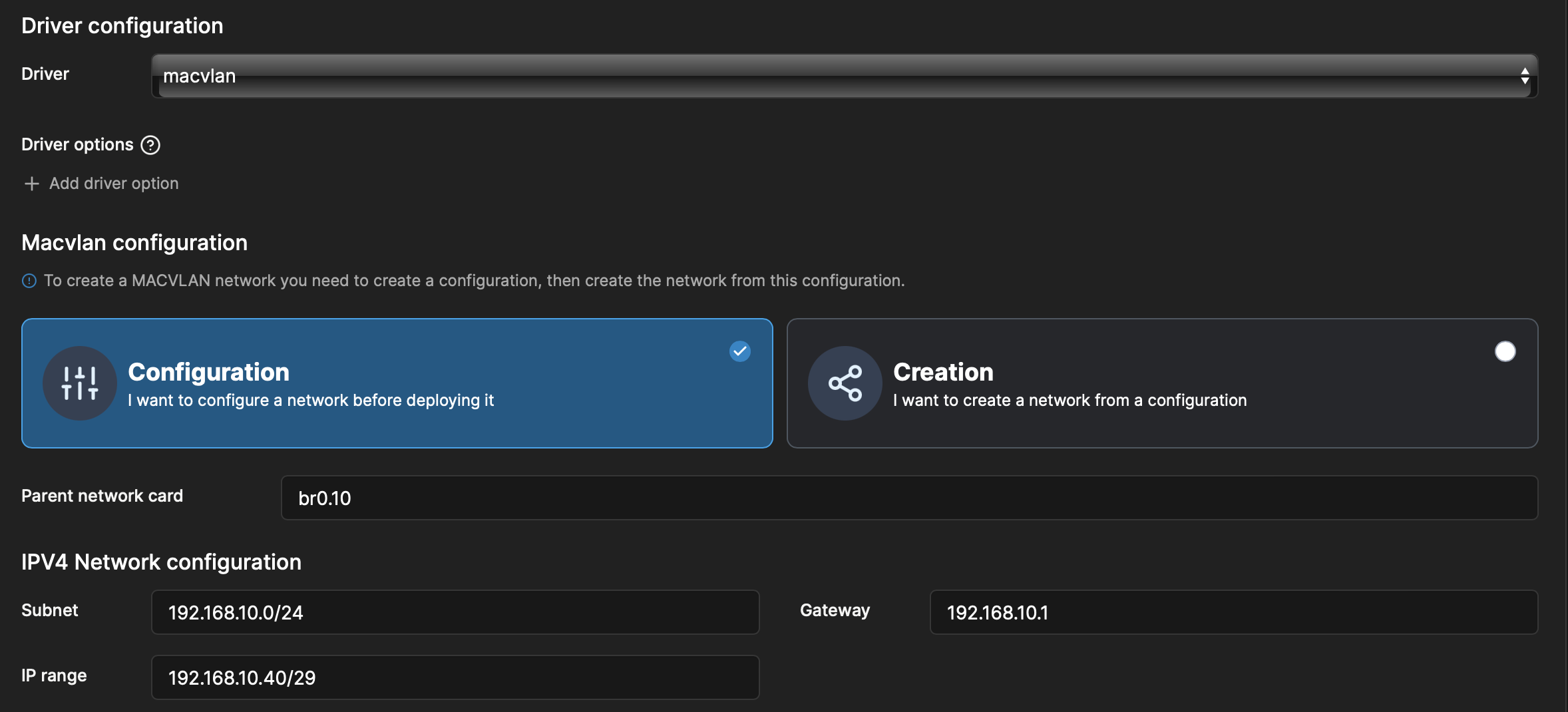

  1. It turns out that it was a remnant docker network I created via Portainer. I found this entry: 192.168.0.0/24 dev br-75ff69ec12b1 proto kernel scope link src 192.168.0.254 linkdown with docker network ls Which has the same exact subnet as the one on the bridge. From my understanding I thought the same subnets are possible in isolted docker networks (like the shim-networks), so I can not explain why this error occured. Deleting the network and restarting the service fixed the communcation error.

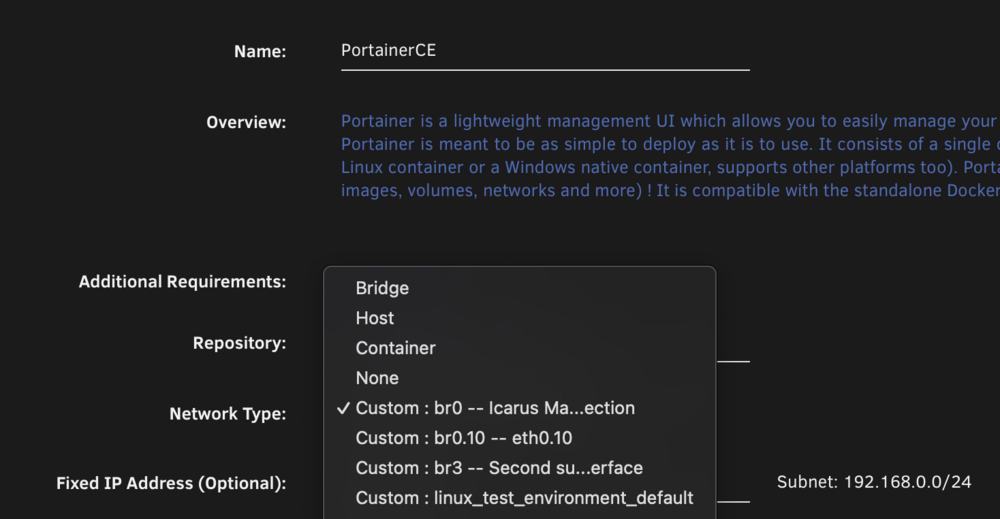

  2. also I just saw the 192.168.0.254 address that I overlooked the whole time, and I have no idea what causes the address. My Unraid address is 192.168.0.10 and the one of the NAS is 192.168.0.116. Custom networks in the Docker page are enabled (ticked br0, br3 and br0.10 with DHCP on all three of them)

  4. I tried to test what you suggested, but I get the same problem with the docker command in the Unraid CLI as with Portainer. root@Icarus:~# docker network create -d macvlan \ --subnet=192.168.10.0/24 \ --ip-range=192.168.10.40/29 \ --gateway=192.168.10.1 \ -o parent=br0.10 \ base_test_network Error response from daemon: failed to allocate gateway (192.168.10.1): Address already in use Despite the fact that I rebooted the system and turned portainer autostart off (so it didn't start at all during this cycle), the "Gateway already in use" problem remains. From what I understand, this is an additional problem right ? I didn't do anything about the autostart/ipv6 problem. Is this mandatory to be able to create the custom network at all ? The thing is that I am little anxious to start messing around with automatically created network settings in Unraid. I did this in the past and it sometimes took weeks for me to get the system running again, because I am simply not that proficient in networking. I wouldn't mind to create this custom networks in the CLI instead of inside portainer directly, but I want to try to avoid messing with the autostart procedures, if possible. Any idea why I can't create the network in the CLI (assuming your 2 posts are not directly dependent on each other) ?

  6. Hello, I am trying to replicate the Unraid behavior of the MACVLAN interface option (picture below), that is listed under each container, inside Portainer. The goal is, to have the same option when deploying a Portainer stack as with Unraid when starting a docker and selecting a Custom adapter, which in my case is Custom: br0.10, so a macvlan adapter that connects to the bride br0.10 which also is a parent of eth0.10 from the tagged VLAN 10. Unfortunately the network creation in Portainer (which is using the same docker socket from my understanding) is not as trivial. In the two step process of Creating a configuration and creating the network itself, I tried multiple combinations for subnet, ip range and gateway. -> The gateway seems to be the main problem: if I set 192.168.10.1 as a gateway, I get the error that the gateway can't be assigned twice. I saw a similar problem here: Link, What is the correct IP to use as a gateway ? It seems to be a virtual docker gateway, but what is it used for in the macvlan scenario and why is it not the same as my network gateway. -> If I set a different gateway, I am able to create a container via a stack, but the container has no internet connection and can't ping other containers even in the same subnet (which the macvlan containers created via Unraid directly can !) Unraid Docker (Portainer as an example): Portainer: My exact configuration in Portainer: - name: examplenetwork_config - driver: macvlan - parent network: br0.10 - subnet: 192.168.10.0/24 - IP range: 192.168.10.40/29 (that is actually the range I want to assign for this stack, Unraid shouldn't assign anything near there with 192.168.10.128/26 set in the Unraid docker settings.) - gateway: 192.168.10.1 And when trying to create the network with: - name examplenetwork - driver: macvlan - configuration: examplenetwork_config I get the following error: "Failure Unable to create network: failed to allocate gateway (192.168.10.1): Address already in use" When changing the config to: - name: examplenetwork_config - driver: macvlan - parent network: br0.10 - subnet: 192.168.10.0/24 - IP range: 192.168.10.40/29 - gateway: 192.168.10.40 I can create the network, but as already mentioned it can not reach anything. What am I doing wrong here ? I also don't understand where my error is in the thought process, because in Unraid directly it works flawlessly. Is "Custom: br0.10" really a macvlan bridge, how else would each container get it's own IP ? Any help or even tips would be appreciated.
