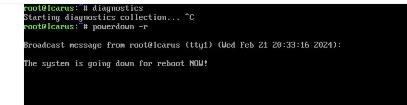

- can not create diagnostic file over IPMI console (stuck forever)!
- also system can not be shutdown (powerdown) -> had this problem for a longer time, it's stuck with "The system is going to reboot".

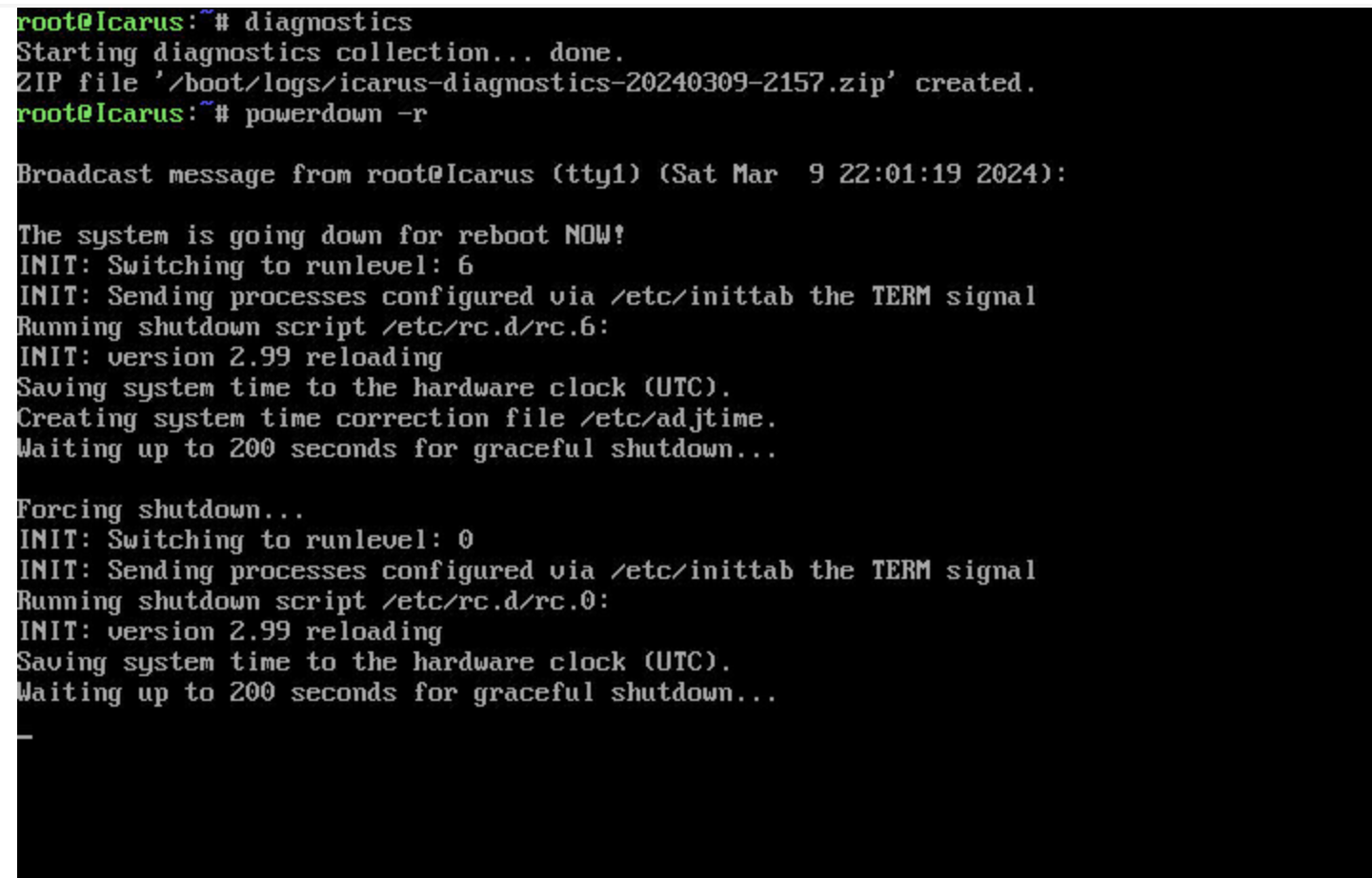

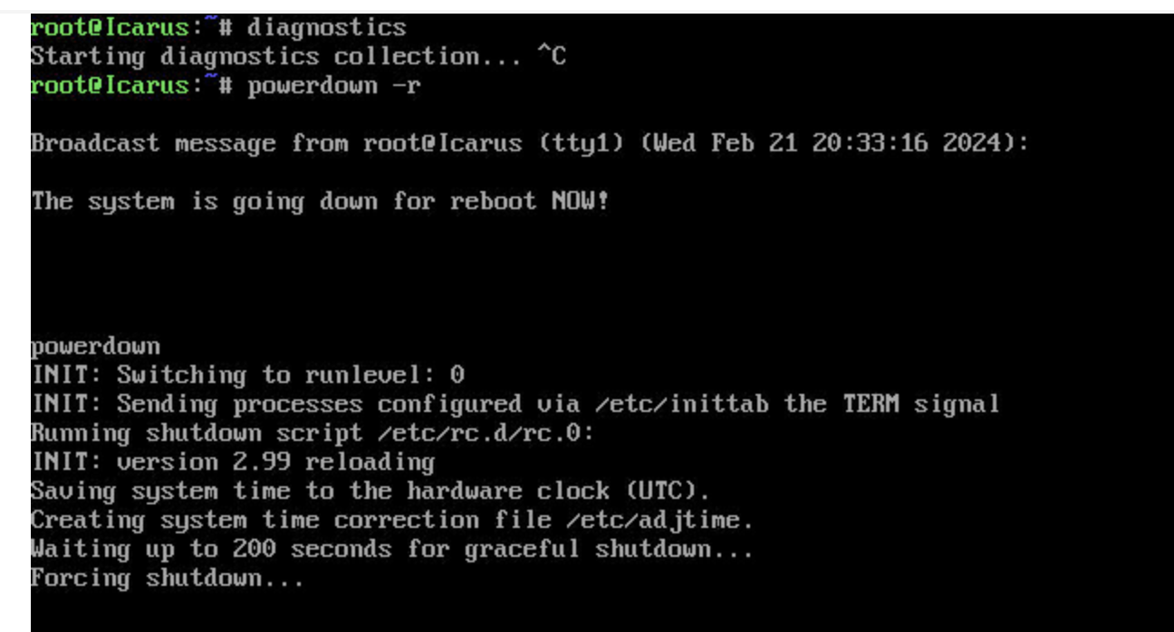

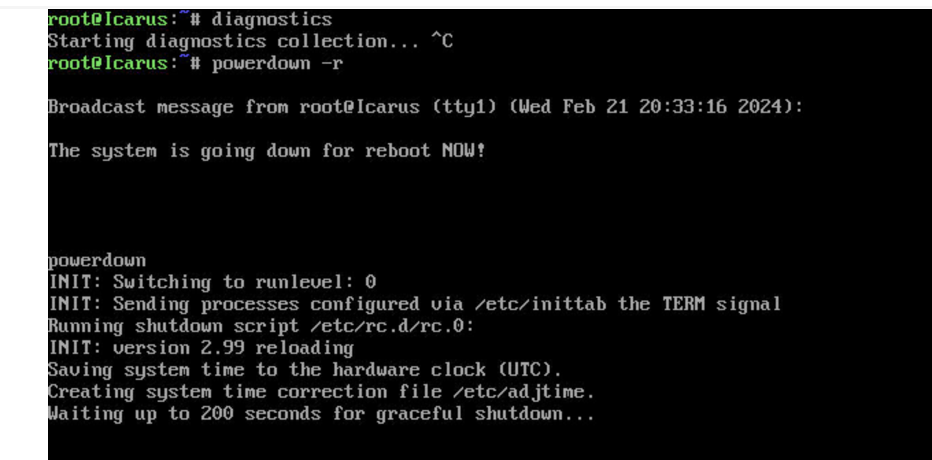

Orderly shutdown via IPMI leads to:
Second orderly shutdown AND --> nothing happend. System doesn't respond...

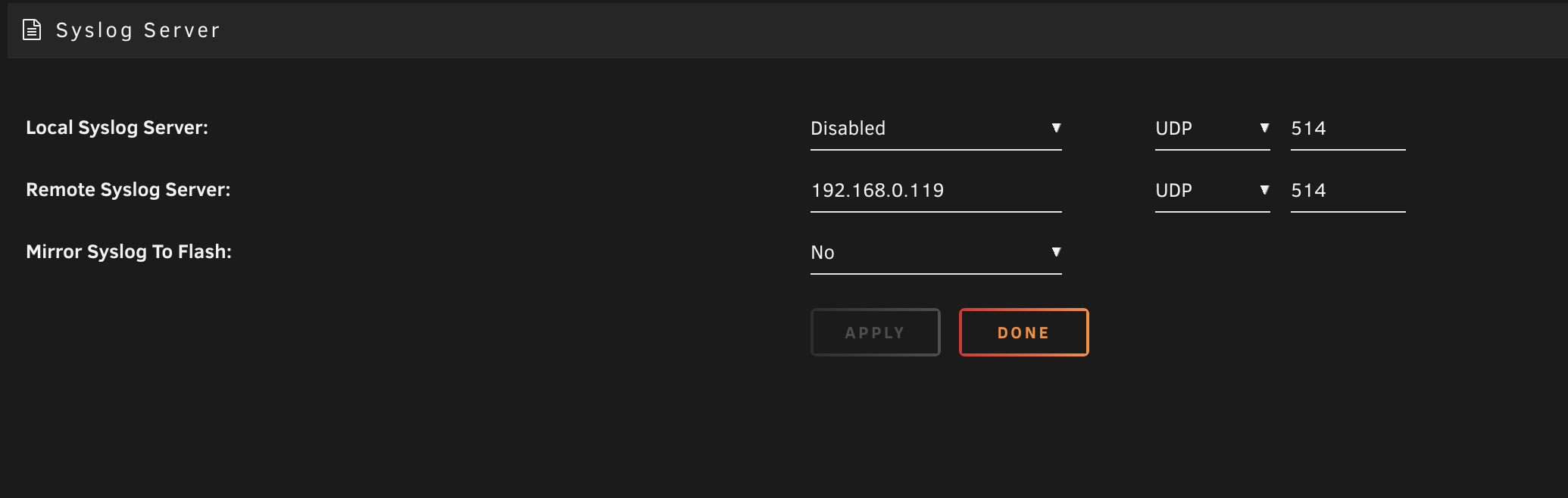

I have a second server running for future backups, can I also stream the diagnostic log to a share of that machine ? It doesn't have much storage though (just a few gb left and only one HDD), could that result in a problem e.g. bottleneck ? I want to avoid using the same machine or a VM on the same machine,  because if the VM fails first I obviously have no log at the failing point to begin with. Can you suggest a syslog server for truenas ? If not I will just try to get it set up with the infos I find and post the log here, as soon as I have one.
I was trying to get a syslog (graylog) server up and running on my second machine, but as always it's not that easy to get it to run properly.
So I radnomly looked into my current log and a lot of errors were popping up over the day. The limiting request errors are actually pointing to the mac I am acessing the server with (via VPN). Is this a big deal ? Can I ignore the error messages ?
Also in my syslog server there are 0 messages reported. Can I send a test message to the syslog server to validate it ? Something like "diagnostics *target ip of log server*" ?
I will have a second look tommorow if any messages are reported but for now it seems like the syslog server option in Unraid is not working for me (attachted you can find the syslog configuration).

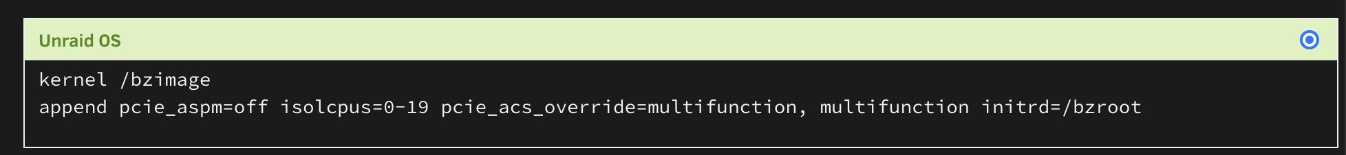

On 3/8/2024 at 3:26 AM, JorgeB said:
See if this helps with the PCIe errors:
Unfortunately, that doesn't seem to solve it. I configured my Syslinux Conf and restarted the machine:
1918292737_Bildschirmfoto2024-03-09um15_33_19.thumb.png.6b78155794d763e4bd1cb008ba87e3ef.png

Unraid Shutdown from the IPMI looks like this (see the two "waiting 200 secs ..."), tried it two times, shutdown  is not  executed even if forced by Unraid, so I have to cut the power via IPMI command):

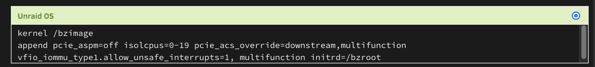

I would be glad about any new input for the Syslinux file! I turned on ACS OVERRIDE to MULTIFUNCTION, but left VFIO unsafe interrupts OFF (NO).
I will try to add all the unsafe interrupts and test again - for now no luck!

ACS Override = Multifunction and VFIO Allow Unsafe Interrupts = Yes, just gets rid of the log entries. Error persists:

Syslinux Conf used:

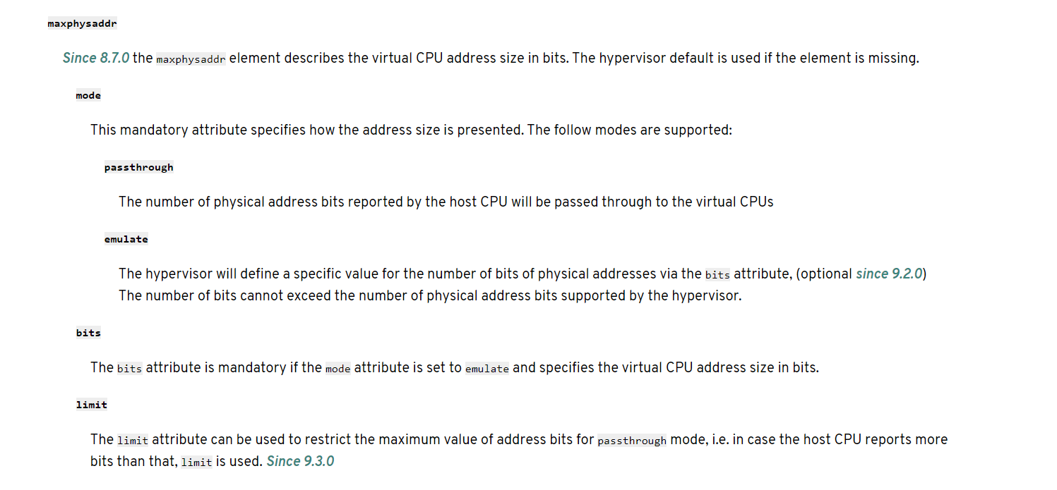

I started looking at this thread, Not sure if you what to try this option?
https://github.com/tianocore/edk2/discussions/4662
Currently on 6.12.8 we are running 8.7.0 Libvirt
You should be able to add the maxphysaddr to the xml, and looks like it remains persistant. The limit options is currently not supported but may be on a new point release where libvirt may be bumped up.
    <topology sockets='1' dies='1' cores='1' threads='2'/>
    <cache mode='passthrough'/>
    <maxphysaddr mode='passthrough'/>
  </cpu>
So I gave it a try and implemented the "<maxphysaddr mode='passthrough'/>" and it WORKED for a few days for the Truenas VM !!

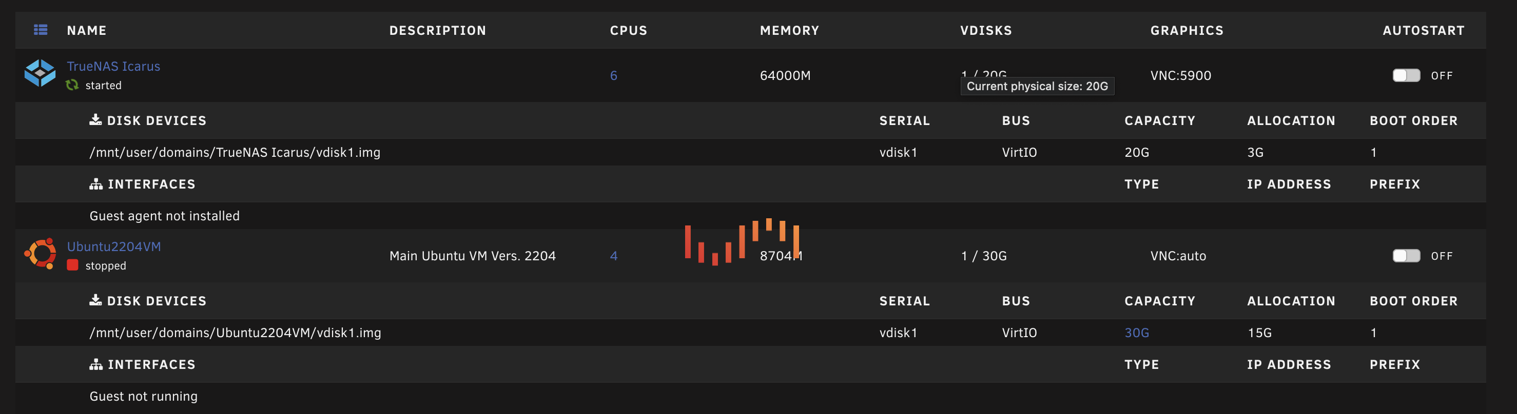

I also added the two xmls of the VMs, the SOUNDCARD is passed through, so that's not the problem : P

<cpu mode='custom' match='exact' check='none'>
    <model name='Cascadelake-Server'/>
    <topology sockets='1' dies='1' cores='6' threads='1'/>
</cpu>
However this initial xml entry was changed automatically by Unraid to:
<cpu mode='custom' match='exact' check='full'>
    <model fallback='forbid'>qemu64</model>
    <feature policy='require' name='x2apic'/>
    <feature policy='require' name='hypervisor'/>
    <feature policy='require' name='lahf_lm'/>
    <feature policy='disable' name='svm'/>
  </cpu>
I don't know, if the automatic change was set by Unraid or the switch between XML and form view and I also don't know if the XML change reverted anything but it works for me right now and the system is now error free for 3 weeks and the log is clean since then 🥳

Freezing Unraid UI:
So this was automatically resolved with the change of the xml and since there is no VFIO_DMA_MAP error, the UI never bugged out. But from my point of view this is definitely a UNRAID/qemu problem and not a user error, because from what I saw/think, a bugged out VM should not have such effects on the hypervisor even more so when the VM is initally running normally. If the hypervisor crashes with the VM and logs the error or kills the VM to protect system stability, that would be a behavior I could interpret. But if such an unconnected UI bug happens I would never have guessed that this is connected to something like CPU incompatibility ... I am not a developer and I really appreciate the work put into Unraid but this simple bug did cost me months, because it forced me to restart the hypervisor and it made troubleshooting a VM so much more painful !
System not SHUTTING down:
So this was my fault, because I implemented ugly start & stop user scripts, that mount and unmount shares of the NAS vm and the NFS shares weren't actually unmounted properly ... oops :D well what helped here is correcting the user scripts and using the plugin "Tips and Tweaks" to shut down any opened consoles. Anyway it feels weird, that Unraid is not suceeding a force shutdown just because a NFS was buggy during unmount. Any tips here for a global unmount would be appreciated, I still add them manually into a user script that looks something like this:
#!/bin/bash
sleep 150		# Wait for TrueNAS boot
mkdir /mnt/remotes/mnt01...
mkdir /mnt/remotes/mnt02...
mkdir /mnt/remotes/mnt03...
mount -t nfs 192.168.0... /mnt/remotes/mnt01...
mount -t nfs 192.168.0... /mnt/remotes/mnt02...
mount -t cifs -o username=...,password=... //192.168.0.... /mnt/remotes/mnt03...
docker start *dockername* # delayed docker that depend on NAS
Same goes for unmounting. The user scripts are then set to be either executed on startup or shutdown ... works the best for me.
