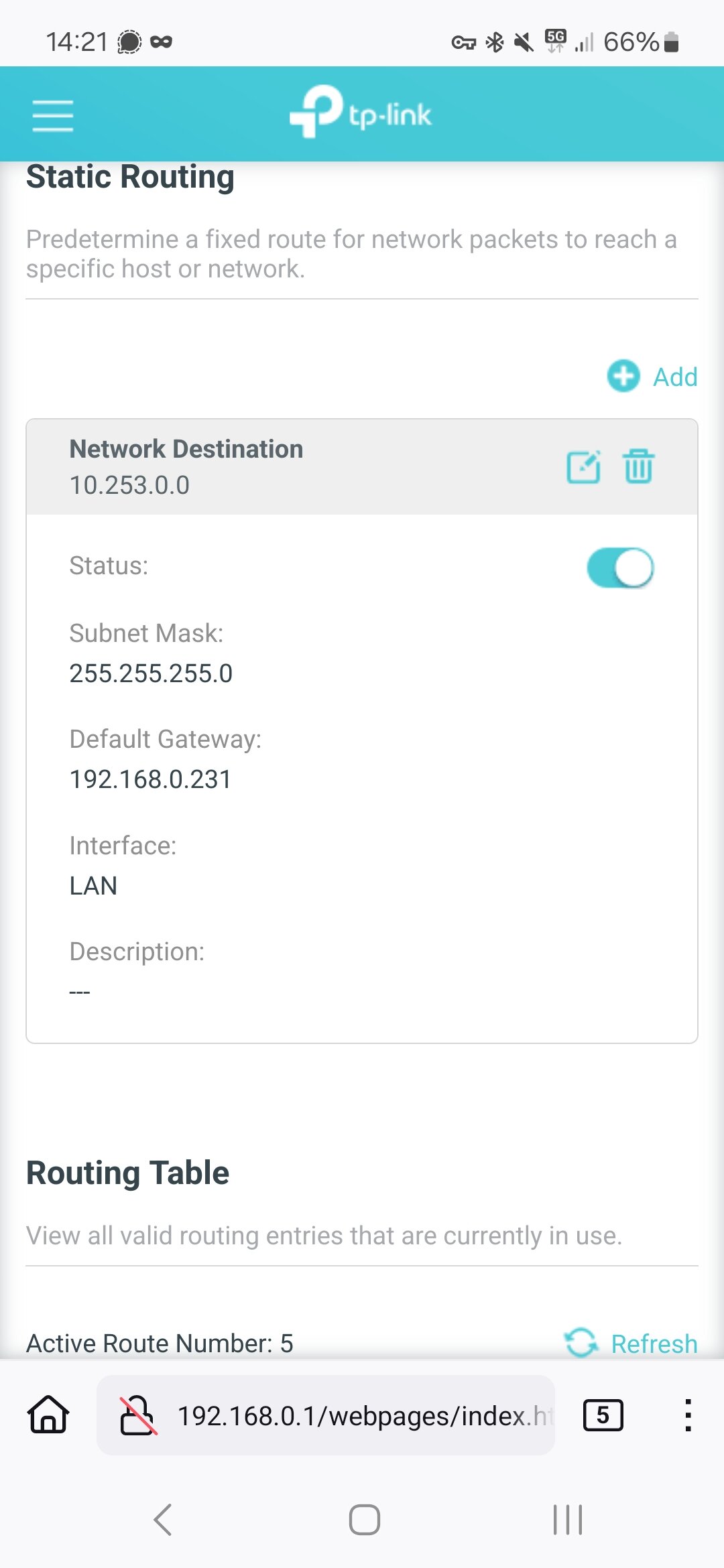

  1. @Mainfrezzer Works just fine with the Ubiquiti Ultra router. Guess the TP-Link AX6000 just doesnt know how static routing works.

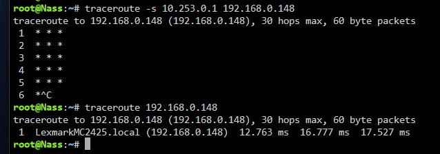

  3. I actually have that enabled. Honestly no clue. The weird part is that you could reach your router but nothing else but unraid was able to reach everything over the interface. thats just confusing hella confusing. The weird part is also that I was able to traceroute from client device to wirguard peer just fine and also from 10.253.0.1 to the client device, but just with the traceroute -s flag, pings with wg0 as Interface didn't go through. My assumption currently is that the router somehow blocks certain connections or doesn't proper routing across subsets. I want to try this with a different router, but I don't have one at hand. I don't really know where to go from here.

  5. Is it? My java developer mind doesn't compute haha. Am I right with the assumption that this means that the router doesn't do the static route properly?

  13. routes on unraid host: default via 10.253.0.1 dev wg0 table 200 192.168.0.0/24 via 192.168.0.1 dev br0 table 200 default via 192.168.0.1 dev shim-br0 default via 192.168.0.1 dev br0 proto dhcp src 192.168.0.231 metric 1005 10.253.0.2 dev wg0 scope link 10.253.0.3 dev wg0 scope link 10.253.0.5 dev wg0 scope link 172.17.0.0/16 dev docker0 proto kernel scope link src 172.17.0.1 172.31.200.0/24 dev br-77d5195ff5fd proto kernel scope link src 172.31.200.1 linkdown 192.168.0.0/24 dev shim-br0 proto kernel scope link src 192.168.0.231 192.168.0.0/24 dev br0 proto dhcp scope link src 192.168.0.231 metric 1005 local 10.253.0.1 dev wg0 table local proto kernel scope host src 10.253.0.1 local 127.0.0.0/8 dev lo table local proto kernel scope host src 127.0.0.1 local 127.0.0.1 dev lo table local proto kernel scope host src 127.0.0.1 broadcast 127.255.255.255 dev lo table local proto kernel scope link src 127.0.0.1 local 172.17.0.1 dev docker0 table local proto kernel scope host src 172.17.0.1 broadcast 172.17.255.255 dev docker0 table local proto kernel scope link src 172.17.0.1 local 172.31.200.1 dev br-77d5195ff5fd table local proto kernel scope host src 172.31.200.1 broadcast 172.31.200.255 dev br-77d5195ff5fd table local proto kernel scope link src 172.31.200.1 linkdown local 192.168.0.231 dev br0 table local proto kernel scope host src 192.168.0.231 local 192.168.0.231 dev shim-br0 table local proto kernel scope host src 192.168.0.231 broadcast 192.168.0.255 dev br0 table local proto kernel scope link src 192.168.0.231 broadcast 192.168.0.255 dev shim-br0 table local proto kernel scope link src 192.168.0.231

  15. Thought maybe a tcpdump helps: From shim-br0: root@Nass:~# tcpdump -i any icmp and dst 192.168.0.118 tcpdump: data link type LINUX_SLL2 tcpdump: verbose output suppressed, use -v[v]... for full protocol decode listening on any, link-type LINUX_SLL2 (Linux cooked v2), snapshot length 262144 bytes 23:05:28.366855 shim-br0 Out IP 192.168.0.231 > 192.168.0.118: ICMP echo request, id 56359, seq 1, length 64 23:05:28.366864 br0 Out IP 192.168.0.231 > 192.168.0.118: ICMP echo request, id 56359, seq 1, length 64 23:05:28.366878 eth0 Out IP 192.168.0.231 > 192.168.0.118: ICMP echo request, id 56359, seq 1, length 64 From wg0: 23:06:48.243116 wg0 Out IP 10.253.0.1 > 192.168.0.118: ICMP echo request, id 44344, seq 1, length 64

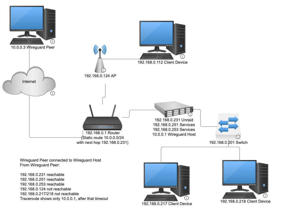

  16. The clients are all different devices, from printer to pc to laptop. All pingable, just not when connected to wireguard. I wish I could somehow debug where exactly my packets go to and end at and why they end there.

  18. [Interface] #NassVPN PrivateKey=x Address=10.253.0.1 ListenPort=51820 PostUp=logger -t wireguard 'Tunnel WireGuard-wg0 started';/usr/local/emhttp/webGui/scripts/update_services PostDown=logger -t wireguard 'Tunnel WireGuard-wg0 stopped';/usr/local/emhttp/webGui/scripts/update_services PostUp=ip -4 route flush table 200 PostUp=ip -4 route add default via 10.253.0.1 dev wg0 table 200 PostUp=ip -4 route add 192.168.0.0/24 via 192.168.0.1 dev br0 table 200 PostDown=ip -4 route flush table 200 PostDown=ip -4 route add unreachable default table 200 PostDown=ip -4 route add 192.168.0.0/24 via 192.168.0.1 dev br0 table 200 [Peer] #FayeAndroid PublicKey=x PresharedKey=x AllowedIPs=10.253.0.2
