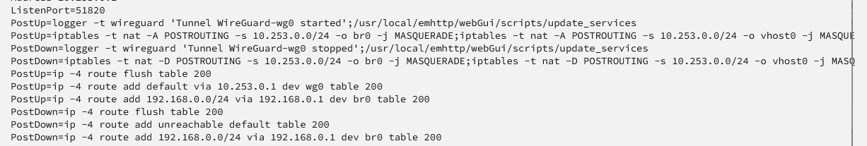

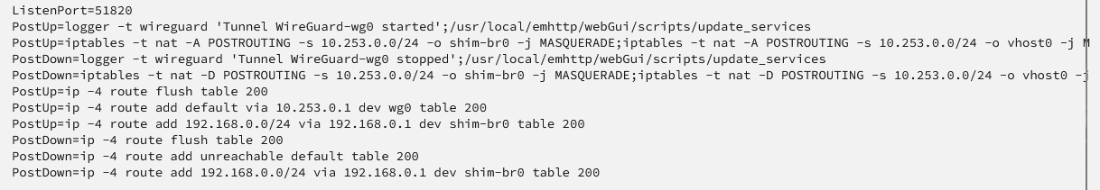

  7. Where is the config file even located so I can edit it directly?

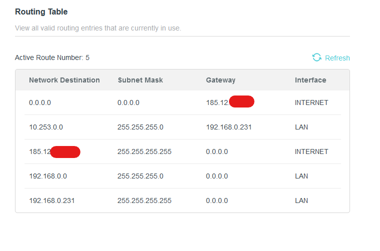

  8. It doesn't. (Traceroute still stops at 10.253.0.1) Changed to NAT = Yes. Now config is:
  9. All routes on router for completion sake:
  10. Oooh, we had some miscommunication. Treat 10.0.0.6 like 10.0.0.2. I just tested this from a different device as 10.0.0.2 is my phone. The same problem persists with that one.
