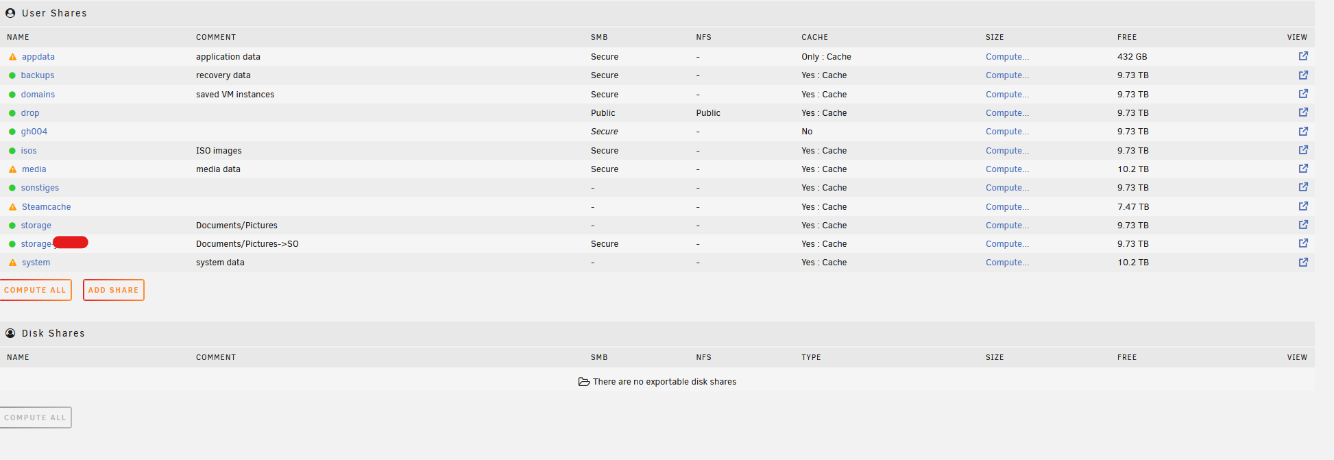

  6. Hello Unraid -Community, I feel kind of stupid to even ask this question because I read a lot of threads with the same title but for the love of god I cant figure out whats wrong with my setup. The Problem is in the title.... for a "long" time now I saw the "Some or all Files unprotected" warning and when I started the Mover to check if the Files will be moved from the Cache Drive to the Array nothing happens. I know that this is normal for my appdata share since it is supposed to stay exclusively on the Cache Drive but the others I dont understand. Other then some Posts about a Bug where this shows up without any Cache Drive in the System (from 2015) and a possible missconfiguration of the Cache Usage I couldnt find any Source for this Problem. Thanks in advance!
