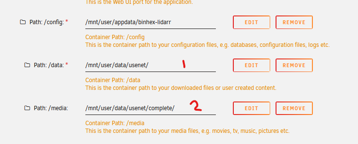

I created a wholly new share /downloads and set Sabnzbd to download to that new share. Seems to have fixed it, maybe because both downloads and the media library were on the same data share. Didn't have that problem in the past - but it seems to be working now, so very good - thanks. Just got to check its all working, then restart the VM for HA. I think the mover is working correctly too, files that were downloaded to the cache seem to have been moved over to the array overnight.

Classic 'a little bit of knowledge is a dangerous thing' error there. All the arrs give the exact same error. Well that would make sense! Changed the /config path to appdata docker run -d --name='sabnzbd' --net='bridge' --pids-limit 2048 -e TZ="Pacific/Auckland" -e HOST_OS="Unraid" -e HOST_HOSTNAME="Tower" -e HOST_CONTAINERNAME="sabnzbd" -e 'PRIVOXY_ENABLED'='false' -e 'UNBOUND_ENABLED'='false' -e 'VPN_ENABLED'='false' -e 'VPN_CONF'='wg0' -e 'VPN_PROVIDER'='generic' -e 'VPN_LAN_NETWORK'='' -e 'VPN_EXPOSE_PORTS_ON_LAN'='' -e 'VPN_AUTO_PORT_FORWARD'='true' -e 'VPN_AUTO_PORT_FORWARD_TO_PORTS'='' -e 'VPN_KEEP_LOCAL_DNS'='false' -e 'VPN_FIREWALL_TYPE'='auto' -e 'VPN_PIA_USER'='' -e 'VPN_PIA_PASS'='' -e 'VPN_PIA_PREFERRED_REGION'='' -e 'VPN_PIA_DIP_TOKEN'='no' -e 'VPN_PIA_PORT_FORWARD_PERSIST'='false' -e 'PUID'='99' -e 'PGID'='100' -e 'UMASK'='002' -l net.unraid.docker.managed=dockerman -l net.unraid.docker.webui='http://[IP]:[PORT:8080]' -l net.unraid.docker.icon='' -p '8080:8080/tcp' -v '/mnt/cache/appdata/sabnzbd/':'/config':'rw' -v '/mnt/user/data/':'/data':'rw' --hostname=sabnzbd.internal --cap-add=NET_ADMIN --sysctl="net.ipv4.conf.all.src_valid_mark=1" --sysctl="net.ipv6.conf.all.disable_ipv6=1" 'ghcr.io/hotio/sabnzbd:latest' 316ebf06c2cd887bdf0fb2f1e90049af4745d4eb341d1b0427d836f0344d7dac The command finished successfully!

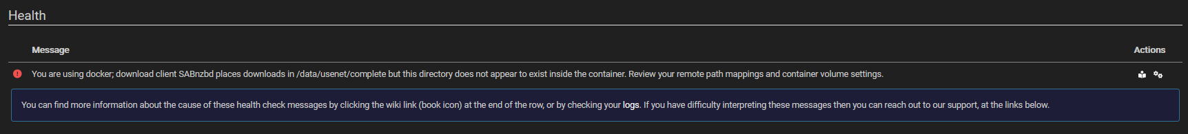

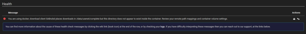

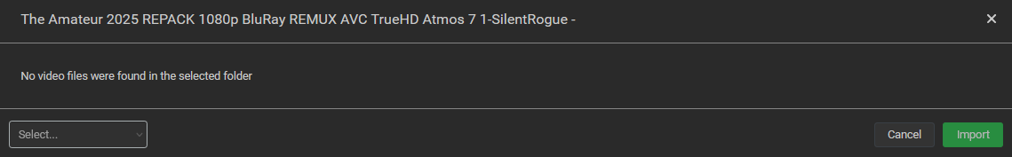

Do you know your way around the arr suite and sabnzbd - I am getting an error (which I have received before) across the arr suite related to folder / share access but last time i was able to fix it by correctly setting up my categories in sabnzbd. This fix is not working this time. So I have my arr suite share access set up like this, where 1 is my library in /usenet/media/movies etc and 2 is where sabnzbd downloads files to usenet/complete/movies etc using the relevant categories The descriptions are now making me second guess - is /data for my library and /media for newly downloaded files to be renamed and moved to my library, or is it the other way round? Sabnzbd is setup like this This is manifesting by the arr suite being unable to find the downloaded media - they can access my library just fine, but downloaded media folders look empty to the arr suite - so they cannot import and rename new media. Sab downloads okay, but arr only sees an empty folder in usenet/complete/movies - if i browse to the folder the media file is there. I've tried every variation to the /media Path I can think of, going higher or lower in the path, but nothing will make it work. Prior to the rebuild I had this error, but setting up my categories in sab seemed to fix it. Any ideas of what I should change on these two paths? Spent a couple of hours pulling my hair out here. The Arr documentation is just confusing me further.

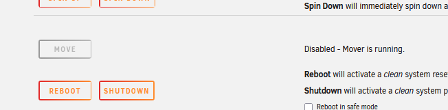

Mover settings done Invoked mover, but didn't really seem to do much, just refreshed the GUI and the mover button wasn't greyed out and no mover is running info, but the appropriate shares seem to be on the cache and navigating into the appdata folders shows the application's data. Cache increased from 3Gb to 8Gb - so looking good - but just seemed to move instantly which was weird. New diags attached diagnostics-180126.zip

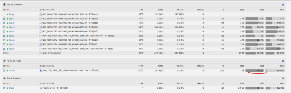

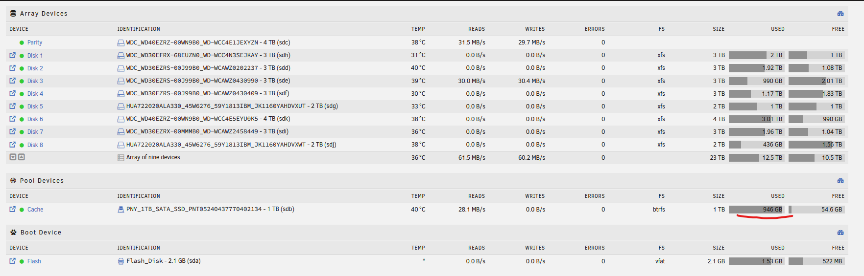

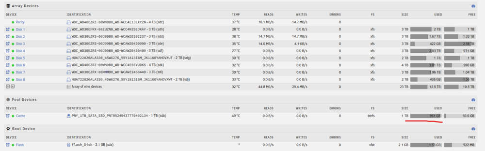

Took all day and night, but mover finished, and all but 3GB moved off of the cache. Back to normal. Really happy. Next steps? New diags attached. Diagnostics-180125.zip

Seeme to be moving files off the cache - you'll see the immediate reduction in size. Seems to be continuously reducing!

Worked from console. Mover stopped - great. Can't recall if I rebooted - so tried and it wouldn't actually restart, just seemed to refresh the GUI. Either that or it restarted in one minute. Very strange. Have performed a full shutdown (took 20 mins to shutdown - guessing because of the full cache?) and restarted the array. New diags attached. Should i retry the mover? tower-diagnostics-170126.zip

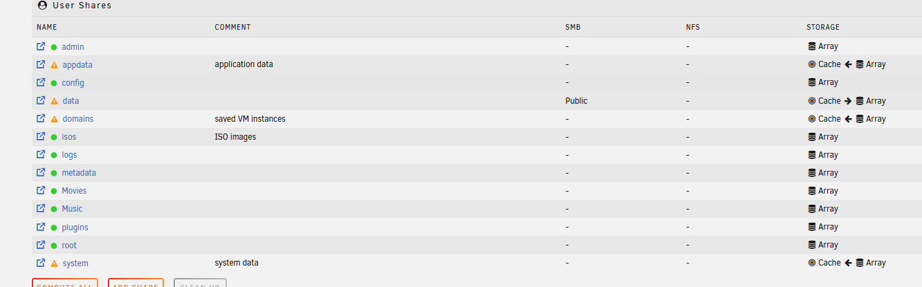

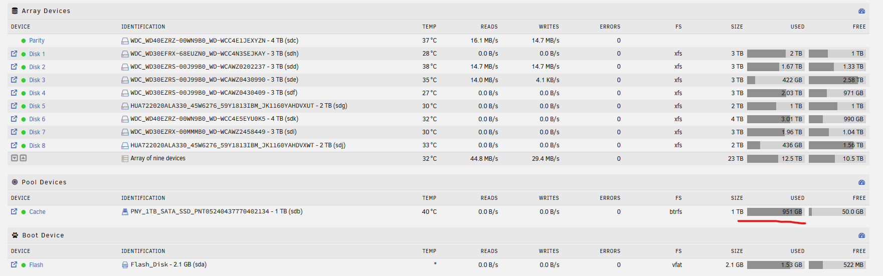

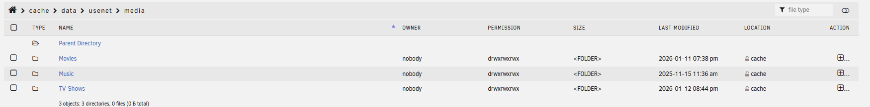

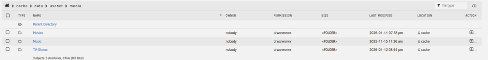

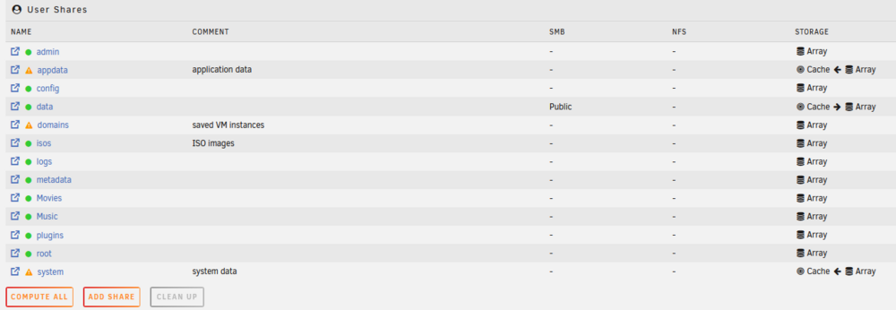

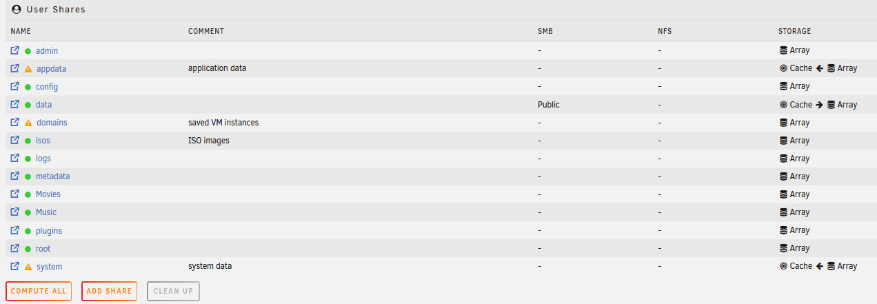

Hey mate - so something is going wrong, my cache has filled back up to 95% and I am getting warning notifications - seems to have moved a bunch of my media files over from the array (where they should be) to the cache? The media files are in the data share data/usenet/media/complete/movies etc. I noticed as I can't install any more apps (or access the apps menu in the GUI) as the cache is all but full. This is pretty much exactly what was happening before the SSD died and why I had moved everything more or less to the array. New diags attached. Did I just dumb ass set some of these cache-arrays settings wrong on the shares? So far I haven't even configured any of the apps i just installed to the docker. Edit - mover appears to be running too. tower-diagnostics-160125.zip

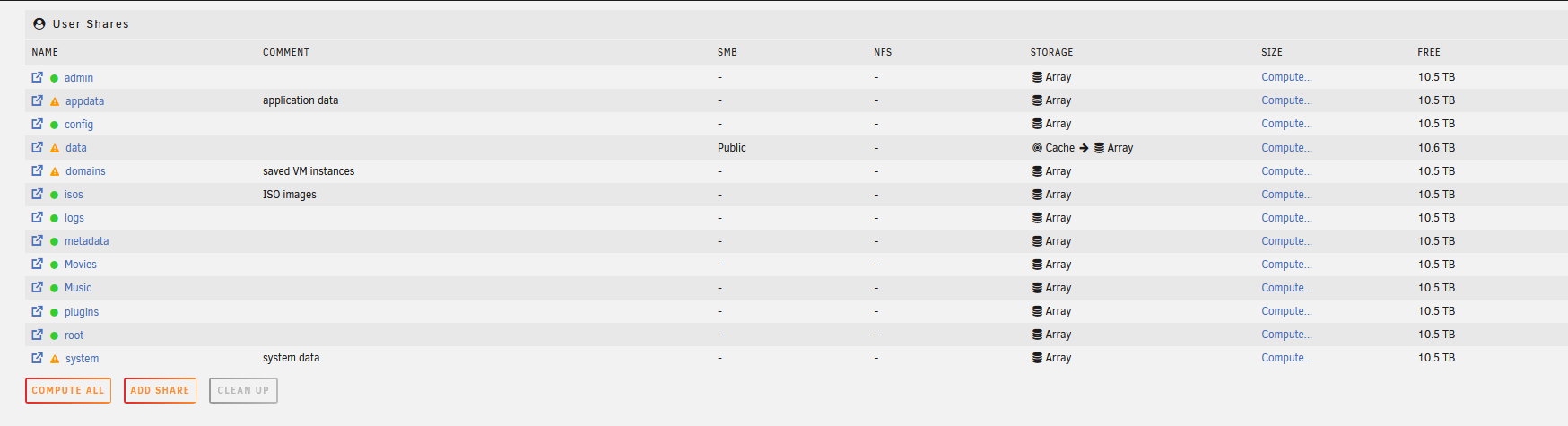

Docker settings updated. Diagnostics attached. Can I go ahead and reinstall my apps? Will not reinstall legacy apps. tower-diagnostics-150126.zip

So what's next for the docker and VM? New diagnostics attached. tower-diagnostics-140126.zip
