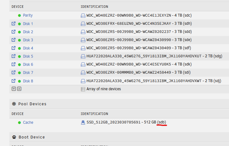

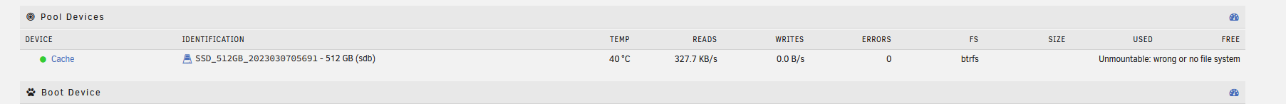

Did my SSD / Cache drive just die? Moved to read-only and unassigned, filesystem status not a regular device
So apps stopped working one by one today, so I jumped into main to take a look - and my cache / SSD has been moved to read only and to unassigned devices, though still shows as cache. See attached screenie. I have rebooted with no discernible change (and restarted the array). I have since moved the array to maintenance mode and tried check filesystem status - just receiving the following error -
ERROR: not a regular file or block device: /dev/ ERROR: cannot open file system Opening filesystem to check...

It wasn't the world's greatest SSD - so it could be corrupt or dead - but to note, it wasn't heavily used as for whatever reason I couldn't get arr suite to download to the cache and the automatic mover to move the files to the array, (it just slowly filled up and I had to manually move to the array) so it wasn't heavily trafficked or used barely at all for many months.
Screenie of main and logs attached. Any help in a fix or confirmation of dead drive appreciated, I do have a brand new 1TB SSD ready to go.

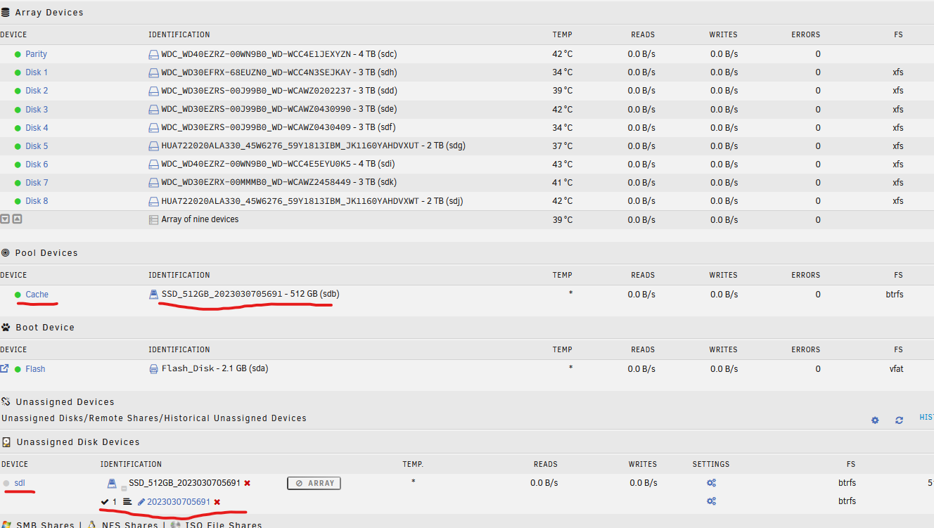

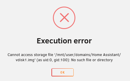

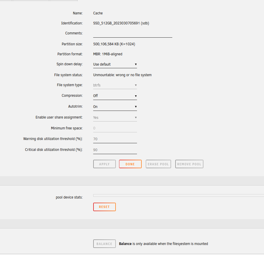

Reconnected the original cables, and it has removed the cache from unassigned devices now. So that is an improvement. But looks like all application data has been lost, and my VM won't start. See Screenies. Still getting the unmountable no File System error on the cache in main.
Attached - VM error, cache in main, cache details and exported logs following a reboot and restart of the array (not in maintenance mode).

See if a scrub will work on cache.

Results of the check filesystems attached - I am no expert but looks like a lot or errors there. Ran in maintenance mode.
Scrub wouldn't run - no btrfs drive mounted. Ran in normal mode.

SMART report for cache doesn't look that good. You should probably replace it.

According to your diagnostics, domains user share is all on disk3, and isn't configured to have anything on cache, so that is where I would expect your HA vdisk to be. Or did you have some of domains on cache and now it is gone? If it was ever on cache, just setting that share to not use cache wouldn't move it, it would just make it not put new files there.

Can you see your HA vdisk in the domains share? Or is it gone? Was that working while cache was working?
yeah everything was working fine (well good enough noting mover never worked) until the cache died and I posted this thread. I don't know how to look for the vdisk in a domains share. I just followed the space invader setup instructions - it worked and I have been using HA ever since.
