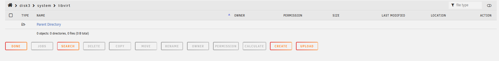

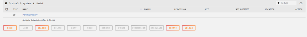

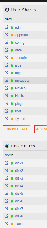

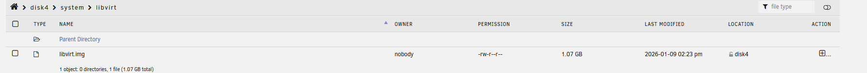

  18. So actually, the answer is no. Not to other user shares. Guess I didn't understand the question totally, I am bit woolly on what is defined as a user share or disk share vs. a folder. Is the definition of an individual share defined by it being created and listed in the share list? The movies and music shares are empty and unused. I should probs remove.
  19. Yeah but still within user/data - so sabnzbd is downloaded to user/data/usenet/incoming and then unpacked file added to user/data/usenet/complete then arr picks them up, renames and places in user/data/usenet/media - with corresponding subfolders (movies/TV-shows etc)
  20. Yes the full suite. And yes - i followed the pretty standard TRaSH guide and used the folder recommendations in there. Do I just setup user/data share as cache > array?
