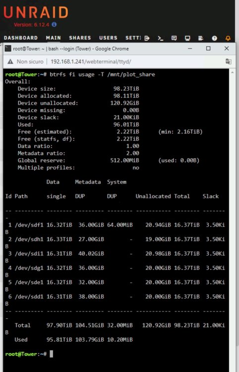

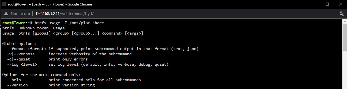

  14. Ok I'm freeing up 200GB of space. I tried running the command but it says: Am I doing something wrong?

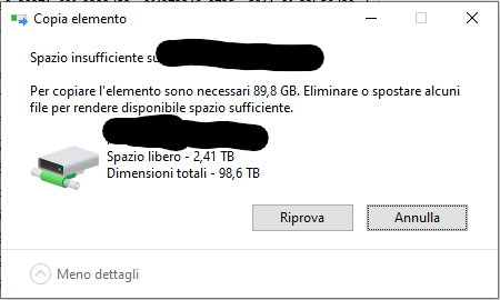

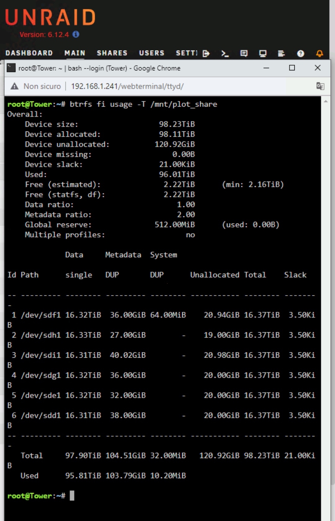

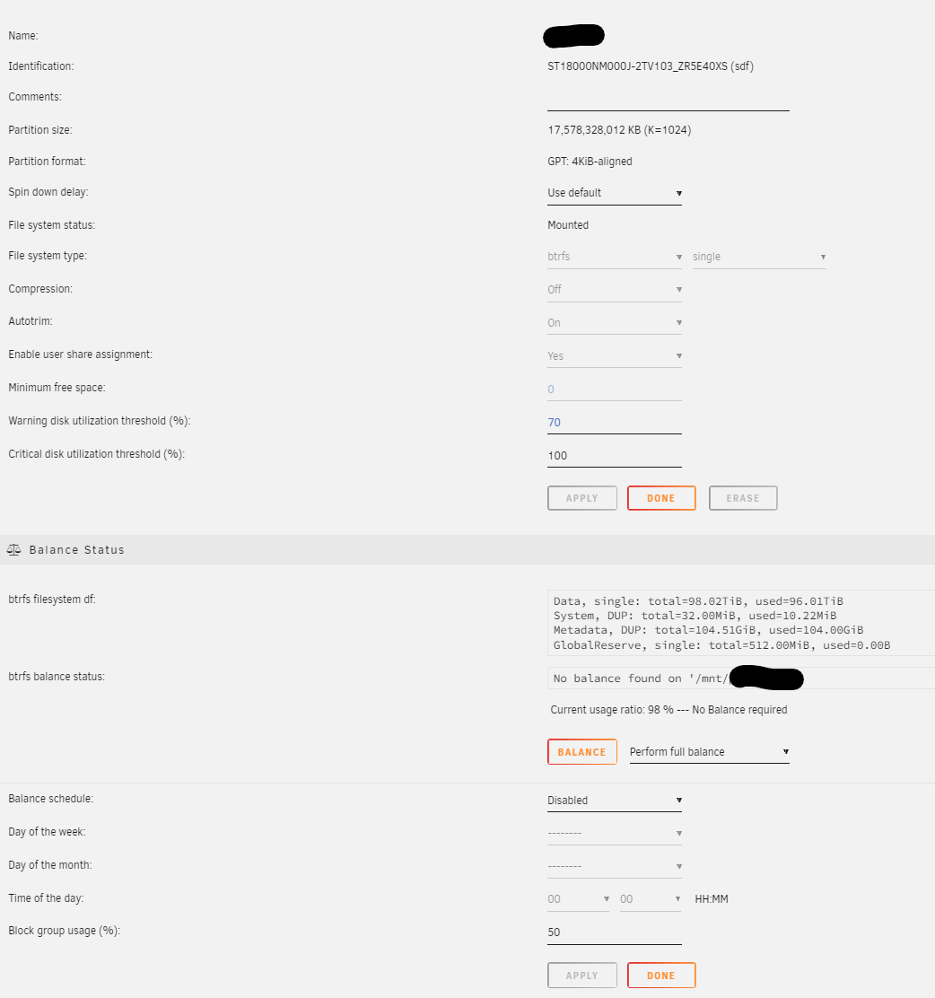

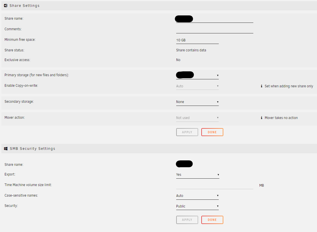

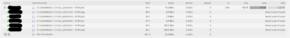

  16. Hello and sorry for my bad English. I have a problem with a share in a disk pool. The share is 108 TB and there are still 2.22 free but if I try to copy into it it tells me that the space is full. I've already tried balancing and scrubbing without any success, and trying some settings. I leave you the diagnostic file attached. Thank you tower-diagnostics-20230911-1944.zip

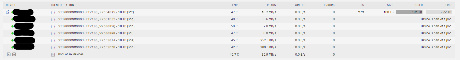

  18. Hi Jorge, Thank you. Even if I replace the broken hard drive with a new one? is this only possible in raid 5?

  20. Hello everyone and sorry for the bad english from google translate. I need some advice on configuring my pool's filesystem, it is currently set up like this: If 1 of the 6 disks fails, would I be able to restart the pool by replacing the broken disk and recovering the data on the remaining disks? I did some tests and I couldn't replace it, the pool didn't restart except with the same disk. Can someone smarter than me help me? Thank you
