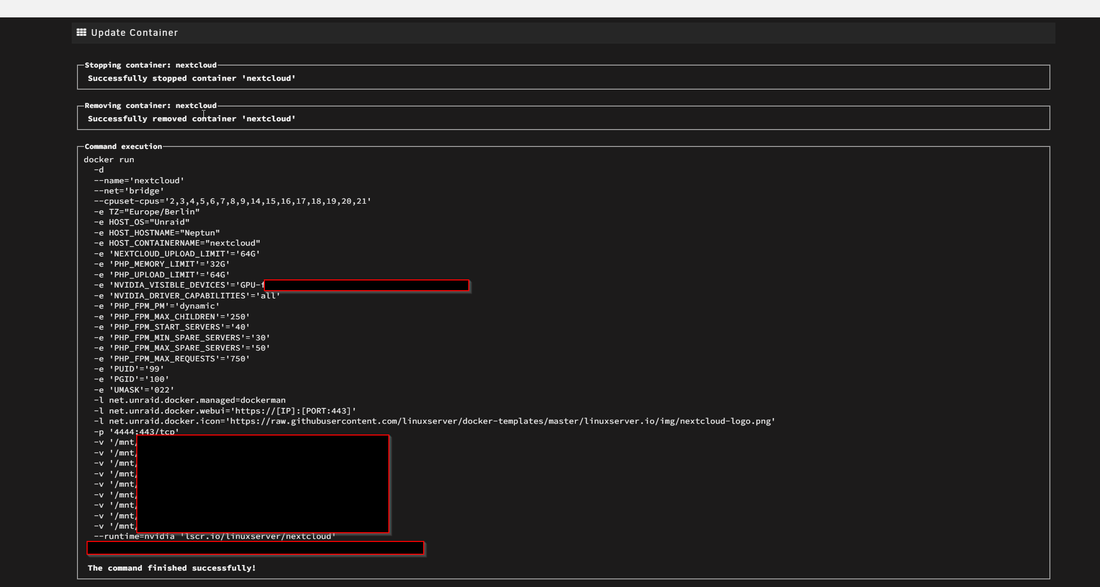

  1. Thank you. The parameter values we initially used were just a first suggestion from ChatGPT based on my setup, and they weren't guaranteed to be optimal. We agreed to start with these values and increase them if necessary, but in my case, they worked perfectly. Your optimal values may differ depending on your specific setup. During workloads, I recommend monitoring your memory consumption. If it's not too high, you can try increasing the values further. The default values were surprisingly small, and I'm not sure why they were set so low. Feel free to experiment and find the best configuration for your system!
  2. Optimizing Nextcloud Linuxserver.io Docker Performance I wanted to share my experience with the Nextcloud Linuxserver.io Docker container. After installation two years ago, I tried to optimize various parameters, including Nginx settings for Docker and several other tweaks like max_upload. These initial optimizations made Nextcloud usable, but I felt it wasn't performing to its full potential, especially considering it's installed on a powerful server (128GB RAM, only SSDs [4x U.2 + 3x M.2 NVMe], 10Gbit network, etc.). Recently, I decided to investigate how to improve speed and responsiveness. I finally found the key parameters for my setup, and now Nextcloud is lightning fast. It's almost unbelievable how quickly it works now - even faster than Windows. I want to share these parameters in case others want to try them out. Key PHP Parameters for Docker The most significant improvements came from adjusting the PHP-FPM settings within the Docker container itself: PHP_FPM_PM=dynamic (instead of ondemand) PHP_FPM_MAX_CHILDREN=250 (instead of 50) PHP_FPM_MAX_SERVERS=50 PHP_FPM_MIN_SERVERS=30 PHP_FPM_START_SERVERS=40 PHP_FPM_MAX_REQUEST=750 Additional Optimizations It's also crucial to optimize other areas: config.php: Configure Redis server, Memcache, MySQL database, etc. nginx.conf and php.ini: Ensure these are already optimized for your setup. Note that the PHP settings mentioned above are for the Docker container itself, not for Nginx. App Management Some apps, like occweb, can significantly slow down Nextcloud. I recommend deactivating all apps that you're not actively using. Conclusion Nextcloud settings for Unraid are among the most complex of any app, even more so than Unraid itself. However, once properly configured, it performs phenomenally well. After implementing these optimizations, I've seen remarkable improvements in performance: Upload speeds now reach around 600MB/s, fully utilizing my 10Gbit internet connection. The overall responsiveness of the Nextcloud interface has significantly improved, lightning fast after klick everyhting opens within ms (far less than a second) I hope this information helps. If you already knew these optimizations, that's great. Feel free to share any better settings that could yield even better results!
