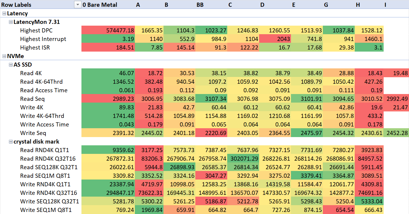

  6. I've tested some more configs relating to NVMe performance which significantly impacts gaming. A - Emulator Pin + IOThread B - CPU migratable = off C - HyperV off clock tsc D - memory <locked/> xmls A - Emulator Pin + IOThread <?xml version='1.0' encoding='UTF-8'?> <domain type='kvm'> <name>Windows 11 - default with io thread</name> <uuid>30e40a2a-558f-9113-b3ad-7030e96d9208</uuid> <metadata> <vmtemplate xmlns="unraid" name="Windows 11" icon="windows11.png" os="windowstpm"/> </metadata> <memory unit='KiB'>33554432</memory> <currentMemory unit='KiB'>33554432</currentMemory> <memoryBacking> <nosharepages/> </memoryBacking> <vcpu placement='static'>16</vcpu> <iothreads>1</iothreads> <cputune> <vcpupin vcpu='0' cpuset='2'/> <vcpupin vcpu='1' cpuset='12'/> <vcpupin vcpu='2' cpuset='3'/> <vcpupin vcpu='3' cpuset='13'/> <vcpupin vcpu='4' cpuset='4'/> <vcpupin vcpu='5' cpuset='14'/> <vcpupin vcpu='6' cpuset='5'/> <vcpupin vcpu='7' cpuset='15'/> <vcpupin vcpu='8' cpuset='6'/> <vcpupin vcpu='9' cpuset='16'/> <vcpupin vcpu='10' cpuset='7'/> <vcpupin vcpu='11' cpuset='17'/> <vcpupin vcpu='12' cpuset='8'/> <vcpupin vcpu='13' cpuset='18'/> <vcpupin vcpu='14' cpuset='9'/> <vcpupin vcpu='15' cpuset='19'/> <emulatorpin cpuset='1,11'/> <iothreadpin iothread='1' cpuset='1,11'/> </cputune> <os> <type arch='x86_64' machine='pc-i440fx-7.2'>hvm</type> <loader readonly='yes' type='pflash'>/usr/share/qemu/ovmf-x64/OVMF_CODE-pure-efi-tpm.fd</loader> <nvram>/etc/libvirt/qemu/nvram/30e40a2a-558f-9113-b3ad-7030e96d9208_VARS-pure-efi-tpm.fd</nvram> </os> <features> <acpi/> <apic/> <hyperv mode='custom'> <relaxed state='on'/> <vapic state='on'/> <spinlocks state='on' retries='8191'/> <vendor_id state='on' value='none'/> </hyperv> </features> <cpu mode='host-passthrough' check='none' migratable='on'> <topology sockets='1' dies='1' cores='8' threads='2'/> <cache mode='passthrough'/> </cpu> <clock offset='localtime'> <timer name='hypervclock' present='yes'/> <timer name='hpet' present='no'/> </clock> B - CPU migratable = off <?xml version='1.0' encoding='UTF-8'?> <domain type='kvm'> <name>Windows 11 - default with io thread</name> <uuid>30e40a2a-558f-9113-b3ad-7030e96d9208</uuid> <metadata> <vmtemplate xmlns="unraid" name="Windows 11" icon="windows11.png" os="windowstpm"/> </metadata> <memory unit='KiB'>33554432</memory> <currentMemory unit='KiB'>33554432</currentMemory> <memoryBacking> <nosharepages/> </memoryBacking> <vcpu placement='static'>16</vcpu> <iothreads>1</iothreads> <cputune> <vcpupin vcpu='0' cpuset='2'/> <vcpupin vcpu='1' cpuset='12'/> <vcpupin vcpu='2' cpuset='3'/> <vcpupin vcpu='3' cpuset='13'/> <vcpupin vcpu='4' cpuset='4'/> <vcpupin vcpu='5' cpuset='14'/> <vcpupin vcpu='6' cpuset='5'/> <vcpupin vcpu='7' cpuset='15'/> <vcpupin vcpu='8' cpuset='6'/> <vcpupin vcpu='9' cpuset='16'/> <vcpupin vcpu='10' cpuset='7'/> <vcpupin vcpu='11' cpuset='17'/> <vcpupin vcpu='12' cpuset='8'/> <vcpupin vcpu='13' cpuset='18'/> <vcpupin vcpu='14' cpuset='9'/> <vcpupin vcpu='15' cpuset='19'/> <emulatorpin cpuset='1,11'/> <iothreadpin iothread='1' cpuset='1,11'/> </cputune> <os> <type arch='x86_64' machine='pc-i440fx-7.2'>hvm</type> <loader readonly='yes' type='pflash'>/usr/share/qemu/ovmf-x64/OVMF_CODE-pure-efi-tpm.fd</loader> <nvram>/etc/libvirt/qemu/nvram/30e40a2a-558f-9113-b3ad-7030e96d9208_VARS-pure-efi-tpm.fd</nvram> </os> <features> <acpi/> <apic/> <hyperv mode='custom'> <relaxed state='on'/> <vapic state='on'/> <spinlocks state='on' retries='8191'/> <vendor_id state='on' value='none'/> </hyperv> </features> <cpu mode='host-passthrough' check='none' migratable='off'> <topology sockets='1' dies='1' cores='8' threads='2'/> <cache mode='passthrough'/> </cpu> <clock offset='localtime'> <timer name='hypervclock' present='yes'/> <timer name='hpet' present='no'/> </clock> C - HyperV off clock tsc <?xml version='1.0' encoding='UTF-8'?> <domain type='kvm'> <name>Windows 11 - default with io thread</name> <uuid>30e40a2a-558f-9113-b3ad-7030e96d9208</uuid> <metadata> <vmtemplate xmlns="unraid" name="Windows 11" icon="windows11.png" os="windowstpm"/> </metadata> <memory unit='KiB'>33554432</memory> <currentMemory unit='KiB'>33554432</currentMemory> <memoryBacking> <nosharepages/> </memoryBacking> <vcpu placement='static'>16</vcpu> <iothreads>1</iothreads> <cputune> <vcpupin vcpu='0' cpuset='2'/> <vcpupin vcpu='1' cpuset='12'/> <vcpupin vcpu='2' cpuset='3'/> <vcpupin vcpu='3' cpuset='13'/> <vcpupin vcpu='4' cpuset='4'/> <vcpupin vcpu='5' cpuset='14'/> <vcpupin vcpu='6' cpuset='5'/> <vcpupin vcpu='7' cpuset='15'/> <vcpupin vcpu='8' cpuset='6'/> <vcpupin vcpu='9' cpuset='16'/> <vcpupin vcpu='10' cpuset='7'/> <vcpupin vcpu='11' cpuset='17'/> <vcpupin vcpu='12' cpuset='8'/> <vcpupin vcpu='13' cpuset='18'/> <vcpupin vcpu='14' cpuset='9'/> <vcpupin vcpu='15' cpuset='19'/> <emulatorpin cpuset='1,11'/> <iothreadpin iothread='1' cpuset='1,11'/> </cputune> <os> <type arch='x86_64' machine='pc-i440fx-7.2'>hvm</type> <loader readonly='yes' type='pflash'>/usr/share/qemu/ovmf-x64/OVMF_CODE-pure-efi-tpm.fd</loader> <nvram>/etc/libvirt/qemu/nvram/30e40a2a-558f-9113-b3ad-7030e96d9208_VARS-pure-efi-tpm.fd</nvram> </os> <features> <acpi/> <apic/> </features> <cpu mode='host-passthrough' check='none' migratable='off'> <topology sockets='1' dies='1' cores='8' threads='2'/> <cache mode='passthrough'/> </cpu> <clock offset='localtime'> <timer name='hypervclock' present='no'/> <timer name='hpet' present='no'/> <timer name='tsc' present='yes' mode='native'/> </clock> D - memory <locked/> <?xml version='1.0' encoding='UTF-8'?> <domain type='kvm'> <name>Windows 11 - default with io thread</name> <uuid>30e40a2a-558f-9113-b3ad-7030e96d9208</uuid> <metadata> <vmtemplate xmlns="unraid" name="Windows 11" icon="windows11.png" os="windowstpm"/> </metadata> <memory unit='KiB'>33554432</memory> <currentMemory unit='KiB'>33554432</currentMemory> <memoryBacking> <locked/> <nosharepages/> </memoryBacking> <vcpu placement='static'>16</vcpu> <iothreads>1</iothreads> <cputune> <vcpupin vcpu='0' cpuset='2'/> <vcpupin vcpu='1' cpuset='12'/> <vcpupin vcpu='2' cpuset='3'/> <vcpupin vcpu='3' cpuset='13'/> <vcpupin vcpu='4' cpuset='4'/> <vcpupin vcpu='5' cpuset='14'/> <vcpupin vcpu='6' cpuset='5'/> <vcpupin vcpu='7' cpuset='15'/> <vcpupin vcpu='8' cpuset='6'/> <vcpupin vcpu='9' cpuset='16'/> <vcpupin vcpu='10' cpuset='7'/> <vcpupin vcpu='11' cpuset='17'/> <vcpupin vcpu='12' cpuset='8'/> <vcpupin vcpu='13' cpuset='18'/> <vcpupin vcpu='14' cpuset='9'/> <vcpupin vcpu='15' cpuset='19'/> <emulatorpin cpuset='1,11'/> <iothreadpin iothread='1' cpuset='1,11'/> </cputune> <os> <type arch='x86_64' machine='pc-i440fx-7.2'>hvm</type> <loader readonly='yes' type='pflash'>/usr/share/qemu/ovmf-x64/OVMF_CODE-pure-efi-tpm.fd</loader> <nvram>/etc/libvirt/qemu/nvram/30e40a2a-558f-9113-b3ad-7030e96d9208_VARS-pure-efi-tpm.fd</nvram> </os> <features> <acpi/> <apic/> </features> <cpu mode='host-passthrough' check='none' migratable='off'> <topology sockets='1' dies='1' cores='8' threads='2'/> <cache mode='passthrough'></cache> </cpu> <clock offset='localtime'> <timer name='hypervclock' present='no'/> <timer name='hpet' present='no'/> <timer name='tsc' present='yes' mode='native'/> </clock>

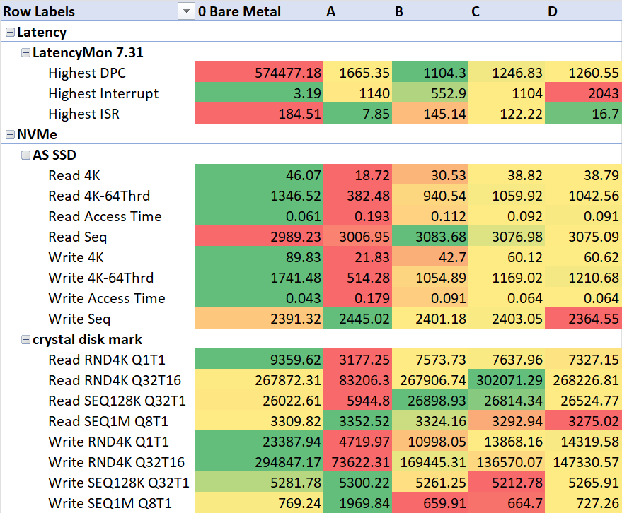

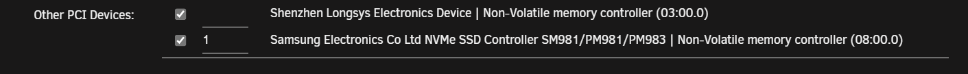

  7. I've been attempting to debug significant performance issues on my Windows 11 VM recently. After testing many configs I found the NVMe performance to degrade significantly from bare metal. Specifically, the Random IO. It seems to be directly related to interrupts and clock configuration. But I've tried just about every config option with varying results. CPU: Intel i7-10900k NVMe: Samsung 970 Evo The drive is passed through with IMMOU binding directly to the VM via PCIe. All CPUs are isolated and there is a emulatorPin While sequential read/writes are within acceptable ranges. Random access and latency are very poor. I'm curious if anyone can recreate these results. I checked the NVMe devices are using MSI which they seem to be, https://forums.guru3d.com/threads/windows-line-based-vs-message-signaled-based-interrupts-msi-tool.378044/ This is the best performing configuration. You can omit the hyperV options with similar results. But may as well have those there. <features> <acpi/> <apic/> </features> <cpu mode='host-passthrough' check='none' migratable='off'> <topology sockets='1' dies='1' cores='8' threads='2'/> <cache mode='passthrough'/> </cpu> <clock offset='localtime'> <timer name='rtc' present='no' tickpolicy='catchup'/> <timer name='pit' present='no' tickpolicy='delay'/> <timer name='hpet' present='no'/> <timer name='hypervclock' present='no'/> <timer name='tsc' present='yes' mode='native'/> </clock> ``` kernel /bzimage append acpi_enforce_resources=lax pcie_acs_override=downstream,multifunction video=efifb:off isolcpus=2-9,12-19 initrd=/bzroot ```

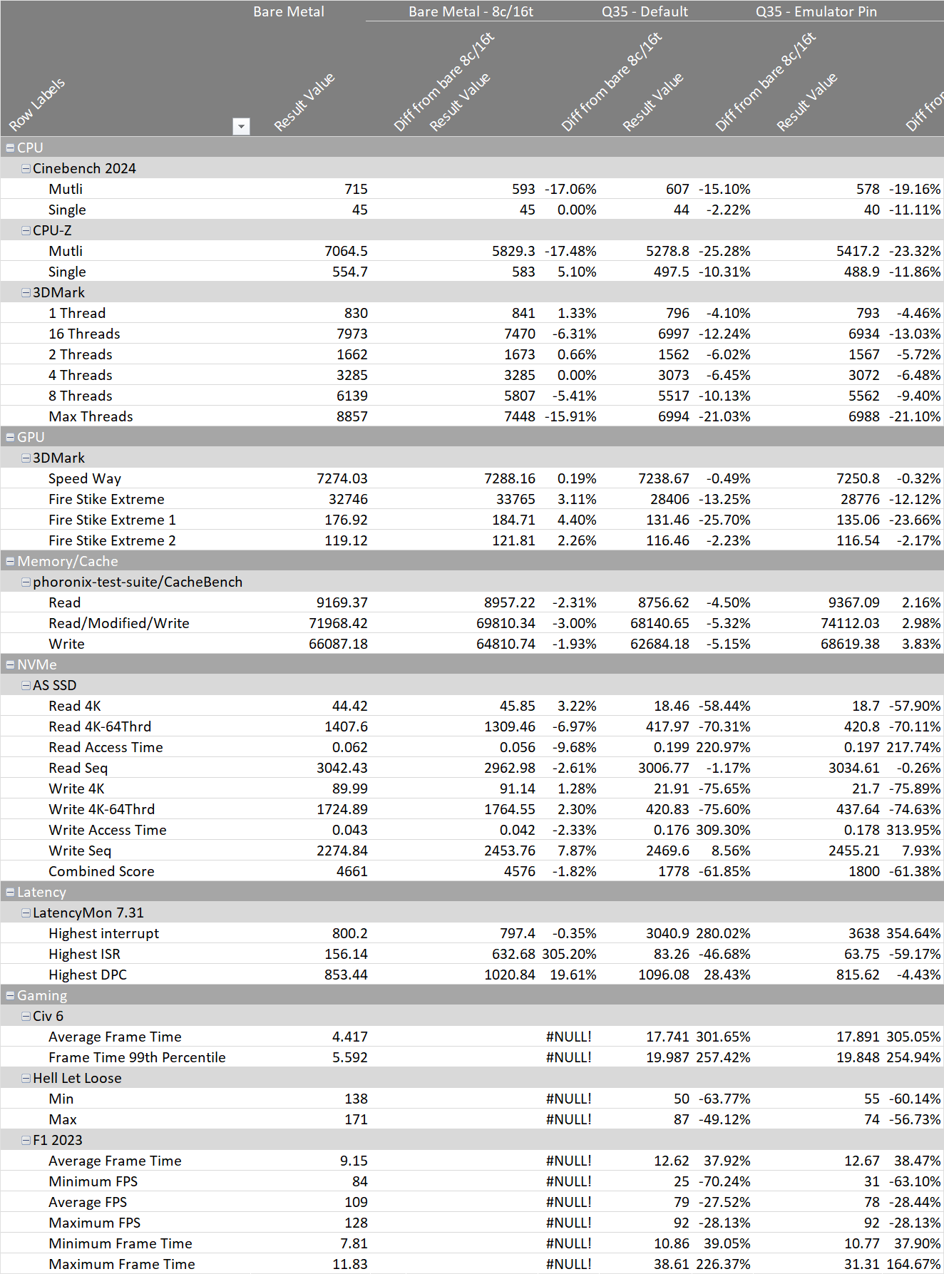

  8. I recently upgraded my GPU and noticed significant stuttering and lower than expected performance. After trying multiple flags for the KVM settings I've been unable to get anywhere near bare-metal performance. So, in my efforts, I've spent some time testing. I'll be capturing the performance of more configuration options. If you have any ideas to try let me know. I'll write up and share the full analysis, configs and so on when I've finished.
