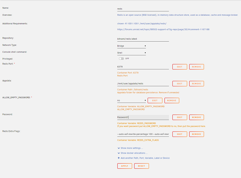

  4. @Kilrah What are you using for a back up solution?? I have appdata backup running daily, is that enough?

  7. 2 steps forward 1 back... I have redis running now but i am stuck in maintenance mode. After this redis would not run so I ran chown -R 1001:1001 /mnt/user/appdata/redis/ in the unraid terminal, now i have redis started but im stuck in maintenance mode...
  8. Nah im lost..... this is to far for me i think. After installing redis i lose access to NC, I'm assuming this is because redis wont run, and I assume that is because i need to run chown -R 1001:1001 Did you have to follow that step? if so can you explain how?
  9. Interesting.. My Redis version does not have the same options as yours (i.e. Password) and i cant find bitnami/redis. where did you find this container? Scratch the comment above.. I founf it by searching Bitnami and using the one that came up. Im now going to try and follow instructions to on the below to install Chown............ gotta love the rabbit hole
  10. Hello again, I have tried to install redis (docker) as you have i believe.. I installed the same container as you did here and didnt change anything, I pasted the text above and inserted my server address "192.186.0.5" for example and made up a password "Password01" for example. Nextcloud would not start.... I then added "redis-server --requirepass password" to the docker 'post arguments' as per suggestions in the quoted forum for redis... Would you mind giving me a tip? what am i missing here...?
