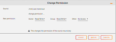

  18. great info!! thank you this will be super helpfull going forwared! however, it hasnt worked - this setup leaves me unable to log in. An if i have read/write access all then i have another error: "It was not possible to execute the cron job via CLI. The following technical errors have appeared: - Your data directory is not writable. Permissions can usually be fixed by giving the web server write access to the root directory"

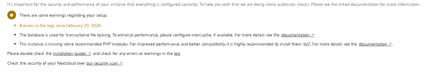

  20. Coming good - slowly getting through the errors.

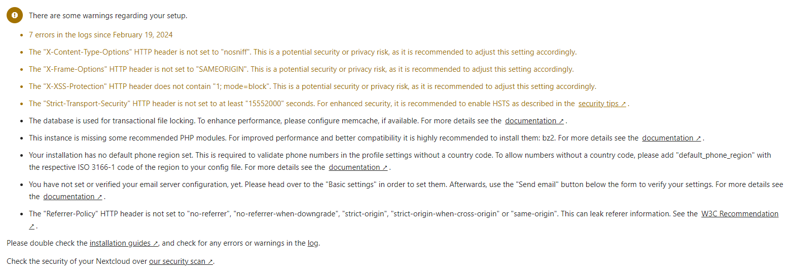

  21. So the first 4 i have fixed with adding # before each line, as below in my (nano /mnt/user/appdata/swag/nginx/proxy-confs/nextcloud.subdomain.conf) file Is that known as uncommenting the line? As for "The "Strict-Transport-Security" HTTP header is not set to at least "15552000" seconds." I cant find the below line in that conf file add_header Strict-Transport-Security "max-age=63072000;
  22. I have statred again and with some tips from Kilrah, i have managed to get up and running, i am just working through some errors... Kilrah responded to me on another post so i will update this post with all of my findingas after (hopefull) i get my install clean. BTW, thank you so much for your clear and patient tips!
  23. The first 4 warnings/errors probably all require changes to my webserver config file, but i cant for the life of me find out how to get to it...... I have only even found out about linux system this last year and plex/radarr/sonarr/overseerr are about the limit of my use cases so far. I literally have no idea what i am doing. I dont even know where to start learning so I am just going by trial and error.
