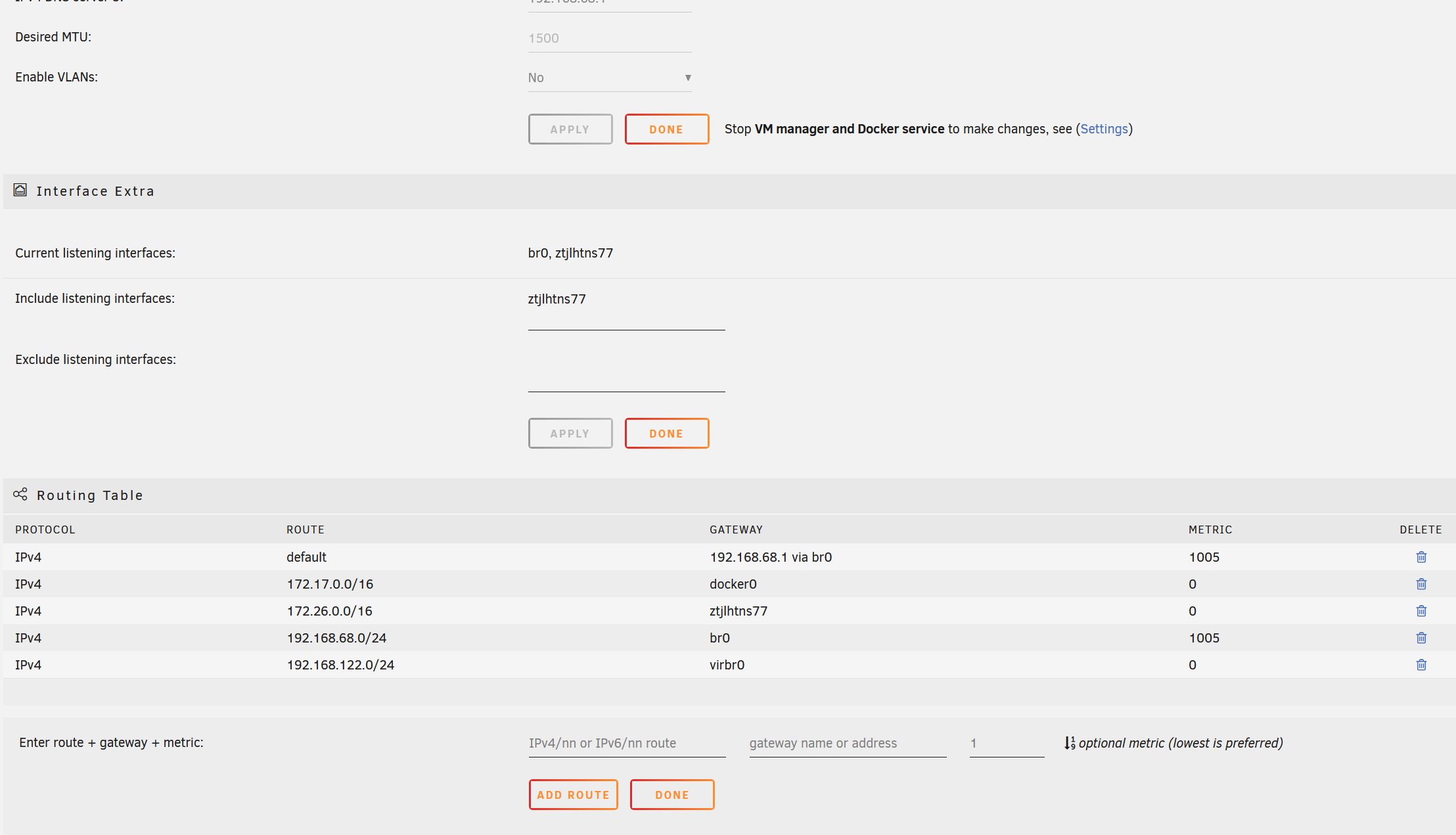

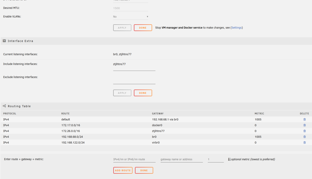

  2. I'm trying to setup zero tier to my unraid nas. I can ping the ip, and also access jellyfin running on the box. But if I try to access the gui it do not respond, and I can access the smb shares through the ip either. I read somewhere that I should add the interface to the "Include listening interfaces" but to no avail. ztjlhtns77 matches the ip-range of my zero tier ip. Is there something else I need to set?
  3. @K1LLA_KING_KING Have you tried if you can access any of the other services you have? I have a similar problem running zero tier. I can access jellyfin but not the unraid ui and not able to connect to my smb share
