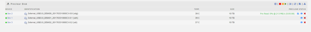

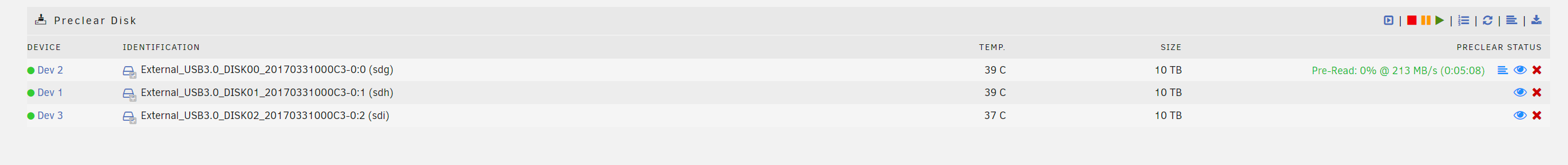

  10. I attached an image, but have 3 disks connected via an external JBOD enclosure, and they all seem to have the same identification number, serial for all is (20170331000C3). This means I cannot start multiple concurrent preclears, as it seems to think all are active when I start on a single disk. Any ideas on ways to get around this?
