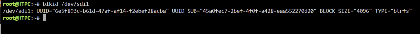

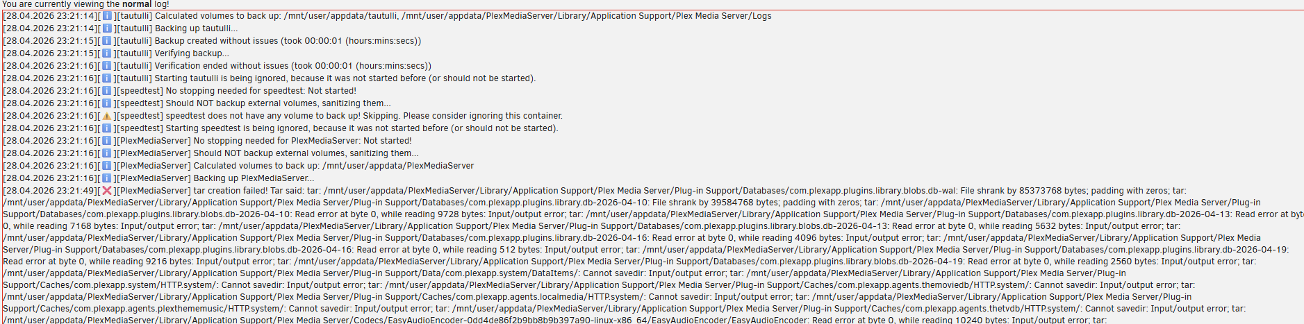

  5. @JorgeB Unfortunately, it looks like I was celebrating a bit too early. The cache drive appears to still be causing some problems after the last steps fixed the unmountable drive issue. The Cache drive is indeed recognized as a mountable drive now. I started the Docker service, and the dockers did all come back in the Docker tab. Just after that, I went to plex to see if media was accessible. Some did load in the media library menu, but none would actually initiate. I then tried to access other dockers through their ip web GUIs and none would load. I decided that before I dig the hole deeper and mess something up even more, I took your advice to install the Appdata Backup plugin and tried to manually run it. The backup failed twice, where a couple of dockers' appdata did get backed up successfully, but several other important dockers failed. The log shows walls of tar errors, like this: Currently, all dockers are stopped, array is started, and I haven't done anything else (not even reboot) for fear of creating more errors. I'd greatly appreciate your help while I continue troubleshooting this!
  6. IT WORKED!!!!! YOU ARE A GENIUS!!! THANK YOU SOO MUCH!! For the record and future reference: Yes, blkid /dev/sdi1 did show the following now: With the array stopped, I reimported and remounted the cache pool exactly as described, and started the array. The cache drive mounted! Then I re-enabled Docker in settings and it all came back to life! I can't thank you enough, @JorgeB !! NOW, how do i prevent this from happening again? I think i am at my disk limit so i need to remove a data disk and rebalance before adding another drive for a 2 drive cache pool. I can do that if that is the recommended next step. Also , what is the best way to have automatic backups of cache and appdata? I'm so grateful that this is such a supportive community. Thanks again!

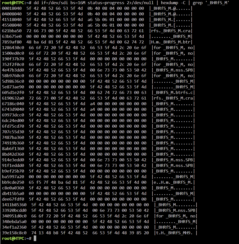

  11. I usually access the server by local IP from a browser my laptop, then click the command line button from the GUI, which pops open a floating window. I can do it directly from the server though if that is preferable
  12. @JorgeB I ran the command above. It started running, printing a new line every couple of minutes. Unfortunately, when I came back, a few minutes later, the terminal window had closed by itself (which has happened a few times before). Would it be detrimental to rerun that same command so i can post the output? Or should i pull some log that could show you the output? Any way I can prevent that from happening again?
