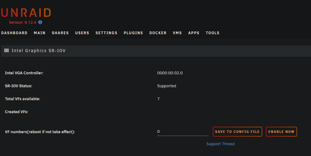

  10. First of all, huge thank you to @zhtengw for the plugin and to @ich777 for all of the assistance in this thread. I'm brand new to Unraid and trying to set up SR-IOV to use for a combined VM / transcoding setup. This thread has been incredibly helpful in understanding what's going on and troubleshooting through each of the obstacles I've encountered. Thank you both! The issue I'm running into is simply that the plugin doesn't seem to accept my configuration changes or actually setup any virtual functions. With all of the instructions up to this point, I've been able to install it (running Unraid 6.12.4) and have it recognize that my CPU supports SR-IOV. But when I set the VF number, nothing seems to happen regardless of which button I hit, both "Save to Config File" and "Enable Now". I've tried rebooting after making the configuration changes, but once the system is back up, the settings page for the plugin is back to default values: 7 available, none created, number of VF's set to 0: I've tried only clicking one button (trying with both), and clicking them both in different orders. Nothing seems to help. Is there something else that I'm missing?
