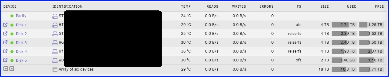

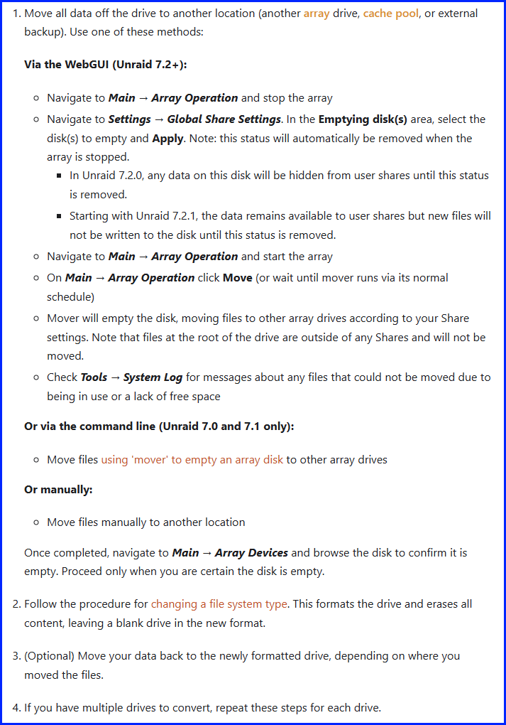

  7. JP posted a topic in General Support
    I've tried to wrap my head around doing this a couple times now and I never seem to get a full understanding enough to be confident to move forward. I just upgraded UNRAID to 7.2.2 and I got the banner letting me know how urgent it is to upgrade the format on my RESERFS drives to something like XFS. So, I really need to force myself to do it now. I think the good news is, Unraid appears to now have something built-in that appears to make this conversion easier (or at least I think so). The MIGRATION GUIDE it points to seems a little more straight forward than the directions I was attempting to understand in the past. My first question is, "Can I follow this migration guide given the limited amount of space I have on my Unraid Server? Here is a screenshot of the space I have available: I do have an extra 4TB drive available. Should I maybe switch it out with the 2TB drive first to give me more space? The migration guide is as follows. If I do have enough space and can follow these steps, can I really not do step 3 and just leave the files where they are once I've completed the format change on all 3 drives? Thank you for any help. tower-diagnostics-20251212-1327.zip

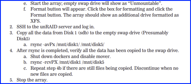

  8. JP replied to JP's topic in General Support
    Thank you. I've added those steps to the instructions. Is it possible to comment on the rest of the instructions? I know there might be different ways of accomplishing this, but I'm most interested in, "Will this work?" As always, thank you for your help. Converting REISERFS to XFS (5).pdf

  12. JP posted a topic in General Support
    I've been reading quite a bit on this forum to try and understand how to do this conversion. Much of it is over my head, but I think I've gotten the gist and the steps I need to walk through to get this done. Could someone please take a look at the attached and see if I have any glaring mistakes and whether this process will work or not? I recognize that there might be other ways to do this, but I'm mostly interested in whether this will work or not since it is something that makes some sense to me. Thanks in advance for any guidance. Converting REISERFS to XFS (4) (2).pdf
