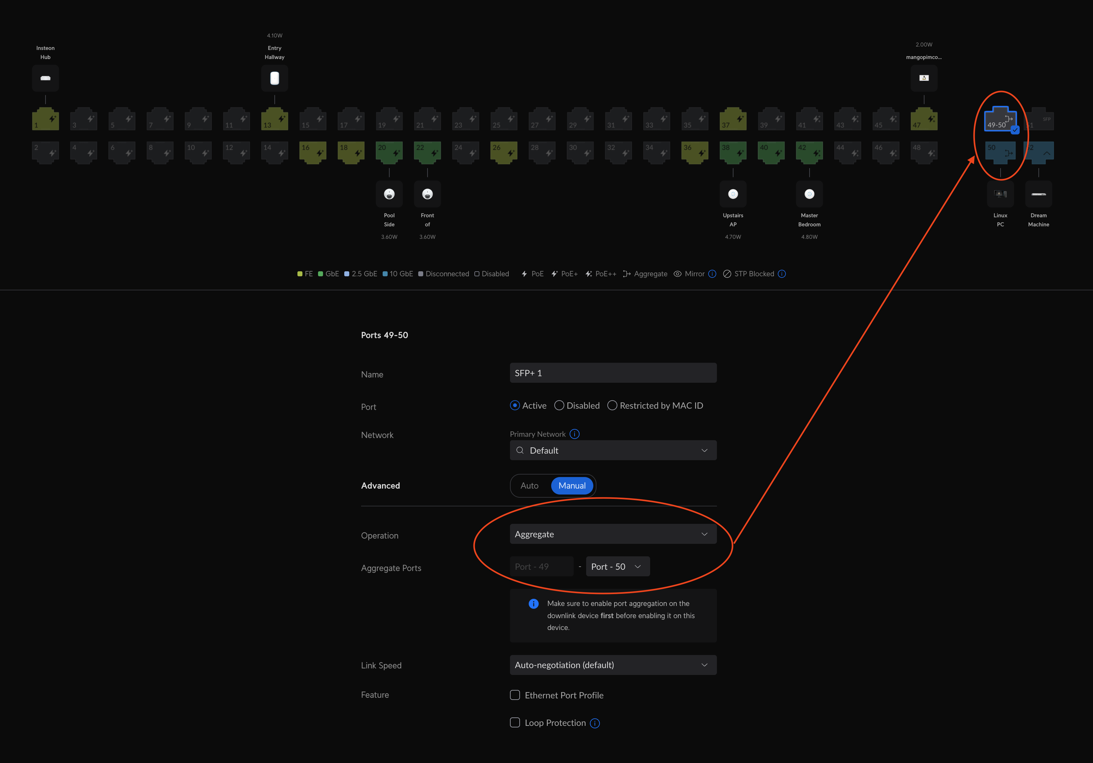

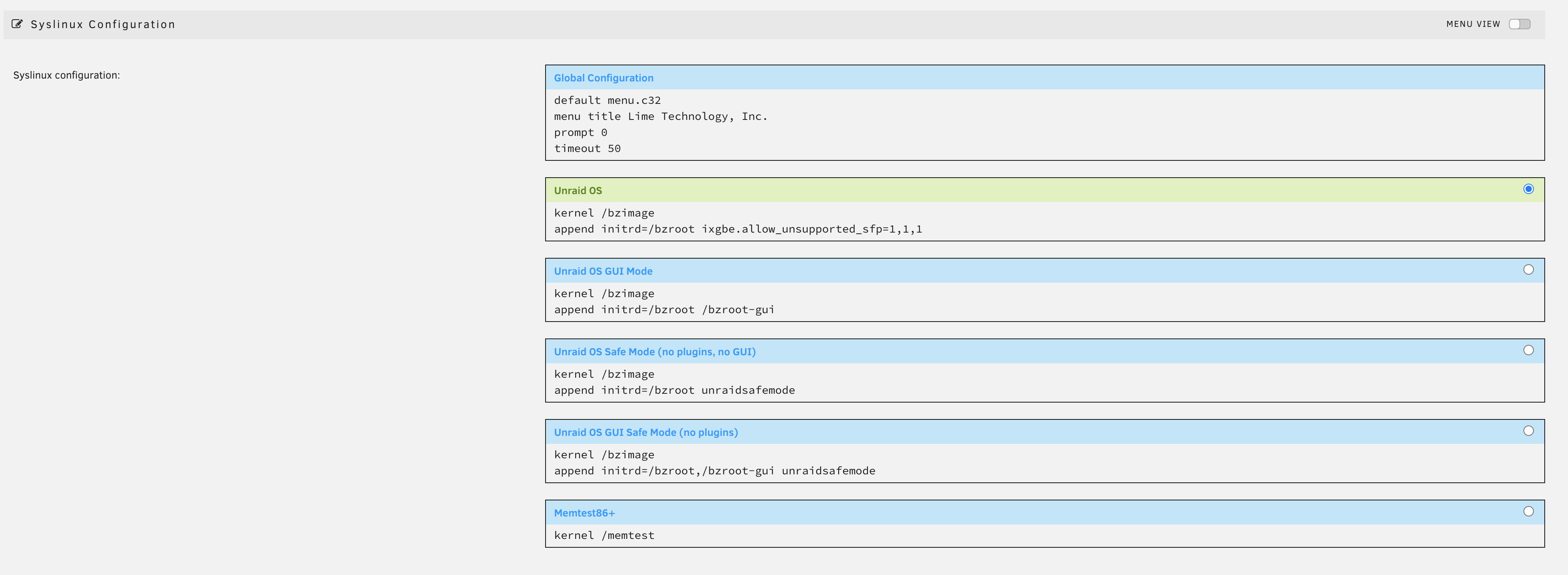

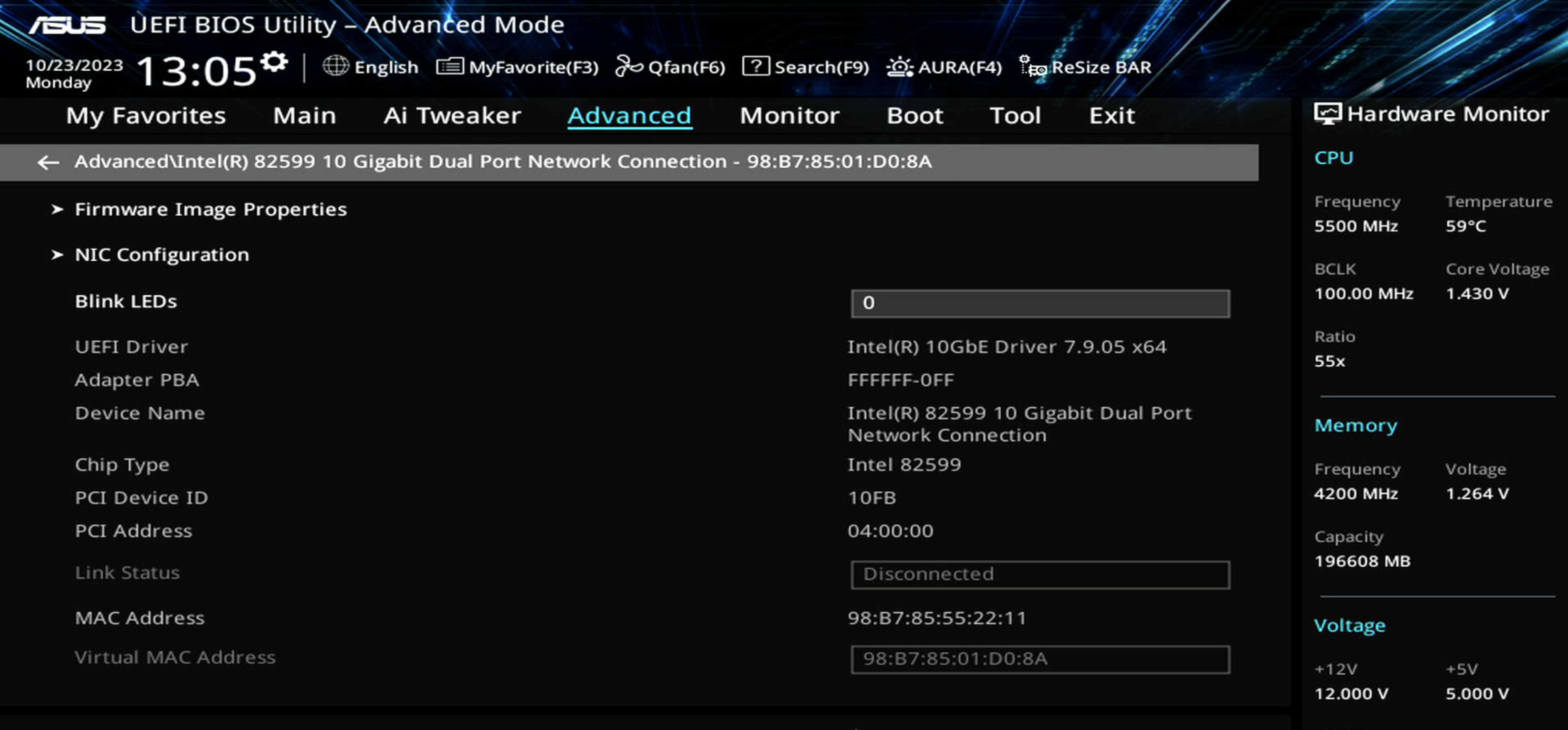

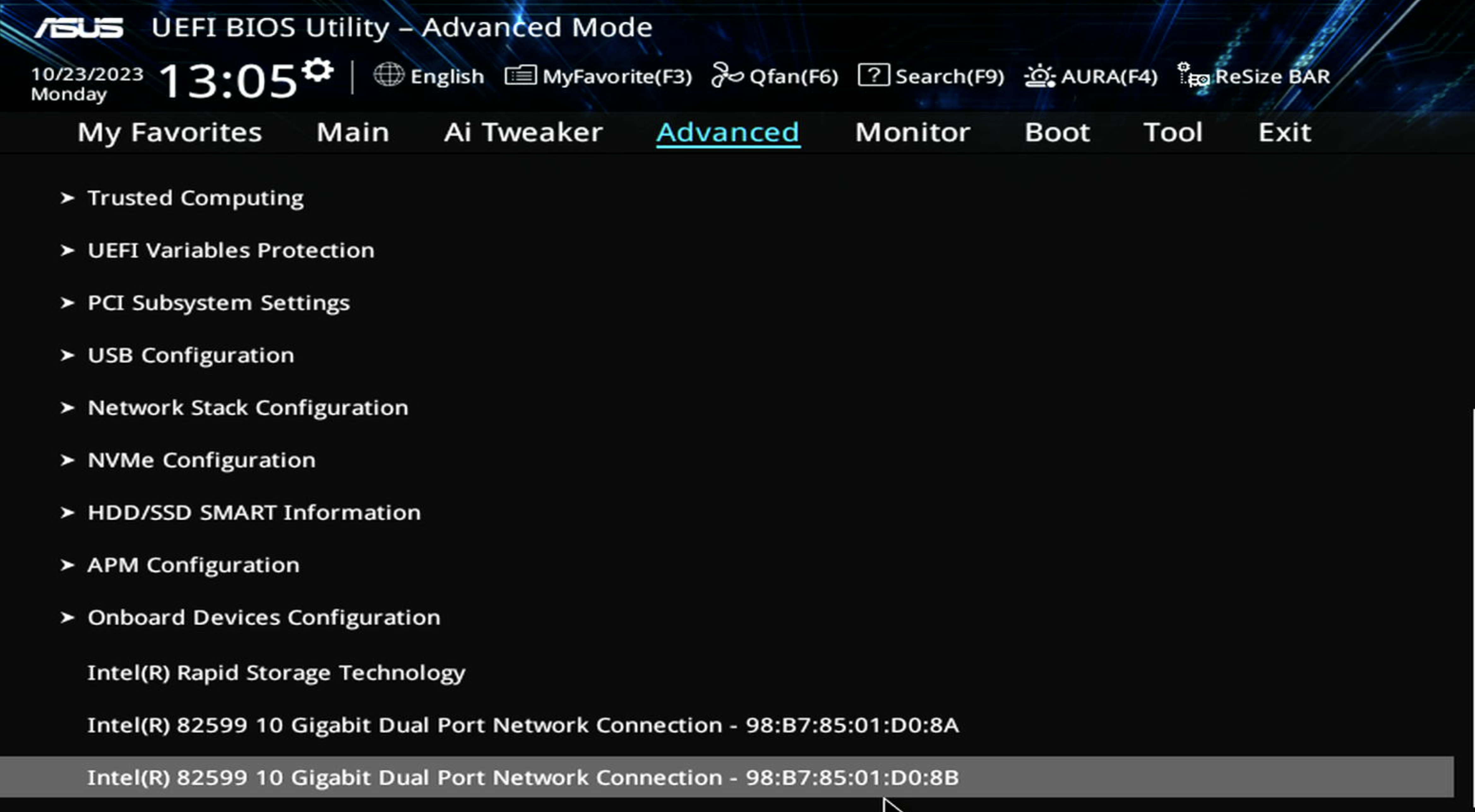

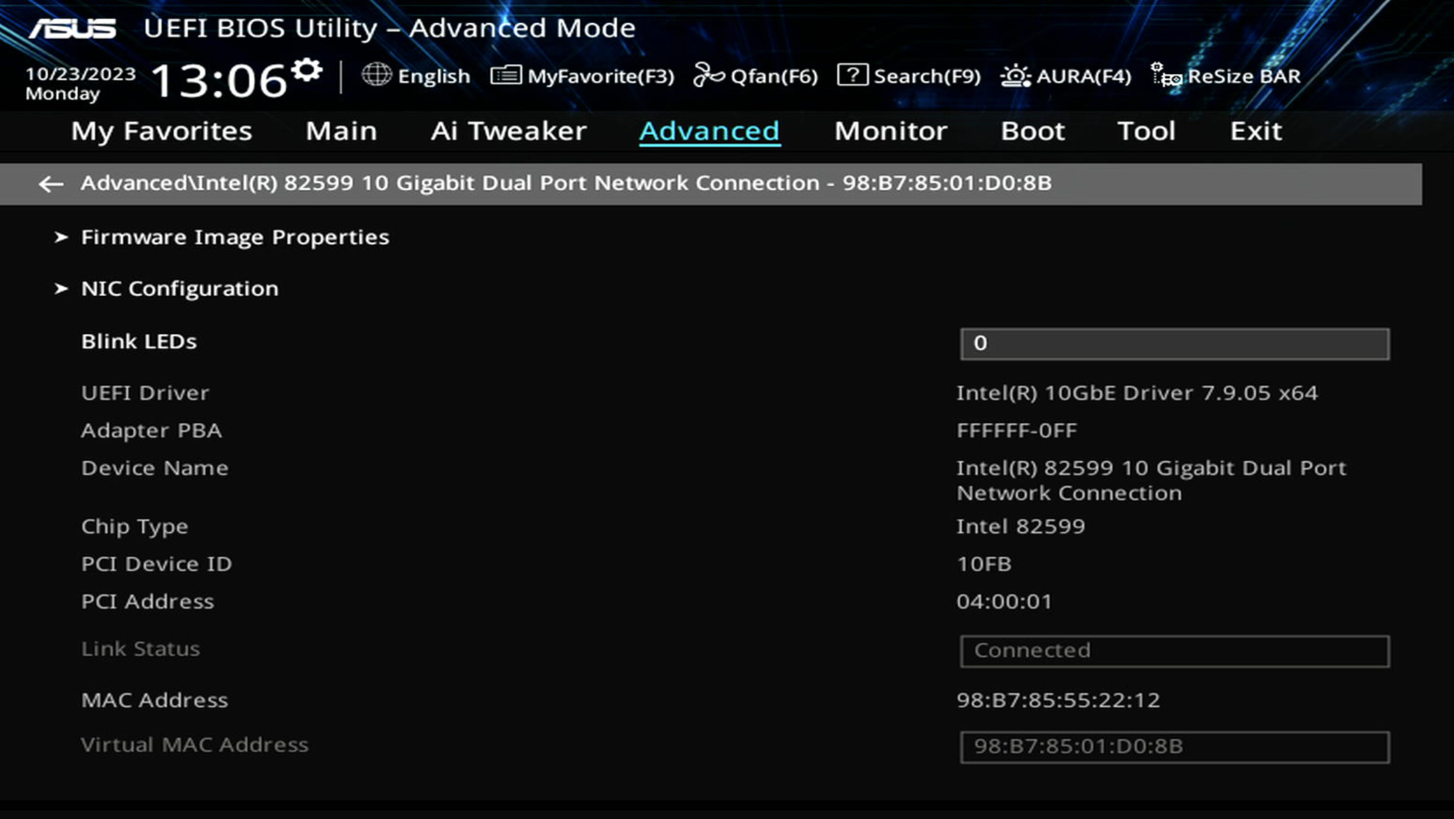

  3. I'm having some issues with this Intel X520-DA2 network adapter. I'm using this 10G SFP+ DAC Cable to connect to a Unifi Pro 48 POE switch. The network adapter has 2 SFP+ ports. With the assignment of the NIC names, eth2 is the only port that is making a link. eth1 always remains down. I've switched the cables between between the ports. I've also tried remapping the physical connection between the NIC ports and the switch ports. But it is always only eth2 that is able to make a link. At this point, I'm just trying to make sure this isn't a software induced bug. I thought this might be a problem with incompatibility between the network adapter and the SFP module. But with both SFP cable set working against eth2, I have ruled out this being a SFP module/cable issue. The setup is currently using network aggregation. I've also tried active/passive with the same result. I did not see any errors in `dmesg` other than eth1 not making a link. The motherboard also comes with in integrated 1G ethernet port. I've disabled that NIC to simplify the problem space. Bios Configurations Syslinux Configurations Unifi Configurations for Aggregation When the port is linked, the color for it is filled in. Port 49 is hollow meaning eth1 hasn't linked. hermes-diagnostics-20231023-0811.zip
