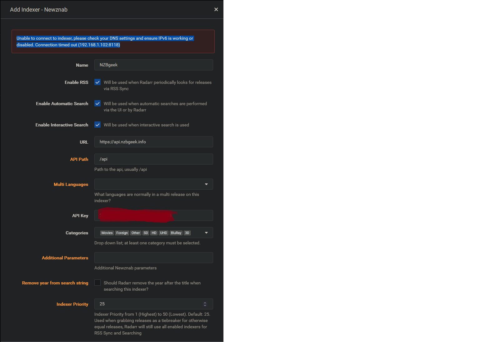

  8. **Ignore the below, the Radarr issue was a misconfiguration. Now I just need to work through why Radarr and Overseerr are not on speaking terms.** Hi all, hope everyone is doing well. If you would, please help make Radarr behave. Radarr has suddenly stopped talking to my indexer. Sonarr is working perfectly using the same indexer. I have uninstalled and reinstalled Radarr/renewed my indexer API/removed Indexer from Radarr settings but now cannot re-add due to error - (Unable to connect to indexer, please check your DNS settings and ensure IPv6 is working or disabled. Connection timed out (server ip address:8118). It should be noted that I use Wireguard via binhex-delugevpn and route all of my 'arr containers through that. They are all happy except for Radarr which gets the correct public IP and I can ping all but two default DNS servers from console. Other users have seen this error message and they were able to resolve by changing the NAME_SERVERS variable in the binhex-delugevpn container configs. I tried their recommendations, removing the default entries and to use only google (8.8.8.8,8.8.4.4) and then only cloudfare (1.1.1.1,1.0.0.1). I have tried keeping all of the default dns entries and only removing the two that do not respond to ping. In any case, any change to DNS breaks deluge which in turn breaks the other containers that run through it. Changing DNS also ghosts the NZBGET container forcing me to stop all containers and remove/re-install NZBGET. If i then revert back to the default dns entries in deluge and restart everything. All are happy except Radarr and I am back to the original issue of not being able to add my indexer back into Radarr. And I'm out of ideas short of trying a different container which seems like it could be tricky. Apologies for the word salad, hopefully that all makes sense. Any advice or tips would be greatly appreciated. radarr-logs.txt
