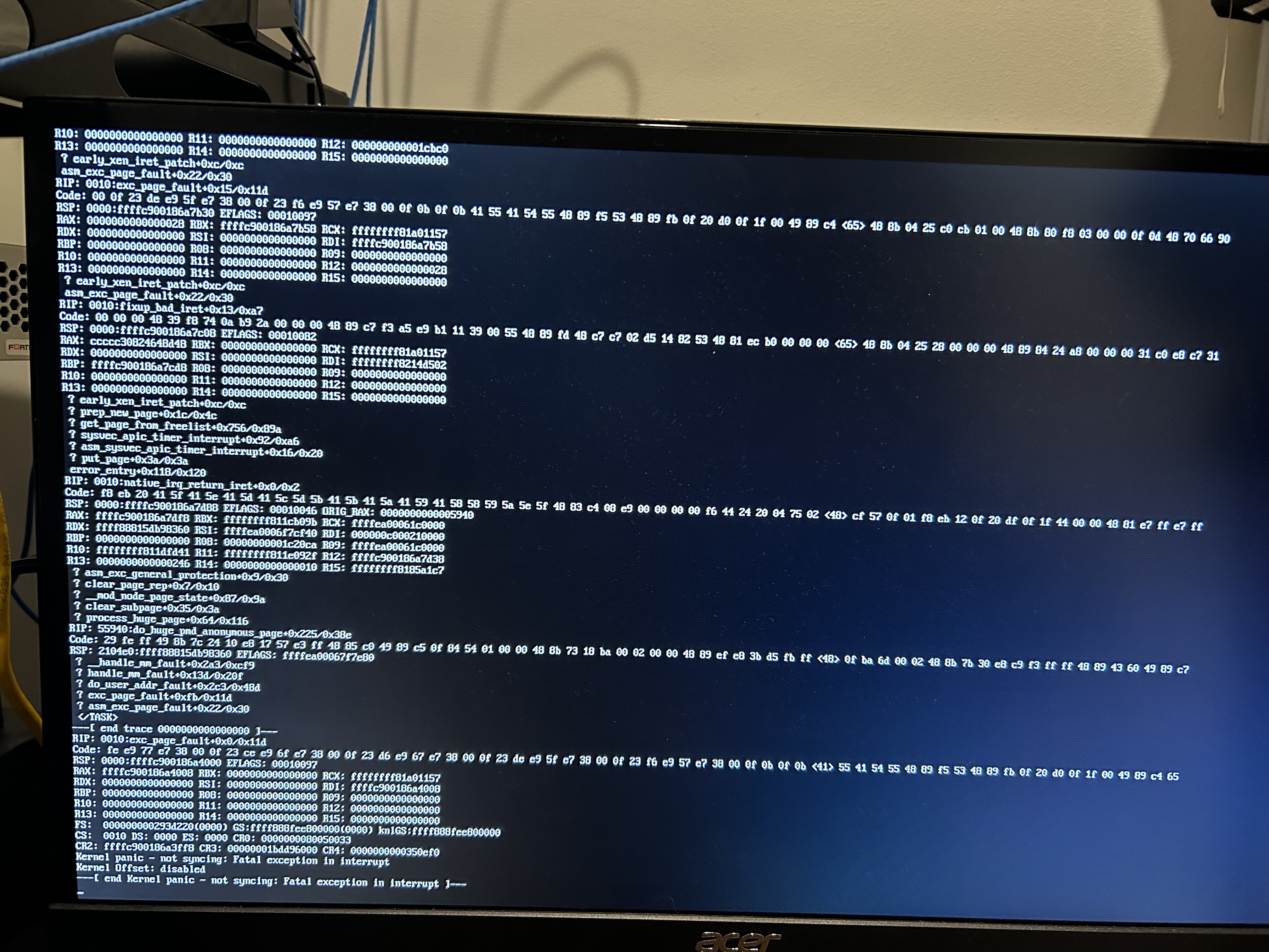

Had another crash. New screenshot and logs. It ran fine in safe mode for ~9hrs today. After it completed parity, I rebooted normally and within about an hour, it crashed. So I guess I will remove all plugins and reboot. Then re-add one at a time until it crashes. Unless anyone can see something here that points to another culprit.

Just realized I attached the incorrect screenshot. Apologies. Below is the correct one.IMG_0257.thumb.jpg.58d5c9a1f908c6d558c57caffe9904a2.jpg
And here is a screen grab from today’s kernel panic.

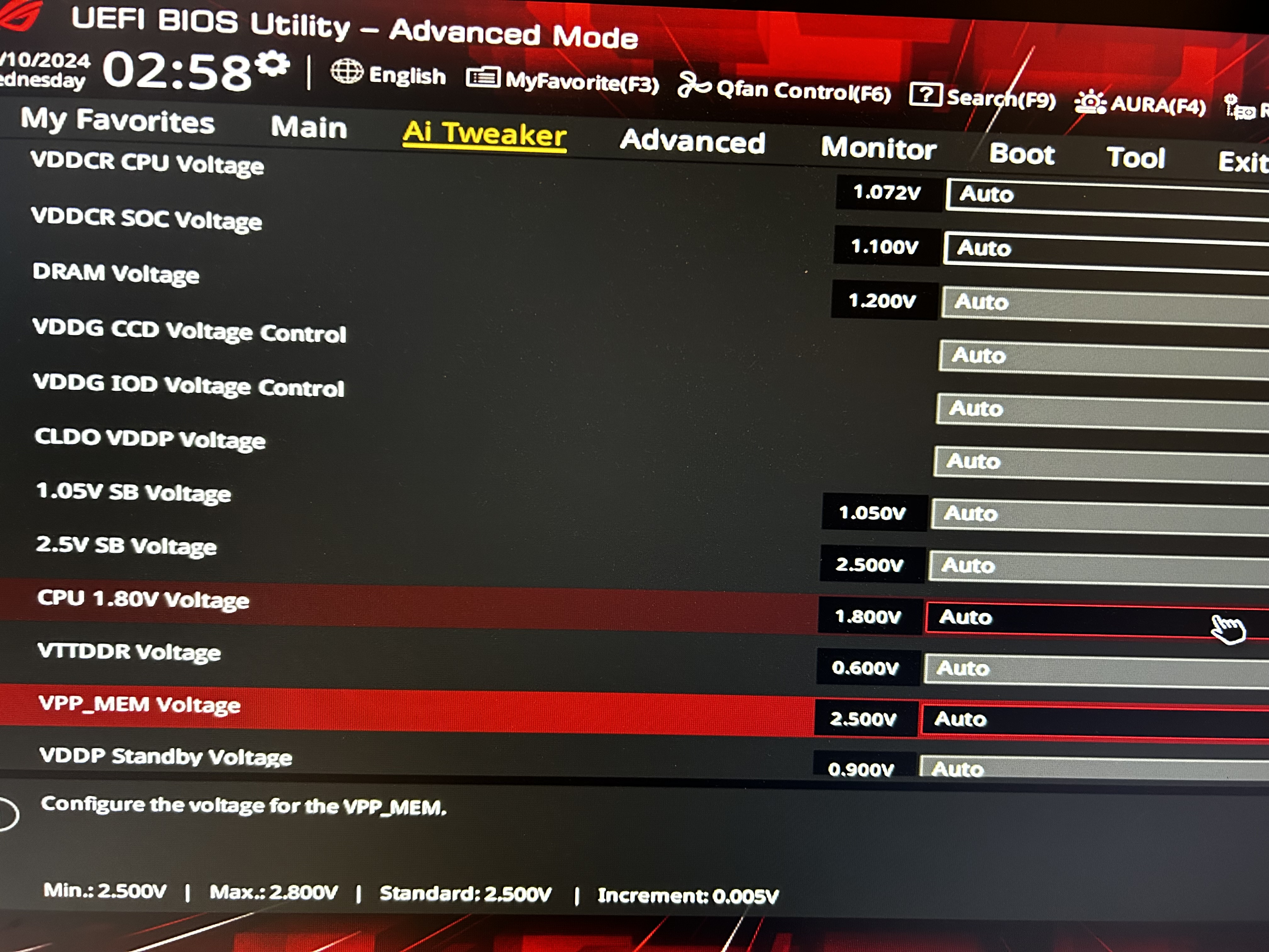

Regarding the BIOS settings. I just now manually configured memory speed to be 3200MT/s and flck speed to be 1600MT/s per the recommendations I could find. Other than that, see attached for what I could find on voltages. I'm guessing you are referring to DRAM voltage which is set to Auto. Should I manually change that to something else?
I didn't post my system specs, my fault. XMP is intel. AMD calls that DOCP and that setting is not enabled. It is set to Auto as well. Options are Auto/Manual/DOCP.
I will simple clock down to 2400MT/s, this is a quick way to remove memory problem then 2 passed and going further troubleshoot, you can set back to auto or 3200MT/s later if you confirm problem not come from memory. Not suggest manual set the voltage. I never found a mobo will use 3200MT/s but config in 1.2v instead standard 1.35v.

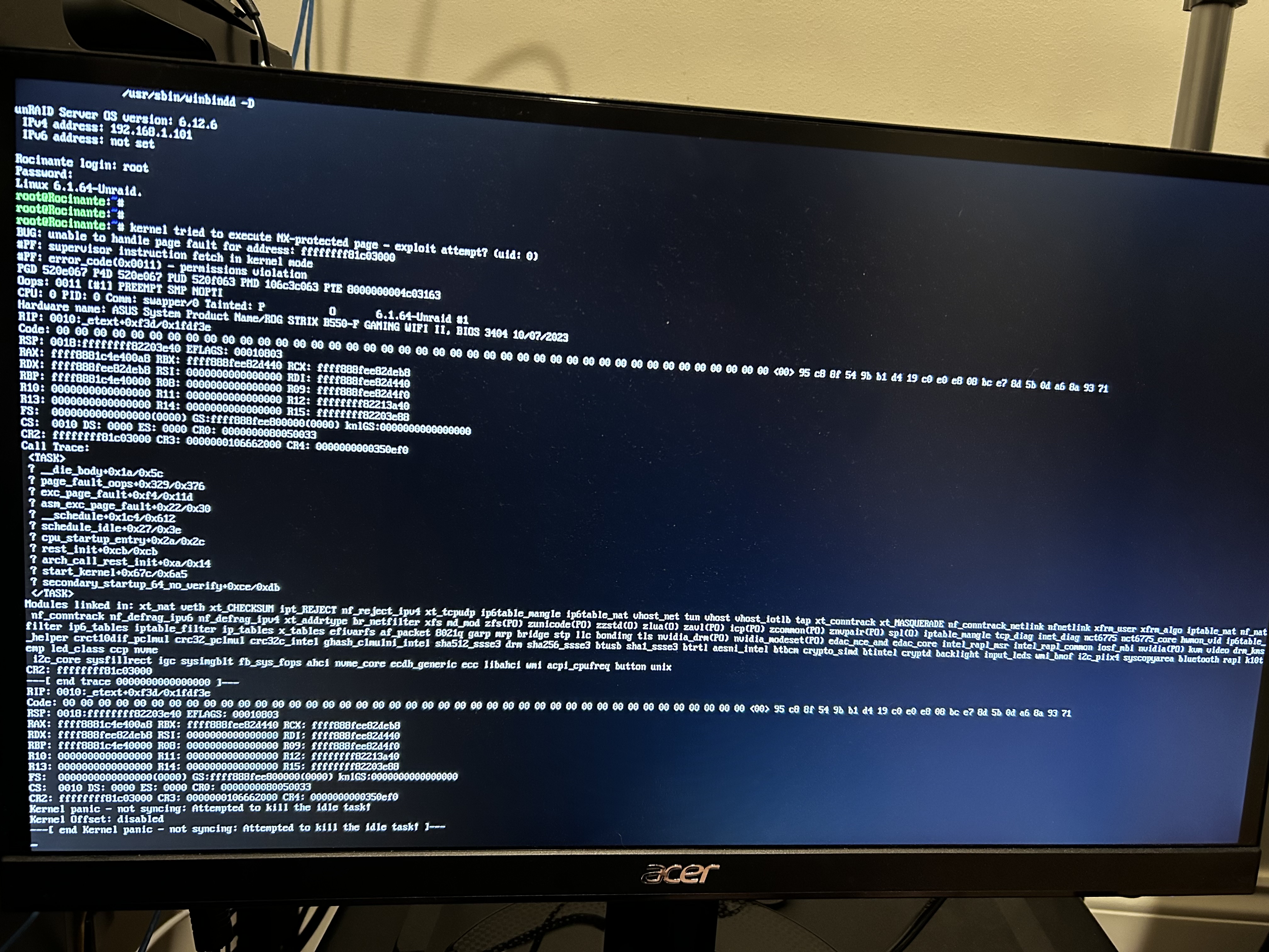

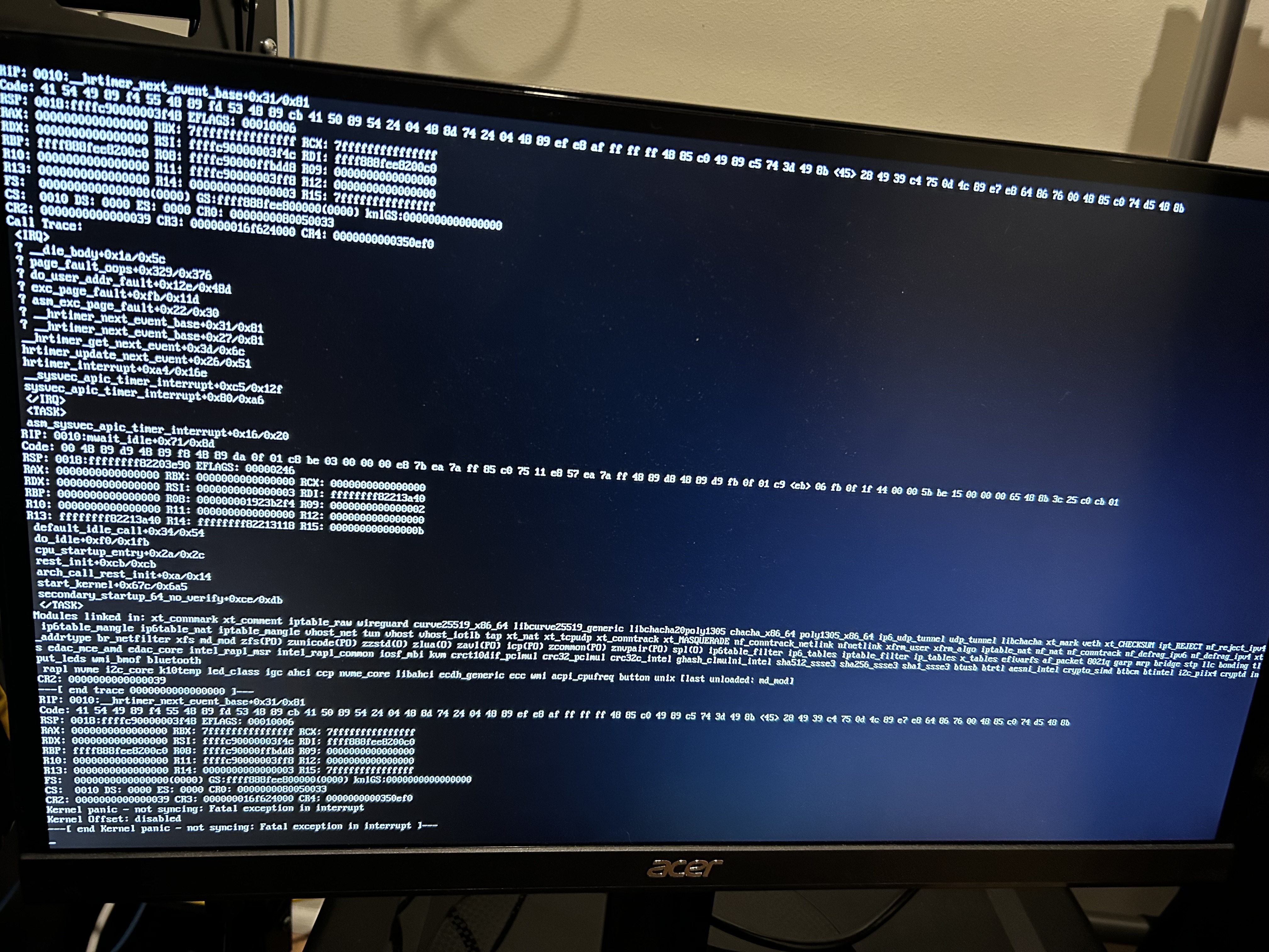

Crashed again about 10 minutes ago. Here is the screen shot of kernel panic, logs and diags. Can anyone see anything relevant or do I have a hardware issue? Community Applications was the only plugin and Plex the only Docker running.

Looks more hardware related to me, one thing you can try is to boot the server in safe mode with all docker/VMs disabled, let it run as a basic NAS for a few days, if it still crashes it's likely a hardware problem, if it doesn't start turning on the other services one by one.
