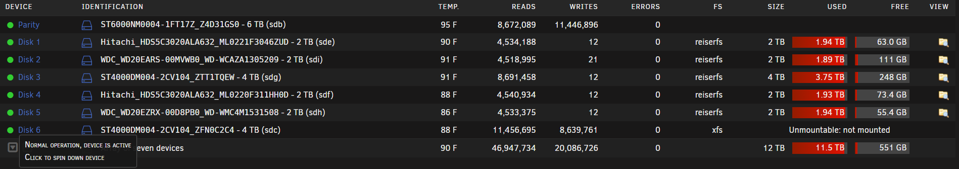

Hello! I'm having some issues, here's the quick summary: A 4TB drive in my array failed (Disk 6 in my array) I decided to replace this with a 6TB drive. This was larger than my parity, so I did a Parity Swap, as outlined here Once it completed, I started the array, which also initiated a Data-Rebuild Parity sync / Data rebuild finished My array is running. Both the Parity Drive & Disk 6 have green balls have next to them. The new 6TB is now the Parity, and the old Parity is now Disk 6. If I hover over the green ball next to Disk 6, it says "Normal operation, disk is active" However, on the right, Disk 6 says "Unmountable: not mounted" This is where I'm currently at. I'm a little confused, because Disk 6 doesn't say it's emulated, but it also says it's not mounted. Did it delete the data in the Data-Rebuild? What exactly is going on here? I'm also confused about how best to proceed. My ultimate goal is to replace Disk 6 with a second 6TB drive I have. Can I just remove Disk 6 at this point and add it in, and initiate another Data Rebuild? Or do I need to get the array back into a fully functional state with the current drives first? Thanks for any advice. Diagnostics are attached. unraid-diagnostics-20231206-2352.zip
