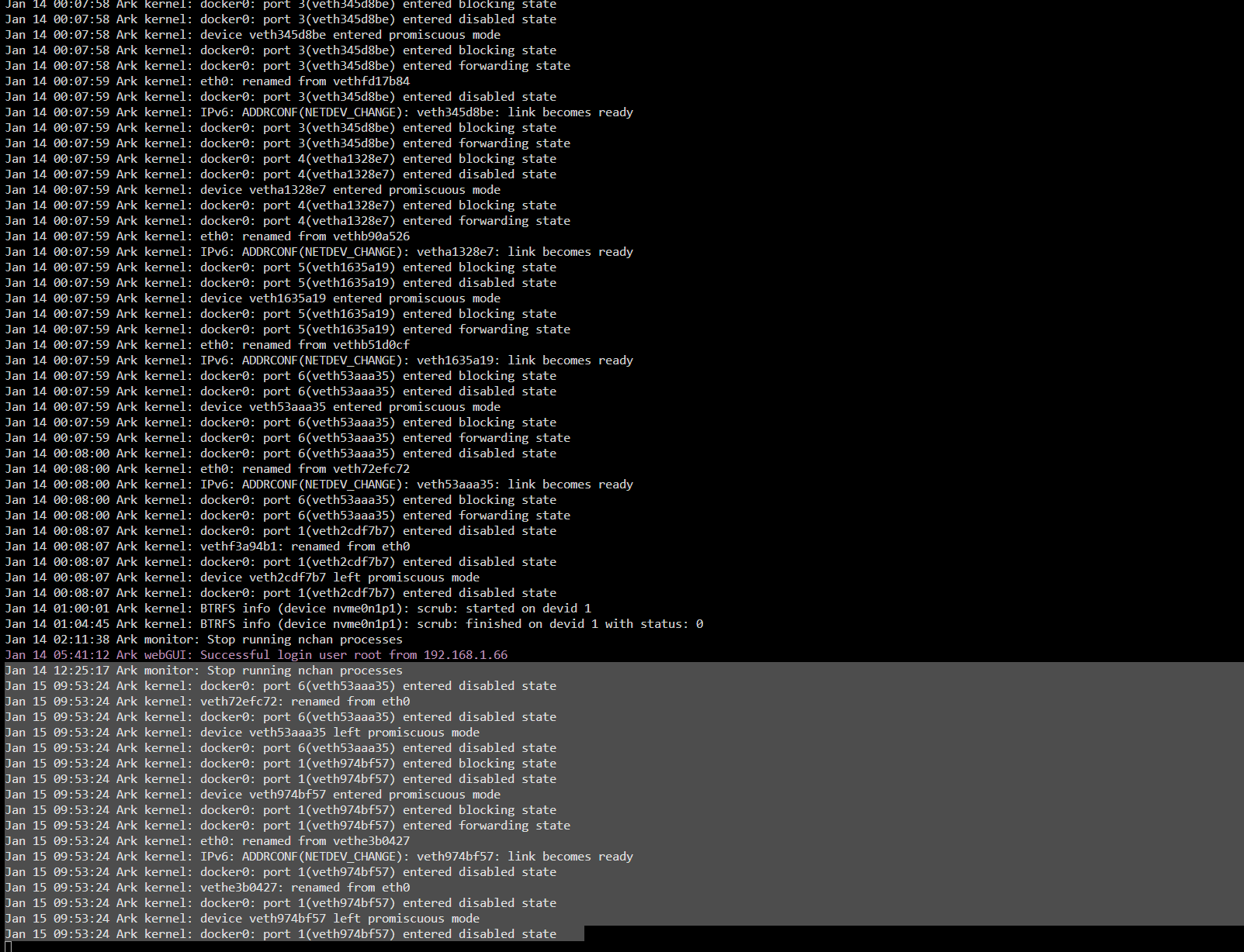

  4. I am currently on Unraid 7.0. I have attached my diagnostics. Not to sure what the issue is. I just switched things back to my intel chip for transcoding for the time being. ark-diagnostics-20250111-2207.zip

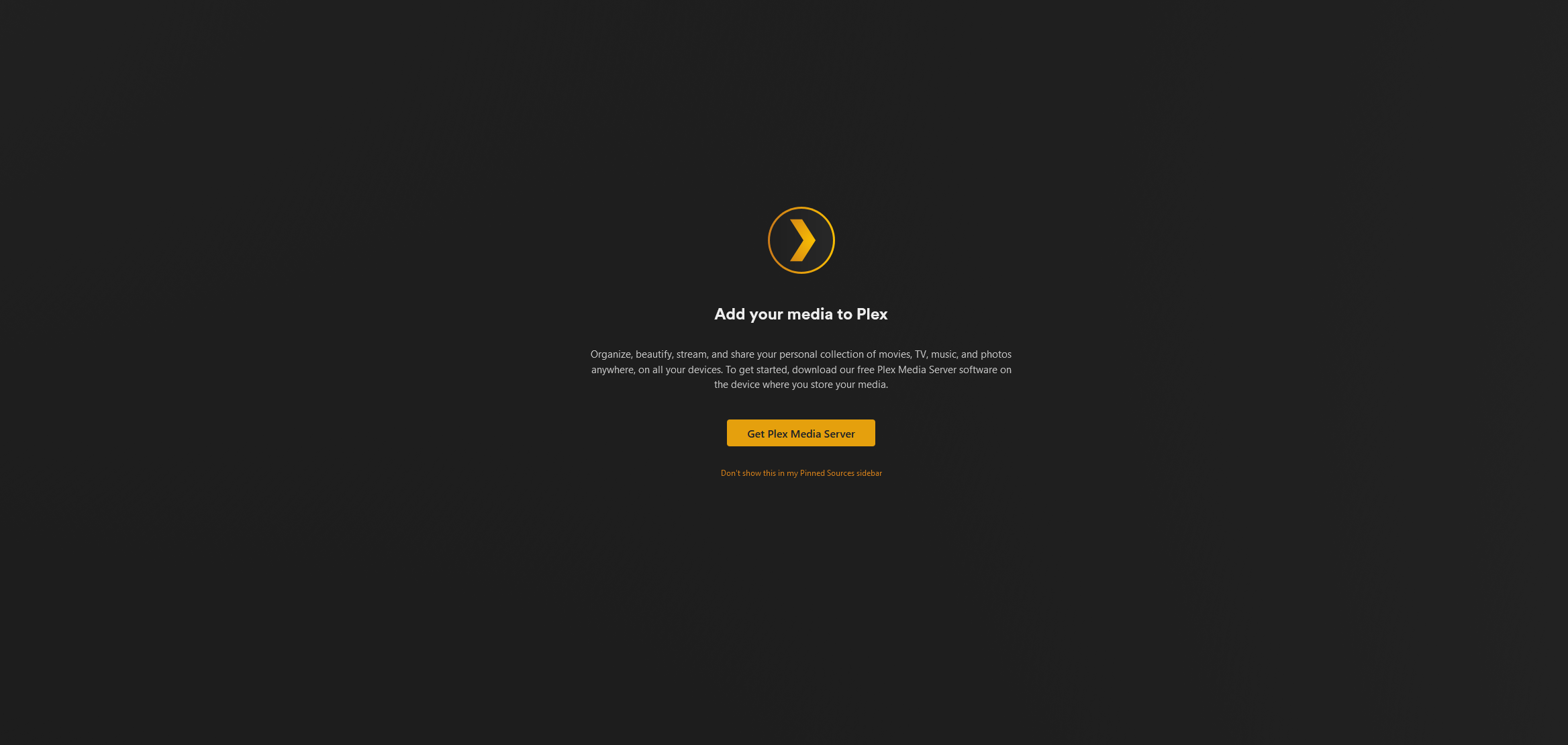

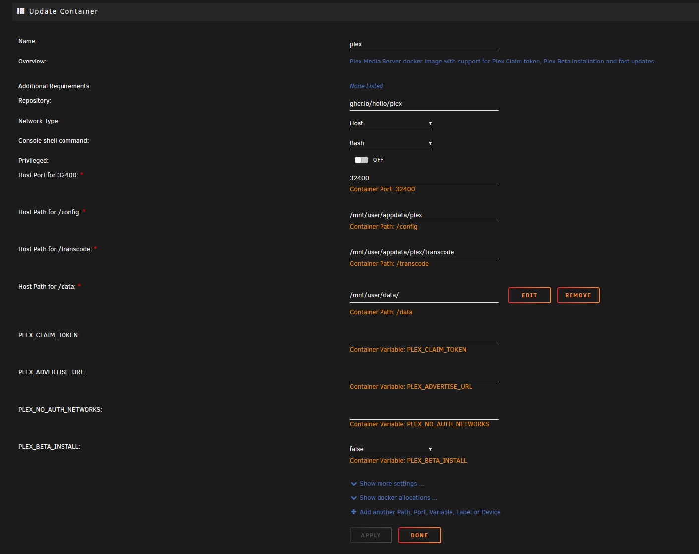

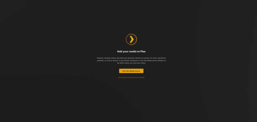

  7. Hi everyone, I recently completed a hardware upgrade, but ever since, my Plex Docker container seems to have lost access to my media files. When I log into the Plex web UI, I’m greeted with the message that Plex can’t find my media libraries. I’ve tried the following steps to resolve the issue: Reinstalling the Plex container. Verifying media paths in the container configuration. Unfortunately, the problem persists. It seems like Plex is either unable to see the media directory or there’s some other issue at play. Has anyone encountered a similar issue or have any suggestions on how to resolve this? Any help would be greatly appreciated. Thanks in advance! Plex Logs .txt

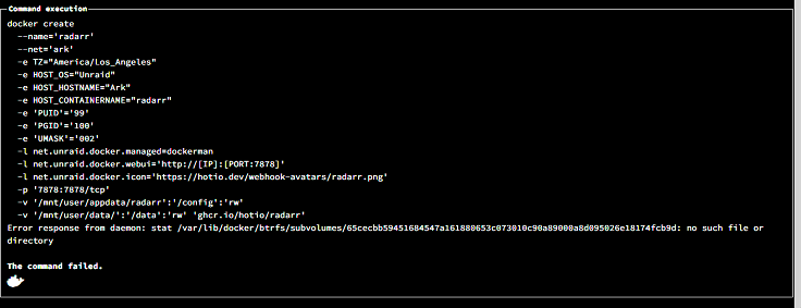

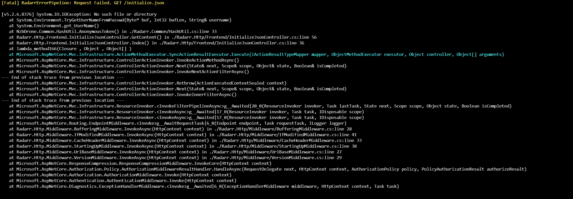

  8. When i look in my port mappings is docker i don't see any applications using the same port. Are you able to explain where you see that? Apologies if that's a stupid question. Really appreciate your help! The Radarr docker failed now and i cant reinstall as i get this error.

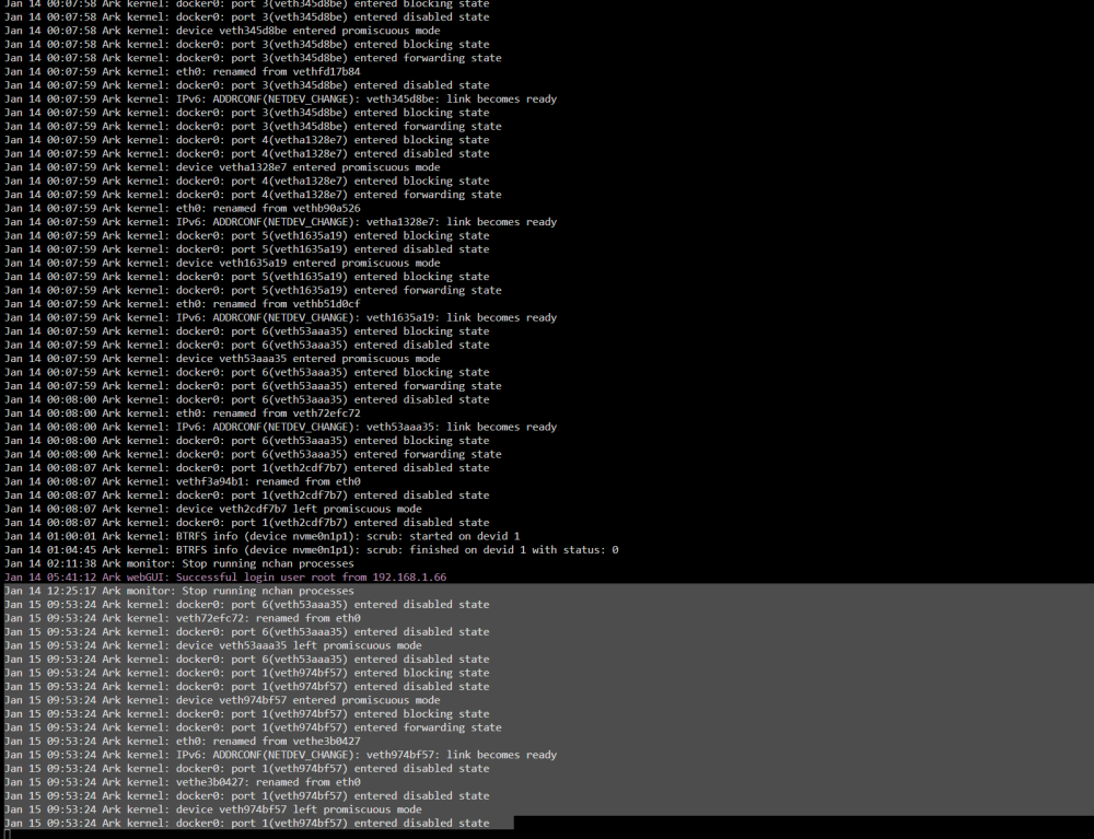

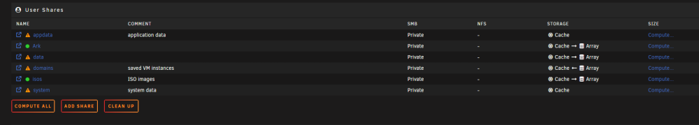

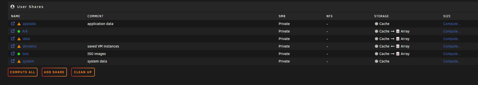

  9. I was wondering if anyone would be able to help me figure out what is causing the errors in my docker apps. I have posted the logs from my dashboard as well as the logs from Radarr. I cant seem to get them to work longer then a week before having to wipe all my app data and dockers and reinstall. I will admit i am brand new to Unraid and having allot of fun learning how it all works but this one has me stumped. Any help would be greatly appreciated. Shares Radarr Log Dashboard Log
