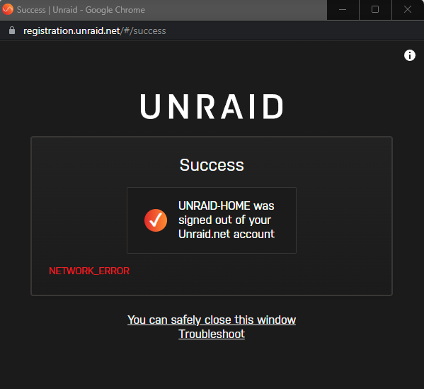

January 30, 20233 yr Hi since days I try to get rid of this issue. It was once running. Not sure what change created the issue Dashboard messages: My ServersBETA UNRAID-HOME Unraid API Error NETWORK_ERROR UNRAID-HONE not connected to mothership unraid-api report -v SERVER_NAME: UNRAID-HOME ENVIRONMENT: production UNRAID_VERSION: 6.11.5 UNRAID_API_VERSION: 2.55.1 UNRAID_API_STATUS: running API_KEY: NETWORK_ERROR MY_SERVERS: authenticated MY_SERVERS_USERNAME: MxxxxCH CLOUD: STATUS: [error] ERROR [Unable to connect to https://mothership.unraid.net] MINI-GRAPH: STATUS: [DISCONNECTED] SERVERS: ONLINE: OFFLINE: ALLOWED_ORIGINS: http://localhost, https://localhost, http://unraid-home.local, http://IPV4ADDRESS, http://unraid-home </----UNRAID-API-REPORT-----> Every hint will be very much appreciated unraid-home-diagnostics-20230130-2007.zip Edited January 30, 20233 yr by MediaproducerCH
